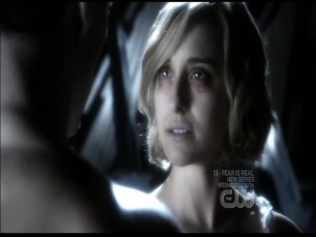

I'm not 100% certain but, here goes....My understanding is that whether you will see a widescren picture depends on the tv you're watching the Panny on. If you watching the Panny recording on a regular 4:8 tv, and record a local digital channel oon a dvd-r or rw, you will see the slightly squished like this..
If you watch that same dvd-r/rw on a 16:9 display, the tv will strech the image to widescreen like this..
The first image is how a recording looks on my 4:8 tv, while the second is how it looks on a widescreen tv. So you can record a widescreen image, but if you lend the disc to a friend with regular tv, the video with appear squished in a box.
These 2 screencaps are from Smallville, recorded to a dvd-rw on a Pan EZ48. I used a dvd authoring software program to capture the first in 4:8, then reset to output 16:9, which is what I do to preserve WS format when making a dvd.
You may need to go into the Setup menu to set the EA to display 16:9, under TV Screen>TV Type" 16:8.
