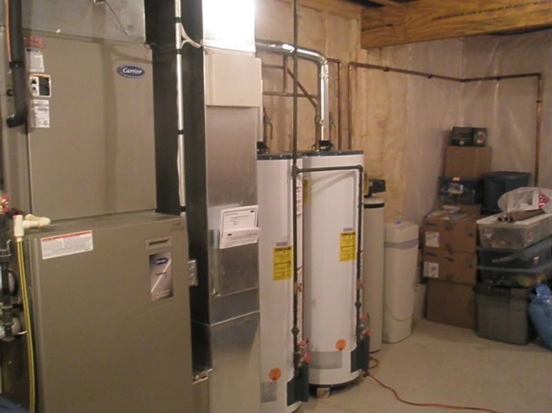

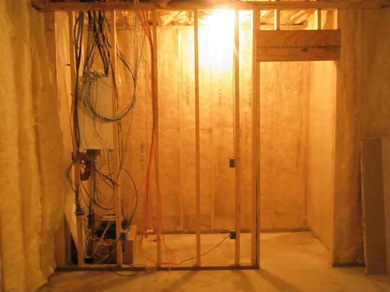

Here are some pics of the space
Equipment room- big mess right now but will be moved to the room's back false wall.
