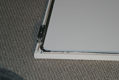

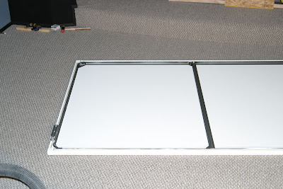

Others, check out Itai's picasa link, he did a really neat AT screen that flips open for access to speakers.
Itai, you did explain your screen "flipping up garage door method" to me, I remember that now. Very ingenious, sweet!
Below picts from Itai's build.

a few words about the pivot. first let me explain that my access to the back is narrow, about 1.5 feet wide. for me its a non issuem, but this space does not allow easy access to replace speakers. Also, my subs would never fit through this opening.
1. I connected an additional piece of aluminum tubing to the back of the frame about 6 inches long.
2. I drilled a hole in the metal and into the wood screen wall and inserted a smooth metal sleeve with a nice tight fit into the holes. this creates a smooth surface for the threaded rod and will not wear the wood.
3. cut metal threaded rod to size and inserted between frame and screen wall using lock nuts on both sides as well as washers for spacing.
4. there are 8 brackets connecting the screen frame to the wood opening. these must be undone first to open the screen. this allows for the screen to return in the the exact position.
If you need pics I can take a few as well. Lessons learned, this is an often overlooked part of the build, easy access to remove or replace parts. I am very happy with how it turned out and was cheap and simple. all materials except for the aluminum tubing came from HD.
Screen frame - in the pics you can see I used a dowel that created a nice snug fit (with the help of a rubber mallet) to secure the smx to the frame. I also folded the corners and used metal screws (with pilot holes of course) to secure the corners.

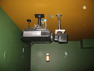

By the way, here is my temp "ghetto mount" of my Panamorph U380, seeing scope for 1st time was real neat:
