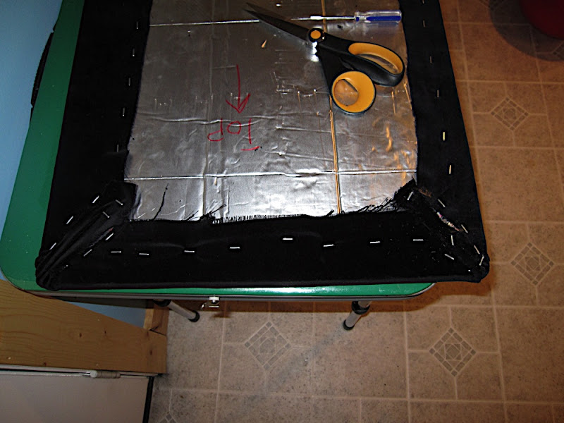

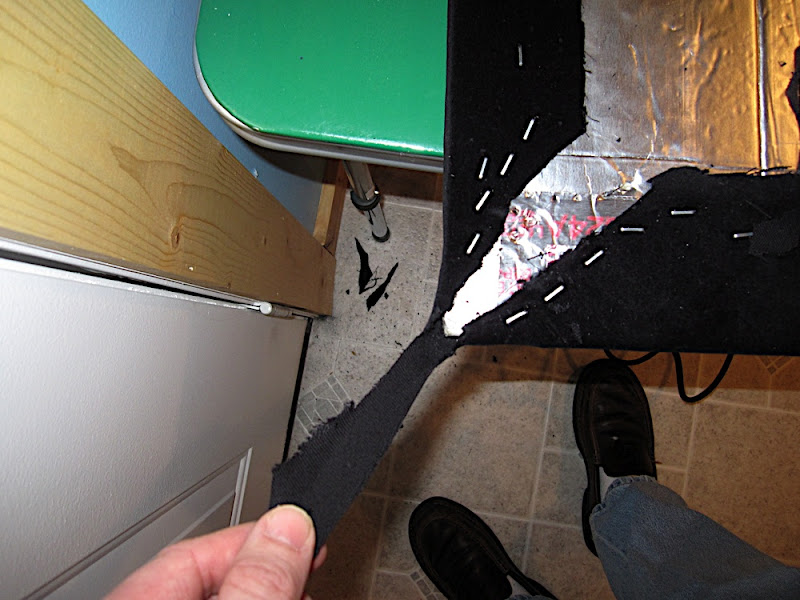

Masking tweak, or, when using magnets make sure your velvet backside is flat as possible.
The panels were holding "ok", but I felt those magnets should have more attraction.
I found out my velvet was bunched in the corners too much, holding the panel slightly away.
Spent 30-ish minutes re-doing 6 of 8 corners, I noticed the extra magnetic attraction when done.
Left side shows bunched up corner:
Re-done area prior to stapling.
Remove staples, trim excess away, re-staple wrap sides, pull corner "strap" taunt but not too tight, staple.
Again, the foil helps so much holding the staples.

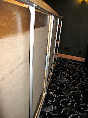

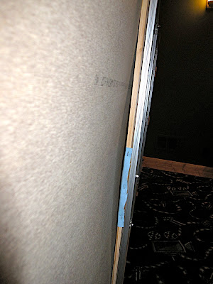

With the above in mind, I also will be tackling an issue that arose with my screen
My issue with current HT screen is I used pine baseboard to establish the curve, as shown in this build thread.
I’ve come to realize over seasonal humidity changes that is not desirable; the pine baseboard “grows” slightly (lengthwise) in high enough humidity. And, I have contact cement all around the perimeter of my laminate. Yet, the aluminum is rigid and very stable, So, recipe for some issue, something has gotta give.
I built my screen in the dry of late fall/early winter Nov-2008, last summer (July/August 2009) I noticed a slight buckle in my laminate screen at the center, very slight but there.
Here is a YouTube video showing the condition,
&fs=1" width="644" height="390">PG9iamVjdCB3aWR0aD0iNDI1IiBoZWlnaHQ9IjM0NCI+PHBhcmFtIG5hbWU9Im1vdmllIiB2YWx1ZT0iaHR0cDovL3d3dy55b3V0dWJlLmNvbS92L0VQTW5WM1BCRmlrJmFtcDtobD1lbl9VUyZhbXA7ZnM9MSZhbXA7Ij48L3BhcmFtPjxwYXJhbSBuYW1lPSJhbGxvd0Z1bGxTY3JlZW4iIHZhbHVlPSJ0cnVlIj48L3BhcmFtPjxwYXJhbSBuYW1lPSJhbGxvd3NjcmlwdGFjY2VzcyIgdmFsdWU9ImFsd2F5cyI+PC9wYXJhbT48ZW1iZWQgc3JjPSJodHRwOi8vd3d3LnlvdXR1YmUuY29tL3YvRVBNblYzUEJGaWsmYW1wO2hsPWVuX1VTJmFtcDtmcz0xJmFtcDsiIHR5cGU9ImFwcGxpY2F0aW9uL3gtc2hvY2t3YXZlLWZsYXNoIiBhbGxvd3NjcmlwdGFjY2Vzcz0iYWx3YXlzIiBhbGxvd2Z1bGxzY3JlZW49InRydWUiIHdpZHRoPSI0MjUiIGhlaWdodD0iMzQ0Ij48L2VtYmVkPjwvb2JqZWN0Pg==&fs=1" />[ATTN POSTER: YouTube Insert Error: Something went wrong. Please make sure you added the video correctly. Click here to see how YouTube videos should be embedded. There could also be a technical issue that's not your fault. Click PG9iamVjdCB3aWR0aD0iNDI1IiBoZWlnaHQ9IjM0NCI+PHBhcmFtIG5hbWU9Im1vdmllIiB2YWx1ZT0iaHR0cDovL3d3dy55b3V0dWJlLmNvbS92L0VQTW5WM1BCRmlrJmFtcDtobD1lbl9VUyZhbXA7ZnM9MSZhbXA7Ij48L3BhcmFtPjxwYXJhbSBuYW1lPSJhbGxvd0Z1bGxTY3JlZW4iIHZhbHVlPSJ0cnVlIj48L3BhcmFtPjxwYXJhbSBuYW1lPSJhbGxvd3NjcmlwdGFjY2VzcyIgdmFsdWU9ImFsd2F5cyI+PC9wYXJhbT48ZW1iZWQgc3JjPSJodHRwOi8vd3d3LnlvdXR1YmUuY29tL3YvRVBNblYzUEJGaWsmYW1wO2hsPWVuX1VTJmFtcDtmcz0xJmFtcDsiIHR5cGU9ImFwcGxpY2F0aW9uL3gtc2hvY2t3YXZlLWZsYXNoIiBhbGxvd3NjcmlwdGFjY2Vzcz0iYWx3YXlzIiBhbGxvd2Z1bGxzY3JlZW49InRydWUiIHdpZHRoPSI0MjUiIGhlaWdodD0iMzQ0Ij48L2VtYmVkPjwvb2JqZWN0Pg==" target="_blank">here to view the video on YouTube's site. If this link doesn't work, you did something wrong.]
You can sorta see the buckle here; the bluecloth is the mid support where the laminate material was forced to buckle upon humidity expansion of the perimeter pine boards. The buckle is about 1/2".
It actually came back to “normal” condition around November, so 3-4 months high humidity during summer.
Honestly, because I knew it, I could see it, but there were no defining lines (like a cloth material sag/etc), so it was NOT visible from seating or even relatively close with PJ on. If you looked at severe angle/sideways you could see it (w/o PJ on). But, still I want to fix it with correct countermeasure.
Larry ("LarryCheif") and I discussed this last summer, his screen is not attached to the laminate via contact cement, rather his laminate can float via his attachment method, so as his wood would grow slightly with humidity, his won't buckle.
If I lived in a stable humidity climate, either dry like AZ or even humid like near ocean would not have noticed this, but most portions of USA have humidity fluctuations that this will be issue.
Being an Engineer, I'm sharing this with people and at same time trying for better, robust solution that is easier for us DIY builders at same time.
