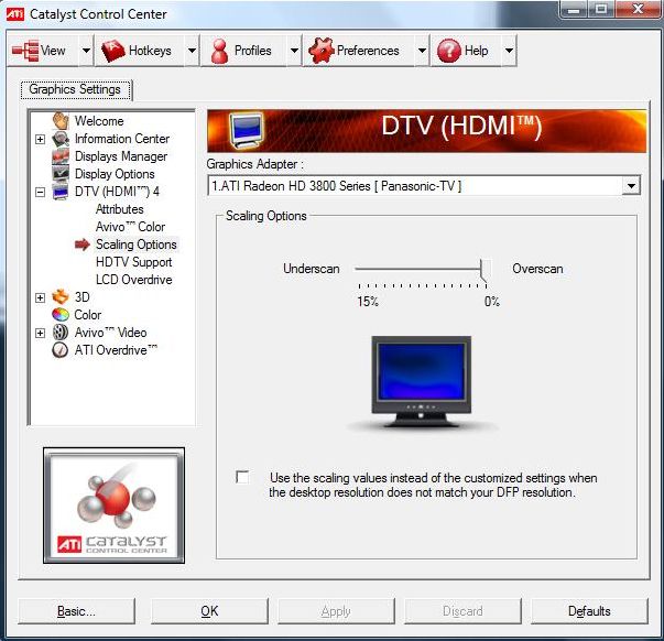

Originally Posted by kevinm207 View Post
I didn't see any setting in the CCC (Catalyst Control Center) about disabling overscan. Another thing that I pondered was whether I damaged my display; I originally had the video card set to 1440x900 (My LCD monitor's resolution), when I plugged it in. It displayed a picture (scaled), and then I was able to crank it up to 1920x1080. I restarted the PC and the TV a few times with no benefit. The black border remained.
[Edit: After reading the rest of the posts, I see that you already found this, but it might be useful to someone else.]
In CCC, go to the section shown in the following picture and move the slider all the way to the right. This should solve your problem when combined with having the TV in the correct mode.
