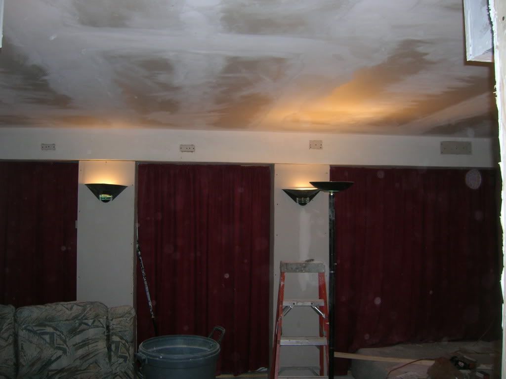

Not exactly sure which ceiling sanding I was on at this point... but also plugged old holes in soffit I had from something or other I did a long time ago... also, plugged the hole for the old A/C register I had stuck in here long ago. I stuffed as much insulation as I could get through those holes into the soffit 1st then cut pieces of plywood longer than the hole, put that inside the hole and screwed from the front, then screwed another piece of plywood to that only as big as the hole, and then attached a piece of drywall over that:

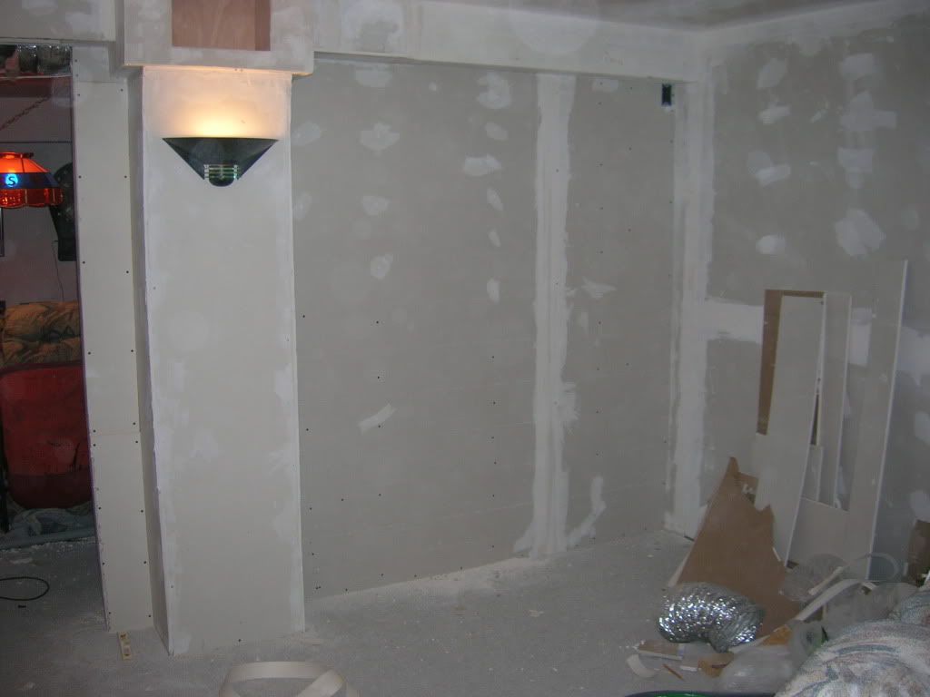

View of opposite wall from screen side towards seating riser:

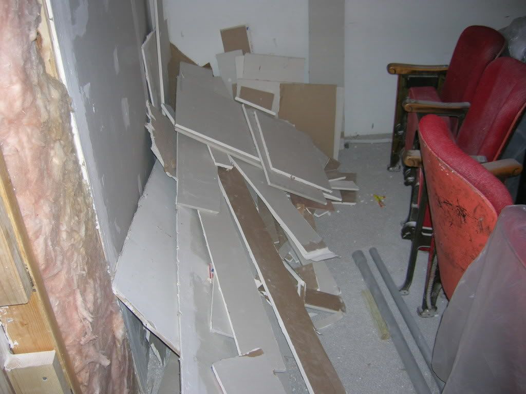

Pile of different sizes of scrap drywall in pool table room (never know when you'll need a scrap):
