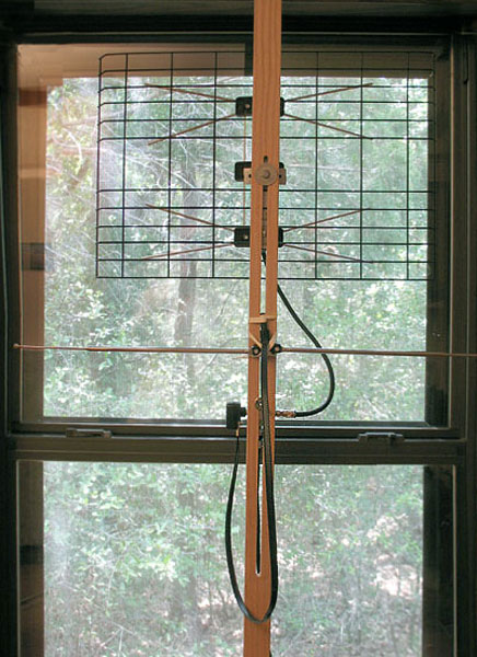

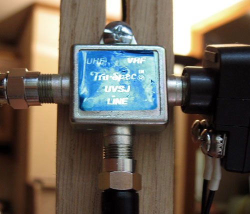

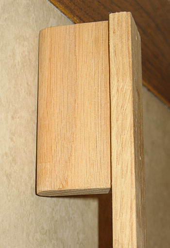

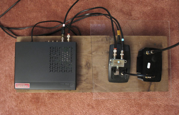

post #130 of 3229

post #132 of 3229
Originally Posted by EscapeVelocity View Post
Check this one out! Sylvania DTA 3500

post #133 of 3229
Im contemplating doing a shootout with about 20 different indoor antnennas.
