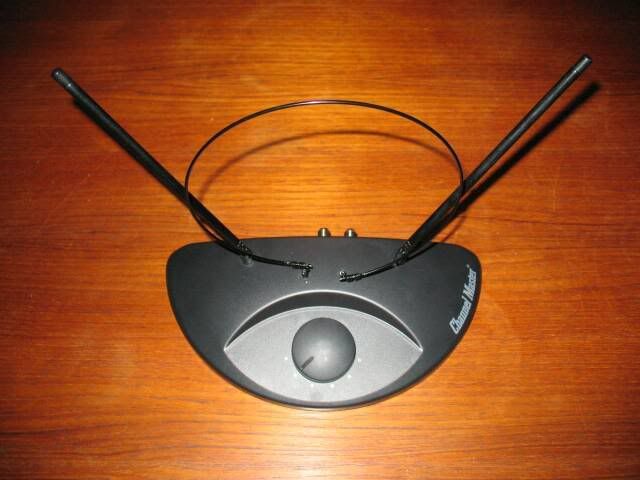

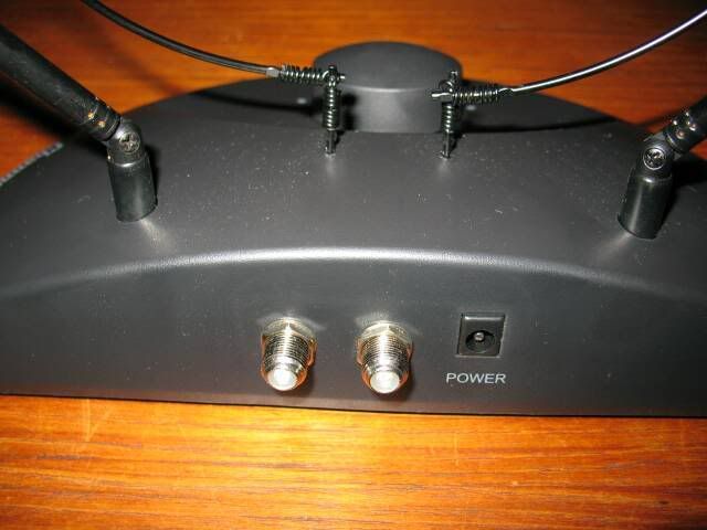

Channel Master 4030.
I thought this simple slim metal loop amplified RE & Loop might be pretty good. It is. It comes with a 6ft detachable coax cable and a wall wart for power. Build quality is good. One special feature is dual 75 ohm coax outs on the back, not switched. They are both active, so you can use it with 2 devices at once, like a VCR and TV, or Computer Tuner Card and TV, etc. Its all black design is low key. I dont know whether the knob on front is for amp level or fine tuning, Ill look into that. One other note, there is no LED power on indicator light. Channel Master also has similar looking models, 4010 and 4020, both unamped with the basic model 4010 not having the fine tuning knob. They are stocked at my local Tru Value, I know the owner pretty well, Ill see if I can take them home for a quick test run.
PS, the loop is more adjustable on this one than the RCA ANT108, but all you have to do with the ANT108 is turn the whole unit, to move the loop in azimuth.
