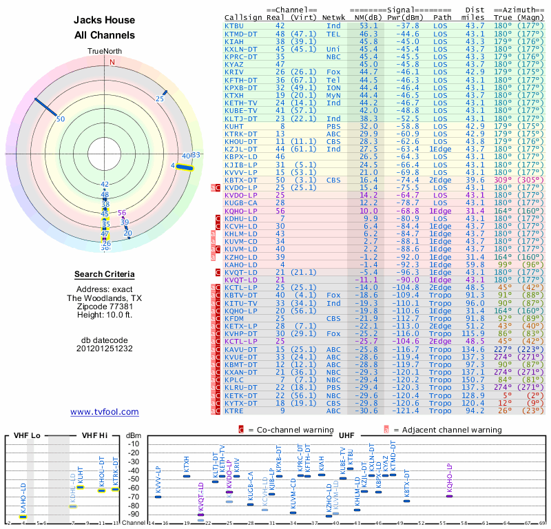

I live about 43 miles away from the towers in the midst of tall trees, with the city of Houston between me and the towers.
Is there an INDOOR antenna I can use which will get me good reception for all the channels in Green and the CBS(11) and ABC(13) affiliates in Yellow?
I'll post my TV Fool link once I go and post another two times on the forum....
Here is an image in the meantime:
Thanks for the help!

Post 2....
post #3099 of 3229
Post 3...
post #3100 of 3229
Okay.. hope it works now.
Here is my TV Fool Report: TV Fool Report
Which INDOOR Antenna will work best for me including the two channels listed in Yellow (CBS 11 and ABC 13)?
Thanks for your help!
post #3101 of 3229
Scroll to the bottom of your TVFool report. It says:
"An attic-mounted antenna is probably needed to pick up channels at this level [yellow] and above"
Aw Crap... I already have a huge antenna and amp in my attic which i am currently using to pull in the OTA digital to 3 DTV Pals and one Sony DVR. Didn't want to split it again though just to run to a TV in my office, mostly used as background noise during the day. Was using basic cable in there but now you need a Comcast box to watch ANY channels via their cable, even local ones.
How many times can I split an OTA signal before it degrades enough to matter to the tuners in the DTV Pals?
