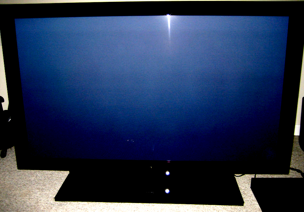

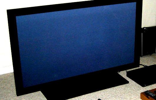

Well apparently my 151, which wasn't even supposed to be in the warehouse (which is in another state from the state which I live in) until after the 27th, arrived in the store today and they actually delivered it about 3 hours later. Kind of a crazy surprise, although it's currently breaking in on the dang floor since I wasn't finished setting up the room and running the wires for the wall mount.
Anyway, the delivery guys were great, even though it had to be unboxed in the yard to make it through the insane pathway to my basement through the house. TV seems to be pixel-perfect (big sigh of relief), but does seem to be a little buzzy. Since my basement is nearly never silent anyway (water running, A/C, beer fridge, etc.) I doubt it's going to be a big issue as even with most of those things off, I can only hear it out about 3 feet on an all-white screen.
I'm not entirely sure what the blotch effect is that people describe, but I don't think the set has it. I'll know better after I have the opportunity to see some content other than the varying colors of the break-in DVD.
Here's some pics, please excuse the disaster basement, everything's just piled up while we work on cable runs and wall mounts (speakers and the panel).

post #466 of 28852
rlarsen,
I'm not trying to upset anyone here, I just want to point out that the blotch effect would be easier to see with the break in DVD. If you don't see it now, I'm sure you won't see it with regular video content.
With that being said, I see a blotchy screen (effect, and I'm not saying you have it) just from both of the images you posted. Here are the same images with increased contrast to make it easier to see what I see even with your regular pictures.
There's some similarities with mine, but the patterns are a little different. First the before and then after (with increased contrast to make the blotchy effect to stand out.) Interesting that you have light areas and dark areas that have similar pattens as mine. Again, I don't even know if I have what is called the "dirty screen". And I'm betting I don't even see it with regular content. But I won't know till late Monday night after the 150 hours with the break-in DVD.
If you look carefully, In this image you can make out what looks like a dirty screen effect as it's easy to see all the blotches. Makes me wonder if it needs a simple cleaning? Since I've read about how easy it is to damage the screen coating, I have not touched it...YET...
Here I've increased the contrast on the screen to exaggerate the effect I'm seeing.

thebarnman,
the "blotch" issue is a different issue then the dirty screen or noise issue.
the blotch problem was seen with a blank input where sections = "blotches" of the screen were actually noticeably darker then other areas of the screen.
pioneer did replace some members panels that had this defect although it did take a little effort when it was initially noticed/reported for warranty issues but Pioneer finally recognized it as an actual panel defect.
the dirty screen issue probably is the same as some members reported having a noisy screen especially when the panel was viewed just after purchase. several members mentioned this but usually they did report it was much better or gone completely after the panel had been broken in say 200+ hours or so. see you already have noticed a lesser effect as yours get broken in that's a good sign.
note: yes be very careful if you attempt to clean the screen, the bonded filter is on the outside of the glass.
Wow, well thank you for pointing out the differences!
Two questions,...ok, three!
1. Can the Blotch effect be seen with regular video content?
2. Can the "dirty screen" effect be seen with regular video content?
I only had about 20 seconds of "regular" video content displayed on my screen and did not see that "dirty screen" effect at all. I'll know more after late Monday night (after the break-in) but I think I probably won't see it.
3. Is 200 hours more of a complete break-in?

Thebarnman: You're absolutely right. Now that I've had some time to actually sit and watch the thing play away on the break-in DVD, the blotchiness/dirty screen effect has become more apparent. Since I'm not used to looking at a plasma (this is the first I've ever owned), I think I was looking right past it initially. Now it's hard to miss.
I will probably try cleaning the screen tomorrow morning as I was going to let it cool down for awhile after about 12 hours on the break-in disc. I'm just going to use the cloth it comes with, dry, and see what happens.
It's VERY noticeable now on the all-white screens of the disc.
I've also noticed a stuck sub-pixel (seems blueish on red and green screens) in the top left, although it's not visible at 5-6 feet. I might be willing to let it go if the rest of the set is okay, but I suspect the blotchiness is a returnable offense. I'm not sure I don't have a streaking issue too (my mother, who's in town for the week, actually noticed it as well).
It's not exactly silent either, it buzzes pretty good. Just not really an issue for me as the basement is usually pretty noisy and I don't really hear it that much at 5-6 feet.
Figures.
Figures.
I'm glad you did not get mad at me. I was just pointing out something I could see in your pictures. One thing I was in fear of was if you did not notice till I pointed it out.
Anyway, one thing that helped improve it for me was to use the break-in settings that D-Nice set up. HOWEVER, there are two noise filters that are not listed in D-Nice's settings since they apparently are not in the 8G series.
The point is, all four of them should be turned off. (only two are listed in D-Nice's settings). About a day after I started to use the break-in DVD, I read that those two other noise filters should be off and so when I went to turn them off, it helped smooth out that "dirty-screen" effect. Now it's much harder to see them.
Also from reading this thread, the break-in period also helps with the "dirty screen" effect. It's to the point where it's not as noticeable as it used to be.
Most important, I don't think you or I would be able to see this effect with "reguar" video content. Even if we looked very hard for it. I know once I get my set "broke-in", I will be looking at regular video content to see if I can see the "dirty-screen" effect.
I don't think we have too much to worry about.
About cleaning the glass. It's been posted in this forum as how to do it without ruining the filter on the front of the glass. Don't use any cleaning liquids either. I don't even know if it's ok to use the cloth that came with the Kuro. Someone else might be able to ring in with that information.
I'll be waiting to hear how it turns out for you after you do your cleaning. And most important of all is to use D-Nice's break-in settings and turn off ALL the noise filters.
Sorry to hear about your stuck sub-pixel. It might fix itself with the break-in DVD with the break-in settings. I've got my fingers crossed!
Here is a whole thread about cleaning the screen (I'll also have to read it!!)
http://www.avsforum.com/avs-vb/showthread.php?t=798122
Break-in Settings...
http://www.avsforum.com/avs-vb/showthread.php?t=858851 (First Post)
