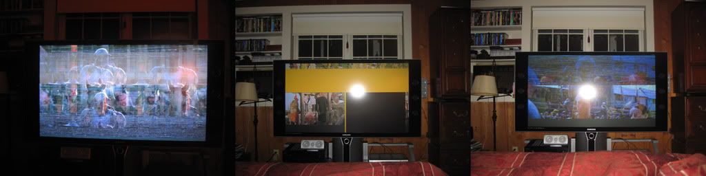

My HLR5688W 'Kirk' style Samsung Pedestal 56" DLP is today having much trouble displaying a clear image. The picture now seems to sometimes double.. sometimes black out a specific section.. sometimes is noise across the screen.. and sometimes seems to freeze for a few seconds.. This only first started to happen yesterday afternoon, but is now blatantly getting worse. I luckily have a Repairmaster contract and have already setup for a service call.
I thought that someone here seeing the pictures I took last night of the screen could probably tell in a second whether my problem is with the LE or possibly the DMD. Hmm...? Any input is as always much appreciated.

I have the same tv and am real sorry to see such a beautiful tv having problems. About the only major problem I have seen discussed on our tvs is the dmd board failing. It does look like possibly a color wheel also. But I would be very interesed in what you find out. Keep us posted after your repair guys come and good luck. Great tv!

I have this TV which I purchased when it first came out (in '05). It just started having problems today displaying 7 vertical bands comprised of 8 lines each, all entirely on the right half of the screen.
Does anyone know what this problem may be? Is it the DMD as well? Unfortunately, I don't have any extended warranty on this TV.
post #5 of 12
Half screen problems are sometimes the DLP chip itself failing. I believe the chip is located on the dmd board as well. Not looking good for our tvs. A guy on another thread got with Samsung Executive Customer Service about his dmd board and he was able to get them to offer him a new tv. But he may have just gotten lucky, but worth a try. Don't stop at regular customer service, they will just tell you to go away, ask to be referred to ECS and who knows what they'll do. Try to be civil and not scream at them, as the other guy said that worked for him.

My service tech came this afternoon and feels the problem is directly related to my DMD failing.. Hopefully, this part will be available... Anyone who actually owns one of these 'Kirk-style' HLR5688W knows just how special these unique sets are. Not too mention that this was the first initial 1080p HDTV available.
