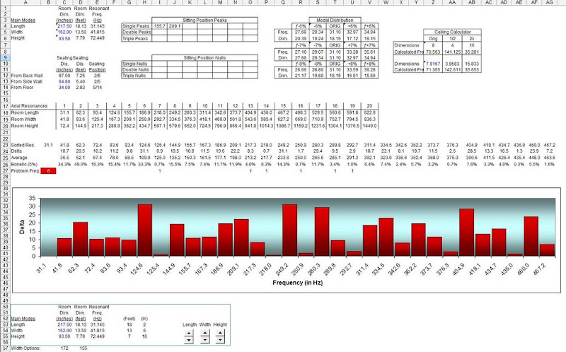

The bonus room is certainly big enough. However, there are many golden ratios and all are approximates. Russ Herschelmann wrote many articles for Stereo Guide to Home Theater years ago which stressed room diamentions, seating possition and speaker placement. From this, David Henderson created an Excel spread sheet that can calulate the peaks (bad) and nulls (worse) you will have at your seating position. Naturally, the calulations assume a perfect rectangle which few people have but the calculations are still probably better than a golden ratio.
If you PM me, I can send you the spread sheet & directions which I can no longer find on the web. I can either send you the original or a modified version where I added macros to more quickly experiment with changing diamentions. It makes the graphs almost animated as you can quickly scroll to make things bigger or smaller. Here is a screen shot from the spread sheet...

The nice thing about golden ratios is there are so many of them...pick one that will give you the answer you want ... it will be wrong anyway. That being said, in residential spaces you will have modal response regardless of what you do with seating and room dimensions. There are other and far more effective ways of dealing with room modal response issues (and you're going to need to do this in any case). So design the space to fit your functional requirements. BTW, the soft flexible wall thing is a certain amount of non-sense. Your walls become speakers and what is really happening is your walls are more transparent to low frequencies meaning the reduction is bass modal excitement is really as a result of a reduction in low frequency energy in the room. Solution? Bigger subs. Oops, now I have real modal (and other problems).
Modal spreadsheets seldom, if ever, are accurate predictors of room modal response. They fail to take wall impedance and a long list of other factors into account. You may be sweating a dimension to reduce a mode which, when the room is finished, wasn't a problem to begin with.
