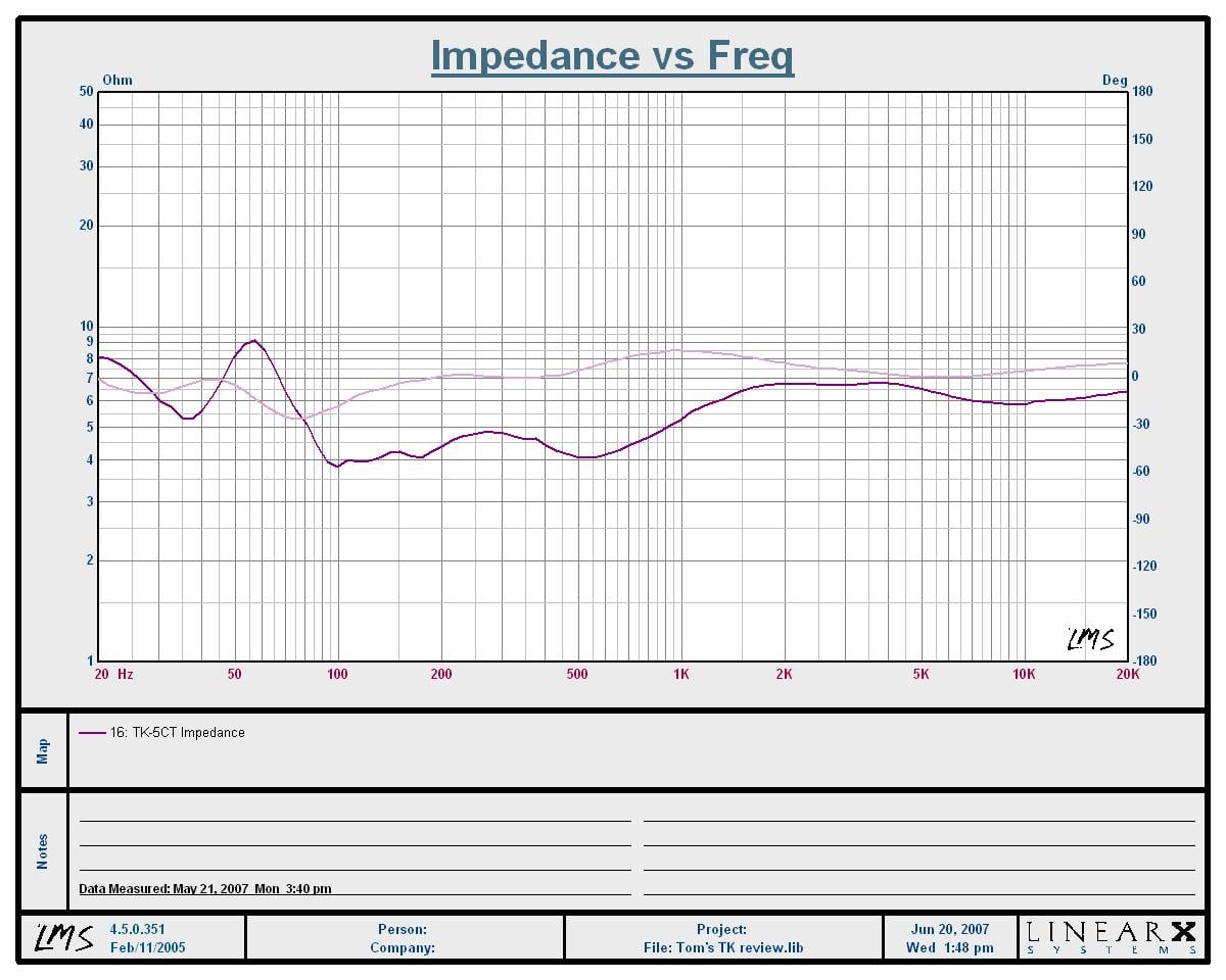

I posted this on another forum, but this may be the better thread for the question.
I am trying to determine if the 1909 internal amp can adequately handle the speakers for which I pasted the Ohm graph below. Amy help is appreciated.
From the Denon AVR-1909 spec sheet:
90 Watt - 8 Ohm - THD 0.08 % - 2 channel(s) ( Front )
120 Watt - 6 Ohm - THD 0.7 % - 2 channel(s) ( Front )
From a review of the speakers, it looks like between 100 to 200 HZ, Ohms dip to 4. I know this is somewhat subjective, but does Denon have a reputation when it comes to pushing a higher load like this? I already own the receiver and am thinking about exchanging my current speakers for these ones... my only concern is if my denon will be able to handle the load. I listen to TV at moderate levels and will probably crank it for movies to 85-90 db.
Thanks guys.
post #1517 of 11204
There have been no reports of the 1909 not being able any speakers, with graphs or without.
post #1518 of 11204
I have heard many stories of speakers dipping to 4 in that range of the graph in many threads in this forum but there has been no reports of problems. it could be that most AVR manufactlurers are aware of that behavior.
post #1519 of 11204
