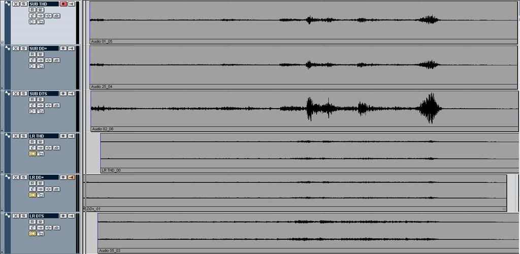

Top Gun HD DVD(tower buzz- timestamp 00:33:00-00:33:45), 6.1 TrueHD, 6.1 DD+, 6.1 DTS-ES(Yes I know it's not HDMA), Peak Output:
Subwoofer THD track: -15.1db
Subwoofer DD+ track: -16.0db
Subwoofer DTS track: -4.9db
Left THD: -17.2db
Left DD+: -17.3db
Left DTS: -14.6db
Right THD: -17.5db
Right DD+: -17.6db
Right DTS: -14.7db
Comparison pic
Top Gun TrueHD L
Top Gun DTS L
Top Gun TrueHD R
Top Gun DTS R
The TrueHD and DD+ tracks have an offset in the 3808 of -4db so if we take that into account(although it is more accurate to do this in the receiver before it is recorded, and looking at the L+R figures it it may be closer to -3 for the recorded signal, but I digress) for those figures, we get.....
Subwoofer THD track: -11.1db
Subwoofer DD+ track: -12.0db
Left THD: -13.2db
Left DD+: -13.3db
Left DTS: -14.6db
Right THD: -13.5db
Right DD+: -13.6db
Right DTS: -14.7db
......but even still there is a major discrepancy with the DTS track which has some serous boost in the LFE channel compared to it's own mains let alone the other tracks.
Even if the DTS-ES track was taken straight from the DVD version there shouldn't be that much of a boost relative to the mains............question then becomes which is correct?...........so you tell me, are DTS up to their old tricks again?
As it stands,
if you try to compare the THD track to the DTS-ES track without adjusting the volume your sub output is 10.2db higher
if you try to compare the THD track to the DTS-ES track with adjusting the volume to match the mains, your sub output is still 7.4db higher
if you try to compare the THD track to the DTS-ES track with adjusting the volume based on the -4db offset, your sub output is still 6.2db higher
Any way you look at it, someone has fiddled with the tracks, so a comparison on QUALITY in this instant is impossible for most. The only way to compare realistically is to adjust both mains and sub individually...........and even then if you are using bass management your up the creek and cannot compare equally.

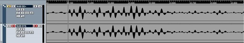

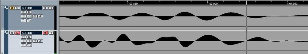

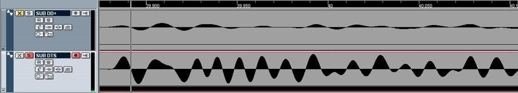

Here are some close ups of the TrueHD, DD+ and DTS-ES subwoofer tracks
1
2
3
As you can see the TrueHD and DD+ tracks are almost identical in waveform.
The DTS-ES track on the other hand has major differences, not only in amplitude but also in phase timing.

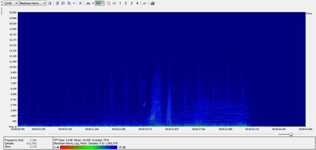

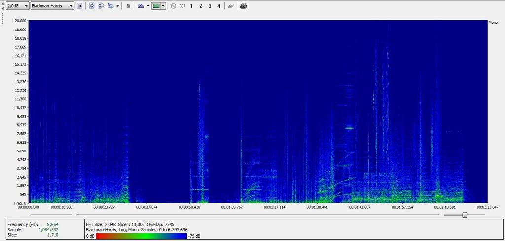

Here are the Sonograms of Disturbia:
DD+
DTS

post #19 of 35
Originally Posted by LessisNevermore View Post
I'd be very interested in seeing some L/C/R full-range spectrum analysis between the formats, as well.....
Displayed as spectrum graph, sonogram or waveform?
I don't think sound forge can show more than a single point in time in a spectrum graph.
I have the information for Top Gun TrueHD/DTS L/R which is shown in waveform above and I also can do Spiderman 3 TrueHD L/R(since I downmixed the Cubase project to PCM). Here are the sonograms(I'll also add them to the op
Spiderman 3 TrueHD R
Top Gun TrueHD L
Top Gun DTS L
Top Gun TrueHD R
Top Gun DTS R
cheers
