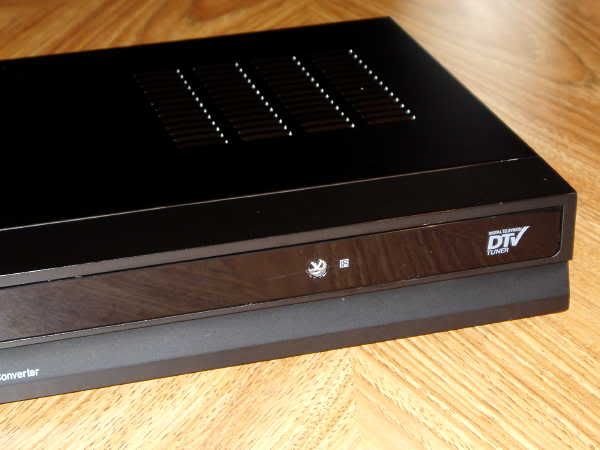

The case on the DT502 is identical to the DT250 and, as I've pointed out on the 250 thread, the Insignia has a large area of ventilation openings on the top while the APEX doesn't have any. That alone will cause the case to be warmer than the Insignia, due to the rising of heat through convection.
As a comparison, I will use my Princeton Ultra 78 17" CRT graphics monitor. It has plenty of ventilation and has been on since 2000 (It does go into blank mode when I'm not around) and it is putting out, what feels like (since I don't have a thermal meter) three times the heat. I might also compare it to the amount of heat you feel on someones forehead when they have a fever.
