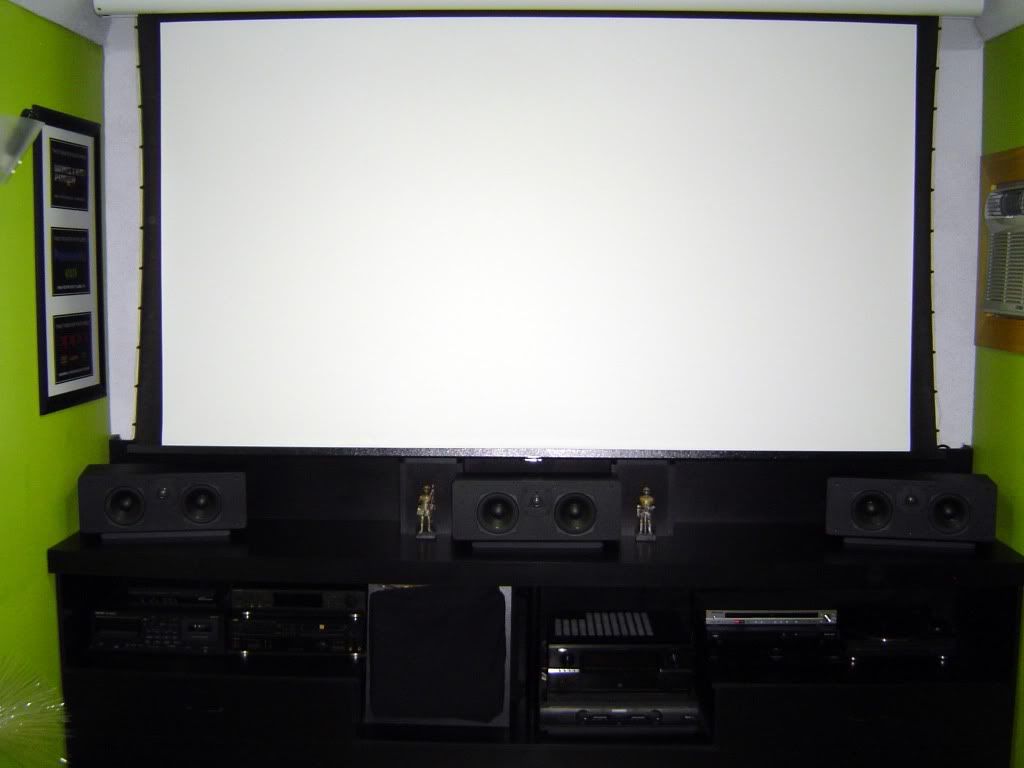

Well, I'm not an expert though, but I've been pretty much happy with my new "full horizontal" front array and even if necessary, I'd somehow sacrifice a little bit in terms of audio performance, as you can see by the photo below, as I got no choice at all, but to place the LCR array horizontally.
Not sure how much that would be, though, but I think nothing relevant anyway
Regards, Chuck
Regards, Chuck
Yeah but that looks like three center channel speakers that were intended to be horizontal.

my LCR fronts are layed down on a rack, at 33" high (as you can see by the picture posted above) and honestly they sound just owesome to me, family & friends though.
Furthermore, before purchasing the SCS's I used to have another LCR front array, horizontally placed as well ( JBL S38II's ). Perhaps I got used to the LCR stange breed sounding, but so far, no complaints at all
Regards, Chuck

So, let's start out with the "ideal". The very best front speaker arrangement is 3 identical speakers across the front soundstage, evenly aligned horizontally and placed behind an acoustically transparent screen. Anything other than that is a compromise of one sort or another. (Some would argue that an acoustically transparent screen is a "compromise" in and of itself, and it is hard to disagree with that. However, with the new woven screens, the acoustic transparency is greatly enhanced, and the addition of an Audyssey EQ makes it a complete non-issue.)
It is a compromise to place the L/R's on either side of the screen with the center below, (or above) the screen. The CC will sonically image above or below the video image. Also, "pans" will change "height as they move between the speakers. Even Kal's arrangement with 3 vertically aligned speakers below the screen is a compromise for AV, (although it probably is not for audio-only applications.) Using a speaker in an orientation that it was not designed for is a compromise. Laying most speakers designed for vertical alignment on their sides is a significant compromise. The dispersion characteristics will be changed. This will be more significant with some speakers than with others; however, it will be an issue for almost all speakers designed to be vertically oriented.
Then there is the issue with lobing of an MTM, (midrange-tweeter-midrange, or the D'Appolito array.) These types of speakers exhibit comb filtering off-axis of the tweeter. This lobing will occur above and below the front axis when the speaker is aligned vertically. Since these speakers are meant to be placed with the tweeter at ear level, the lobing is not "heard" because it is above and below ear level. However, if you place three of these speakers horizontally across the front soundstage, every listening position will be off-axis of at least 2 of the front speakers. Then lobing does come into play. Here is an article that describes the audible effects of lobing:
http://www.audioholics.com/education...peaker-designs
This problem affects many horizontally oriented speakers, even if they are specifically designed as "Center Channel" speakers. If both the midrange drivers are reproducing the same sound, they will reinforce and cancel each other at various point off-axis.
Some manufacturers have gotten around this problem using ingenious techniques. Klipsch uses their "Tapered Array", which crosses out one midrange speaker before the lobing occurs. Other manufacturers offset the tweeter and mount the mids close together to reduce lobing. Some manufacturers use a 3-way design with the tweeter and midrange stacked in the middle, and the mid-woofers on the sides. KEF uses a coaxial midrange/tweeter with mid-woofers. All these designs attempt to allow the mid-woofers to be crossed over below the point of lobing. Still, since crossovers are filters with slopes, there will still be some interaction between the outside midrange/woofers, even if it's at a reduced level.
Overall, if one cannot achieve the "ideal" of 3 identical speakers behind an acoustically transparent screen, (and obviously many or most cannot), then one should simply be aware of the compromises involved. If those compromises are acceptable, then one should not look back.
Personally, I have lived with many compromised systems in the past. I went from using the speakers in my RPTV cabinet as the CC, to placing a horizontal CC on top of the RPTV cabinet, to placing a horizontal CC below a projection screen, to placing an identical speaker behind an acoustically transparent screen. Each system sounded good and each upgrade was a little less of a compromise. However, it wasn't "ideal" until the last upgrade. Before, I could always tell that the imaging wasn't quite right, the timber-match wasn't quite right and the off-axis response wasn't quite right. Now, with 3 identical speakers behind the screen, the sound locks up perfectly with the video image and the timber-match is near perfect. I can sit anywhere in the front row and the front soundstage is virtually the same, (I've also EQ'd with Audyssey MultEQ XT.)
Bottom line, one can make most any system sound "pretty good", "good" or even "great". However, there is only one "ideal" system and anything less is a compromise.
Craig

You're entitled to your opinion.
I couldn't disagree more. I don't think it's appropriate to encourage someone to do things that are less than optimal. If you do a search for my username and look at my posts, you'll find that I often tell people what is "ideal" or "optimal" and let them make their own choices from there. When people ask about compromised surround speaker placements, I point them to the Dolby website and show them the "ideal" surround placement. When people ask about in-wall/in-ceiling speakers, I point them to the CE-Pro article about the compromises involved in in-wall/in-ceiling speakers.
True, but that doesn't mean we should encourage them to pursue less than "ideal" setups.
I was at CEDIA last week. I visited at least 10 demo rooms. NONE of the high-end demo rooms at CEDIA had the speakers behind the screen. Even the Runco room, which had a mega-dollar Krell speaker and electronics system (~$300K by my estimate) and a quarter million $$$ video projection system, including a Screen Research acoustically transparent screen, had the speakers sitting on the floor below the acoustically transparent screen.
The Integra room had a set of Atlantic Technology THX Ultra2 speakers. The horizontal CC was underneath the screen. (I have these same speakers at home except with the horizontal CC replaced by a 3rd L/R.) They were playing a song by Ladysmith Black Mambazo. The first two voices came from the L and R speakers, and they imaged perfectly. The 3rd voice, the lead singer, came from the CC which was mounted below the screen and lower than the other two. It was so obvious that the CC was mounted below the horizontal plane of the other two speakers that I was immediately distracted by it and never got past it the rest of the demo. Yet, the guy sitting next to me didn't even notice it until the demo was over. When I pointed it out to him, he recalled the same effect.CEDIA is a show for "installers and "designers". It is because these people are not encouraged to pursue the "ideal", even in mega-dollar demo rooms, that we have so many marginal installers. I was in a house last year valued at $1.8M during the local Parade of Homes. The HT was in a large room above the 5-car garage and the HT installer was there showing off his design. This room could have been an outstanding HT. The installer had installed 2 seats up front, one in front of the left speaker and one in front of the right speaker, separated by an "aisle". There was also a riser in the back right corner of the room, (that's right... in the corner!), with two more seats. When I asked him which seat was supposed to be the "sweet spot", he said, "When I'm finished with a theater, every seat is a sweet spot". I didn't stay for a demo; I just left.
My brother has an HT designed and installed by an "installer" in Phoenix. It's junk... and he paid at least 3x what I did for mine. He ended up with in-walls without enclosures, (the CC is mounted below the display and the L/R's on the left and right), a sub in a cutout alcove in the wall, a Pioneer plasma that was outdated when he got it, and a DirecTV dish that has never worked right. His Pronto remote was "programmed" by the installer, but my brother was never instructed in how to use it or reprogram it. It's now in a drawer and my brother uses 6 different remotes to control his system. he's disappointed with the picture quality, the sound quality and the usability of the system.
Originally Posted by Dragon Reborn
Could I have built the perfect home theater? Absolutely not with the space I had to use.
Is my soundstage perfect? No, not by a mile.
Am I happy with my setup? You betcha. Is there anything wrong with saying that? I don't think so.
So, to the OP, try it and if you like it, don't worry about it. But if you have "money to burn," do what Craig John recommends.
I wish I could have, but I couldn't, so I didn't.
If you're happy with it, that's fine. You seem to be aware of the compromises you've made. If they don't bother you, or at least you can accept them, then don't look back. However, it's less than "ideal" to tell someone else to accept those same compromises.
BTW, it's not about how much you spent on your system, or how much I spent on mine. I looked at the link in your sig to your room and system, and it's very nice, in some ways nicer than mine. I certainly doubt that I spent any more on my system than you spent on yours. (The red velvet curtains in my room are *behind* my screen, instead of in front of it.
) My screen was $1,300 from SeymourAV, and it's a motorized, drop down screen. (www.seymourav.com) It allowed me to get my speakers behind the screen. As soon as I put them back there, it became immediately obvious how much better this arrangement is.Also, Kal was the one who pointed out to me the lobing issue with my then-horizontal CC, a Klipsch RC-7. This was about a year and a half ago, in another discussion about center channel speaker designs. I had never heard the lobing issue in my room, and at first I didn't believe it existed (mostly because I always sat in the "sweet spot" where lobing is not an issue). Then Kal told me what to listen for, and I sat off-axis of my CC, and sure enough, I heard it.
Going forward, when people ask questions on this forum, I will continue to point out, (as does Kal), what the "ideal" arrangement is, and let them decide for themselves from there. And when other people suggest that something less than ideal is acceptable, I will point out again what is "ideal".
Craig

Actually typical horizontal MTM center channel speakers such as those pictured are not designed to lay on their side...at least not acoustically. They are cosmetically and practically intended to lay on their sides despite the acoustic disadvantages.
There is a fix for the lobing problem of horizontal arrays but it requires very unique crossover transfer functions that can not be done practically using analog (especially passive) crossovers. This crossover design approach developed by Ulrich Horbach and Don Keele for Harmon International can very successfully control the dispersion pattern across the array through the crossover frequencies with no lobing issues. In fact, it's amazing how well it works and how much sense it makes mathematically. What's really amazing is why no one thought of it before. It absolutely works perfectly! I'm planning a horizontal W-LM-HM-T-HM-LM-W horizontal array that will be over six feet wide for my HT using this crossover technology. I will locate it behind the screen.
http://www.aes.org/e-lib/browse.cfm?elib=14199
Now, from the practical standpoint...lobing at the crossover frequencies causes narrow band notches in the frequency response. Depending on where you sit in the room, you will or will not fall into one or more of these notches in the direct sound. Because it will be filled in by reflected sound it will not be as noticeable as you might expect. So, if you are not an overly critical listener, you could put typical two or three way speakers intended to be vertical on their side and not notice any major problems. If you do comparisons going back and fourth between vertical and horizontal you probably will notice the difference but your listening position will have a large effect on how significant it will be. Especially if you are sitting on center, you're probably going to be fine with them on the side. Personally I don't like having them sitting low such as below the screen but if it's not a problem for you then having them on the side should be ok.
Monte
