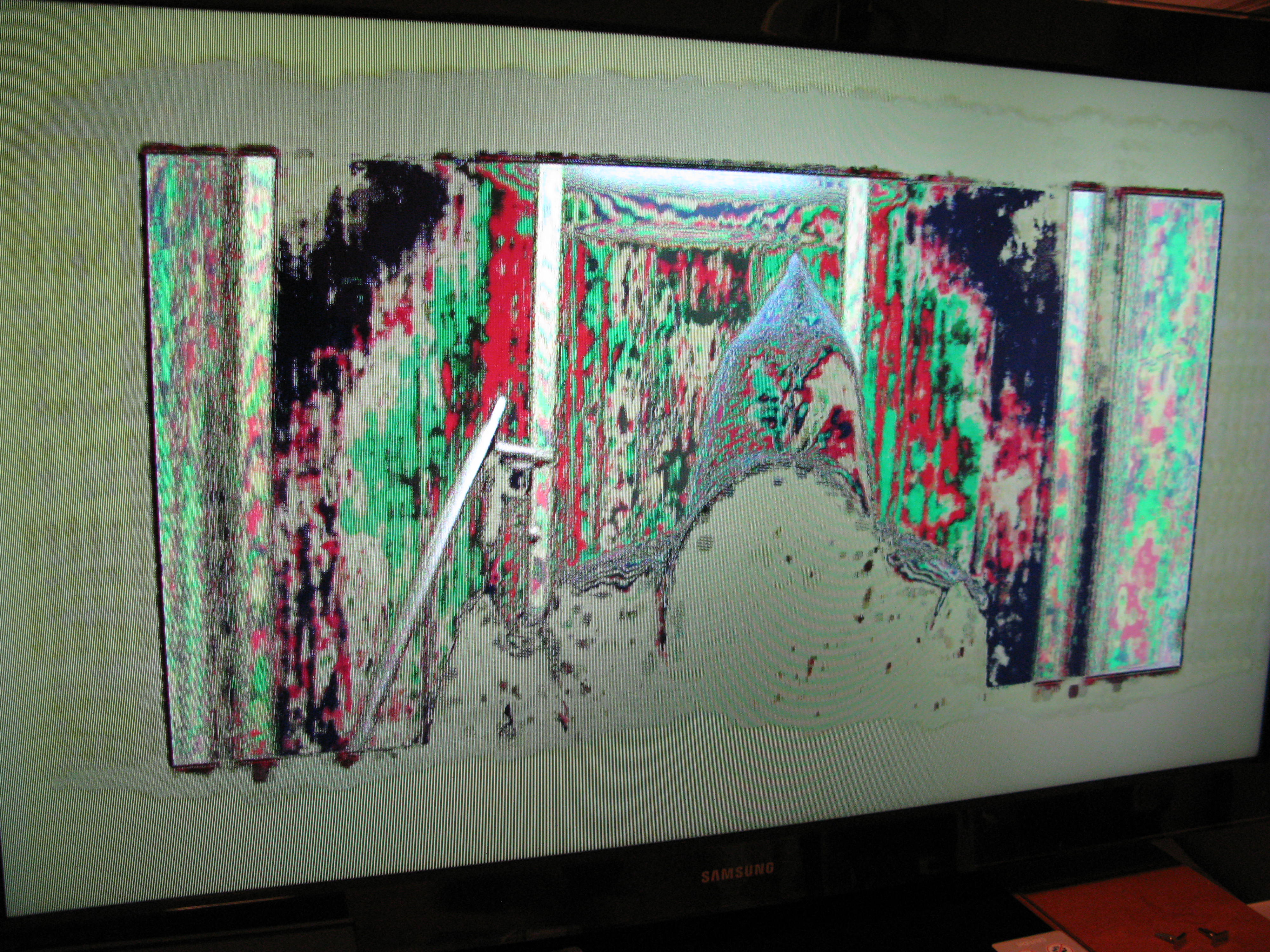

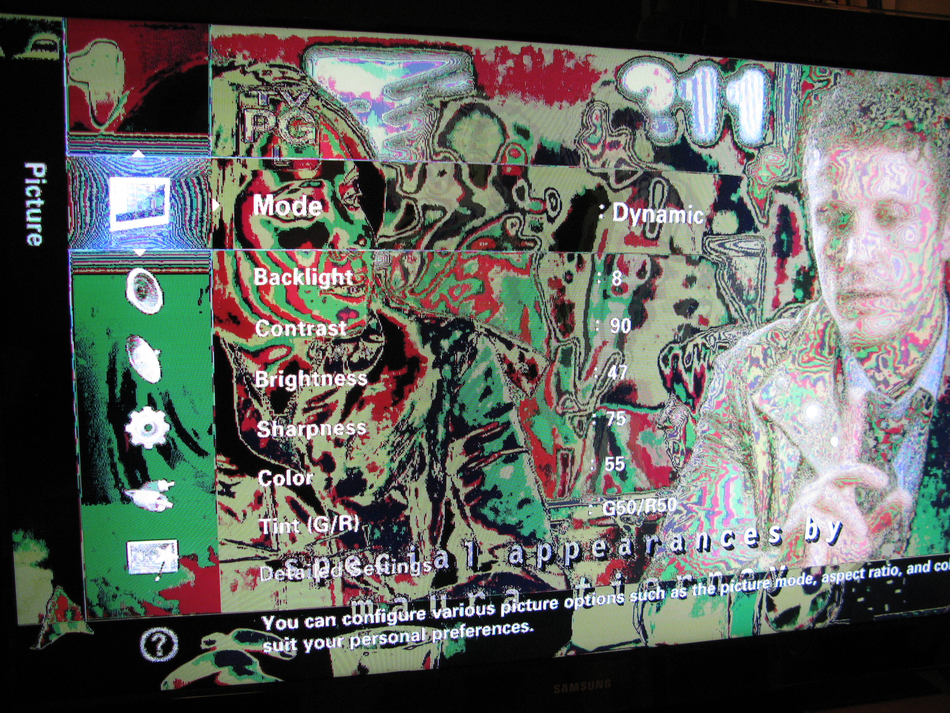

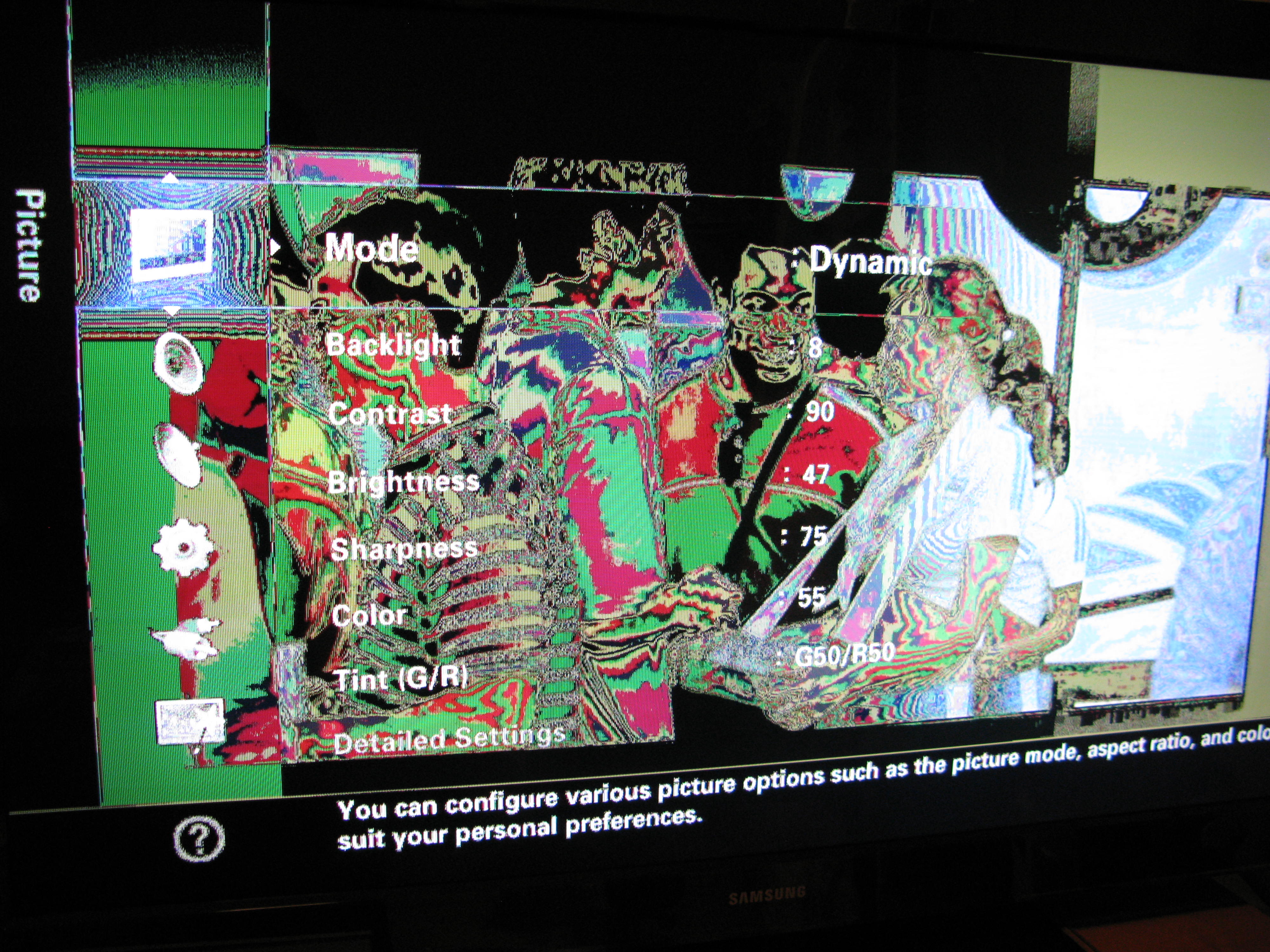

Originally Posted by James_M View Post
Help! My LN55A950 went into some kind of psychedelic color mode (see pics) and I don't know how or why it happened. It shows on all imagery, menus, tv, games, etc... No joke. I don't know if it has anything to do with it but my brother was playing a PS3 game and was getting a text message when it happened.
(warning HUGE graphic pics)
http://jamesmarstudio.com/stuff/IMG_1154.JPG
http://jamesmarstudio.com/stuff/IMG_1156.JPG
http://jamesmarstudio.com/stuff/IMG_1158.JPG
How do I fix it??!
Aww man. I really hate to see another set like that. This happened to someone else here a few months ago. He posted pictures that looked very similar to yours. I'll try and find the post for you.
In the meantime, I'd defintely call it in for support.
Edit: Found the post. http://www.avsforum.com/avs-vb/showp...postcount=1047
How do I fix it??!
Try to reset the TV - press and hold EXIT button on TV's remote for 10-15 secs and see what happens...

The problem is though,(hope I can explain it right) when the Smart LED feature is "on", as it is always, and the movie scene between the bars is bright (say the sky) , because the cluster of LED's behind the sceen is lit for the sky, the LED's in the black bar portion top right and left are also lit which clearly show the light leakage in the top left and right corners. When the scene is dark the clusters dim, masking the leakage.
my 52" 6 series and a friends 46" 6 Series is nothing like this.......and no led's
smart LED turned off, to show where exact leakage is~
This one is over exposed to show the bleading top left and right corners only, ignore the lights in the top middle portion (light flare from camera)
smart LED on, although it doesn't look as bad as in the picture, its quite noticable in a dark room with no lights on.
Guys
Are you able to send a pic showing what kind of leakage I should be expecting from a correctly built screen?
As posted I understand with Smart LED turned off, there will uniform leakage through the screen, but like mine, I think bleading of the LED light around points on the screen, either indicates assembled to unevenly or leaking through a gasket.
Have requested a new one, I would like a reference point... Thanks
If you can send a pic (smart LED turned off)
My email.. rokkz@hotmail.com
