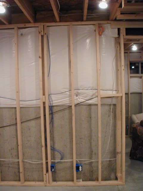

Here is what you need to replicate what I have now (and I did have to do some additional wiring AFTER the drywall was in... Not fun...)
First off, I ran rgb wires from my receiver wall (under the screen) to the projector. After I had the drywall done, I realized how much better a HDMI cable looks... So I ran one of those (a 50 footer), I don't even use my rgb wires, in fact, I ended up using two of them for my extra speaker wires I needed when I switched from 5.1 to 7.1. A good switching (many sources) receiver and an HDMI cable are all you really need running from your receiver to your projector.
From receiver to projector
1. HDMI cable, 50 foot in my case, off ebay for $50.
Options include;
2. (I didn't want this, but you may) a remote wire (two strand) to control your screen when projector is turned on.
3. Cat 5 wire, for future upgrades.
4. Standard coaxle cable, in case you ever need it...
From receiver to each speaker location, (go ahead and wire for 7.1...)
Get good thick wire. You can put ends on it yourself with a soldering iron and connectors from radio shack or online. (online better quality)
Keep your speaker wire apart from your video wires and power wire, video is shielded, but you might as well keep it apart just incase...
1. Run each wire to each speaker, making sure to label each end of the wire clearly for ease of hookup.
2. Run a extra seat of 2 channel speaker wires for extra room listening that can be accessed in the future. I ran mine into my storage area. So I can put wires outside, or in a different area later.
Power. Run power to your receiver area, and a different circuit to your projector. Also run power next to your theater seating area for phone, or laptop.
Run a video/stereo audio cable from your receiver area to your seating area. (so you can hook up a laptop later with sound into your theater surround sound).
Run a VGA cable from your projector box, down the wall to your theater seating area, so you can plug in your laptop later. (netflicks online is great with this feature). (cables off ebay are the most cost effective I've found).
Don't forget your phone wiring. I ran one next to my theater seats, and another line behind my receiver as most satelite systems need a phone line.
Run 3 or 4 coaxle cables to your receiver with access in another place in your basement.
I use 2 for my directTV hookup (most 2 receiver setups need 2 cables), third is for my over the air antenna, which I use to get channels on my dvd recorder over the air, and also for use on my receiver to pick up am/fm radio. I have a wineguard 2000 antenna on my roof which is a great way to get great picture quality from very far away without rotating an antenna. Fourth is to run video from a different area of your house if needed in the future...
Here is a pic of my ratsnest, excuse me, my wiring behind my receiver. Speaker is on the left. middle is video wiring, on the right is the phone, and far right is power. A few wires are missing as I ran them after the picture was taken... hdmi, rca to theater seats, ect.
put a big OPEN box in the ceiling for your projector stuff, and mount a board to support your projector mount. Label all your wires...
Theater seat area. things missing from pic, rca wires to receiver, and vga cable, they both come out next to the power which is on the right, phone on the left. The extra coax wire is from my receiver to a extra tv in my arcade...
