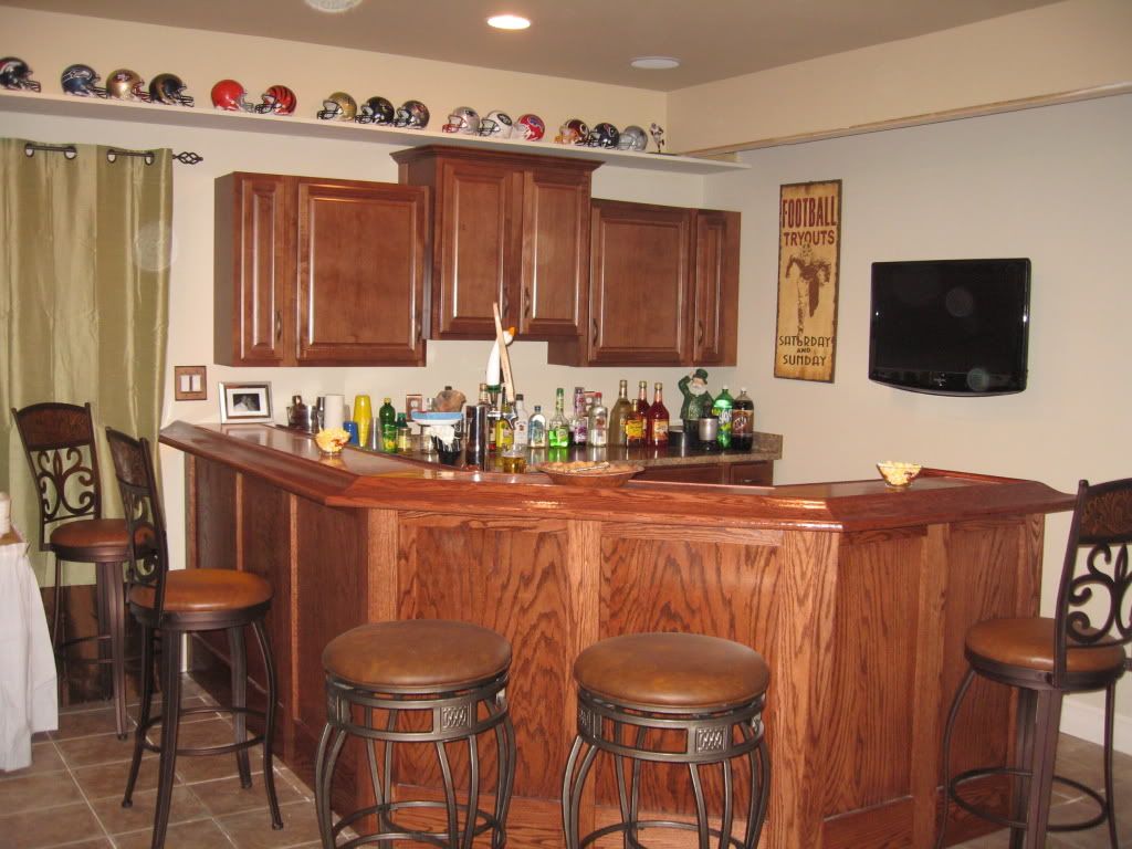

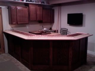

The current look of The Copper Pub

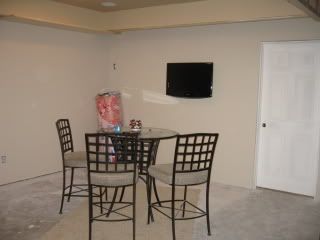

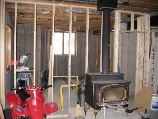

Before:

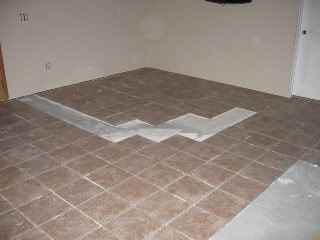

After flooring:

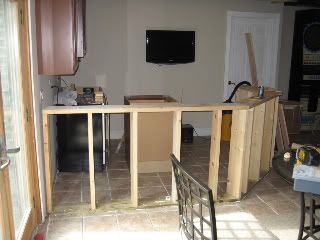

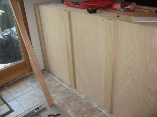

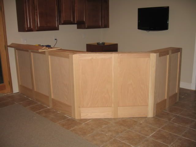

After Bar framing & Wall cabinets:

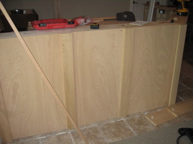

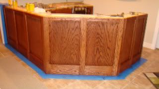

After Oak panels installed and stained:

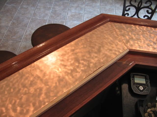

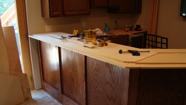

Bar Top & Bar Rail being installed:

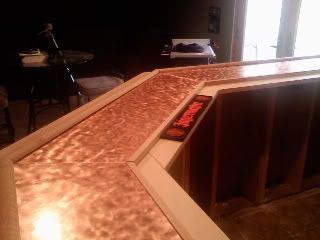

Is that a brushed copper bar top? Looks classy.

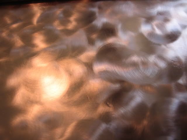

First it's a honor to have you BIGmouthDC looking in on my thread, I have followed your thread for a long time, I could only dream to have a set up like yourself and think you do exceptional work.

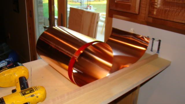

Yes it is a brushed copper but I purchased the copper in a 12" x 10' sheet and used a drill with a steel wire brush to give it that brushed look. It was cheaper to do it myself and I wasn't sure about using copper but knew I wanted something different.

I wrapped the copper around 3/4" partical board using contact cement from DAP. then coated it with a stuff called Copper Shield to keep it the shiny color and not to turn the patina green color. before the envirotex I could still mar it with some effort but never thought that it could after envirotex that will be a learning lesson, I did use a 6" x 6" peice as a test so maybe I'll try using that as see if I can imprint it. I'll let you know...
yEah I still have to use the putty and staing the bar rail I only finished the bottom section of the bar and then once that was done worked on the top. The bar rail will match the stain color on the bottom.

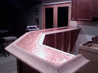

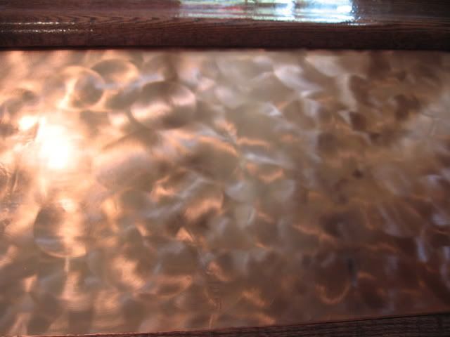

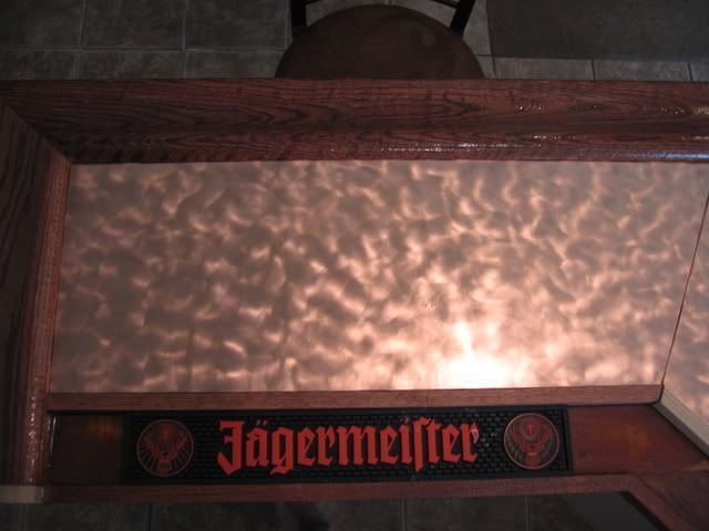

Some updated pictures from this weekends nightmare...The envirotex didn't take on the bar rail, the drip rail came out sweet but the bar rail looks like crap, I started to sand it down to see what can be done so you may see some white residue in some of the pictures and that's what it is. The copper portion is not done in envirotex yet, this weekend was only to do the bar rail and the drip rail. After I figure out what to do with the drip rail I will start on the top.
It is hard to get the issues I am having on film but here are some close ups of the bar rail and the circles all over it. It was as if the envirotex didn't adhear to it or something.
The drip rail (straight ahead) came out sweet, the residue is dust that you are seeing from sanding the bar rail, but the drip rail is smooth as glass and I am really happy with it. This makes me confident that the bar top (over the copper) is going to look awesome because it's flat. I believe the issues with the bar rail are that it is on an angle and just didn't get evenly coated.
