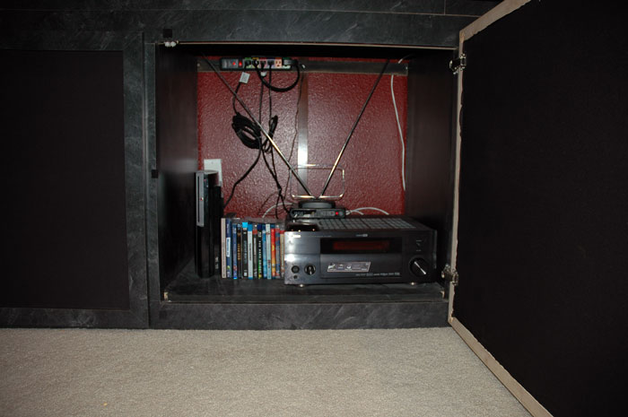

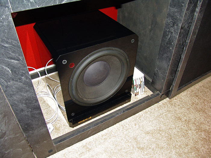

I'll be picking up a Parasound Amp tomorrow and need to add some form of shelving system to my false wall/entertainment center. The center cabinet space is 30" W x 27" H x 25 1/4" D. For some reason, the guy that built the cabinets made a bottom shelf out of wood and spray painted it black but did not make one for the left and right cabinet. He was supposed to make some form of shelving that would slide out so I could easily get behind the equipment to change out wires, add new equipment etc but long story short, that didn't happen.
Here is where I need some advice. Should I get some 3/4" Plywood and cut shelves, paint them black, and put dowels in the sides of the cabinet with the metal pins? Or do you have another suggestion?
Currently, I do not have a lot of equipment. My sub is located in the bottom left cabinet. My Receiver, PS3 and Rabbit Ears (don't laugh), are located in the bottom center cabinet and I will be picking up a Parasound 2205a amp tomorrow that will likely sit beneath the receiver. The right cabinet contains misc remotes, DVD's & CD's.
I know I need to add a bottom shelf for the left and right side cabinet since my subwoofer and DVD's are actually sitting on carpet since the guy didn't install a bottom shelf for the left and right cabinet.

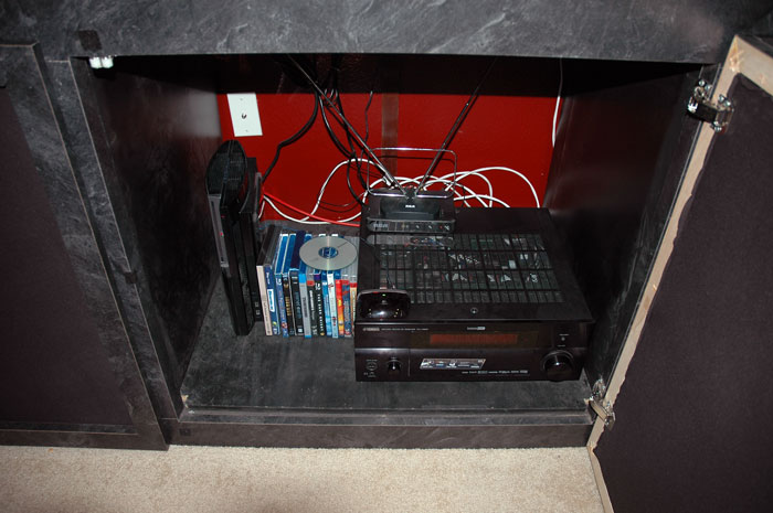

Bottom Left cabinet
Photo of the bottom center cabinet which is beneath the screen.
Currently, all my equipment is sitting on the bottom shelf.

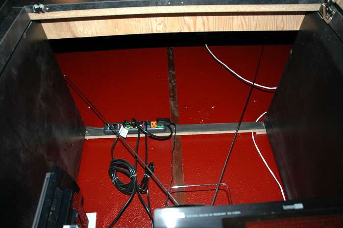

A shot looking up into the false wall. It's hollow behind the screen.
You can see here the bottom "shelf".

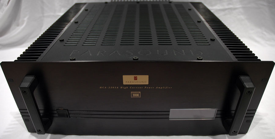

Just got home with my new addition to the HT. I picked a Parasound HCA2205a (220w x 5) amp from a Klipsch forum member. Amp is in excellent condition. This thing is a beast at 85 lbs!
It's almost midnight so there won't be any test runs tonight. Have to wait till tomorrow.

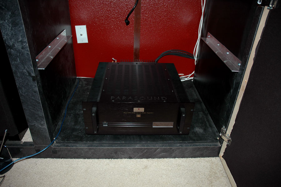

Adding shelf.
So my rack was made by my carpenter and is wood. The shelves are supported by holes in the sides and metal pins into the holes. I've had numerous problems over time with this model. The wood shelves warp, the weight makes the pins bend in the hole and the shelves then drop. All not good.
If I look at your space it is VERY wide. Mine is just a bit wider than a piece of equipment. Yours seems to be about 1.5 times that. I think a single board that had any weight on it might bend a lot. I'd also stay away from the pins to hold such a large area.
My suggestion is to buy a simple standalone shelf/rack and place it inside the space. Something that is just a little wider than the equipment. I know a couple people have bought inexpensive but sturdy stuff that is easy to assemble at Home Depot. Guess it doesn't really matter how it looks given it will be behind a door. You could slide it to one side and leave room on the other side for your PS3 and content.
post #326 of 451
You have a good point Happy.

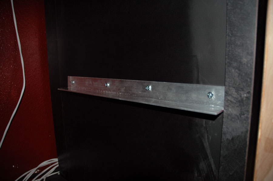

I stopped by Lowes earlier today and picked up one three foot piece of 3/8" Aluminum Angle 1 1/2 x 1 1/2". Cost $12.00. Probably could find it much cheaper somewhere else but I want to get the shelf built tonight so I can hook up the new amp and test it out. I grabbed a bag of eight 12x3/4 Flat Philips Wood Screws. Not sure if I should have gone with the round head instead of flat since the flat is angled on the back side of the head. I'm hoping that if I drill the holes the same size as the screw diameter that it should be fine.
I found a piece of scrap 3/4 plywood that I'm going to use for my shelf.
I cut the two Aluminum Angles in 1/2 to give me two 18" lengths to work with. I will put 4 screws in each Angle securing it to the side walls of the cabinet.
With your comments about sagging, should I buy a few flat aluminum pieces and place them across the width under the wood shelf. Would that keep it from sagging over time? The only thing that will be on it is my receiver which is just under 40 pounds.
Once everything is cut and installed, I will need to paint the shelf flat black, let it dry, then install everything. Might not be until tomorrow before I am able to install it. Depends on how fast the paint dries.
post #327 of 451
Holes are drilled in the Aluminum Angles, shelf has been cut and painted. Will need to wait until paint is dry before installing.
post #328 of 451
I would think attaching some aluminum angle to the bottom of the shelf would would reduce the sagging more than a flat piece (unless you mounted it on edge somehow).
A few years ago I built a long shelf that spanned over the top of a big screen (probably 4') and to keep it from sagging I attached a 1"x2" on edge to the front of the shelf. I had my center channel (about 40 lbs.) on it for a couple of years and never had any sagging problems. The shelf was just built out of a 1"x8".
post #329 of 451
cpu, what I was originally referring to was mounting the two aluminum angles on the side walls of the cabinet. Then screw three flat aluminum pieces that stretched across from one Aluminum Angle to the other. Then place the plywood on top of that.
I'm going to try it without any bracing for now. If it begins to sag, I'll replace the wood and look at bracing then. I think it should hold up alright with 3/4" plywood and a 40 pound receiver.

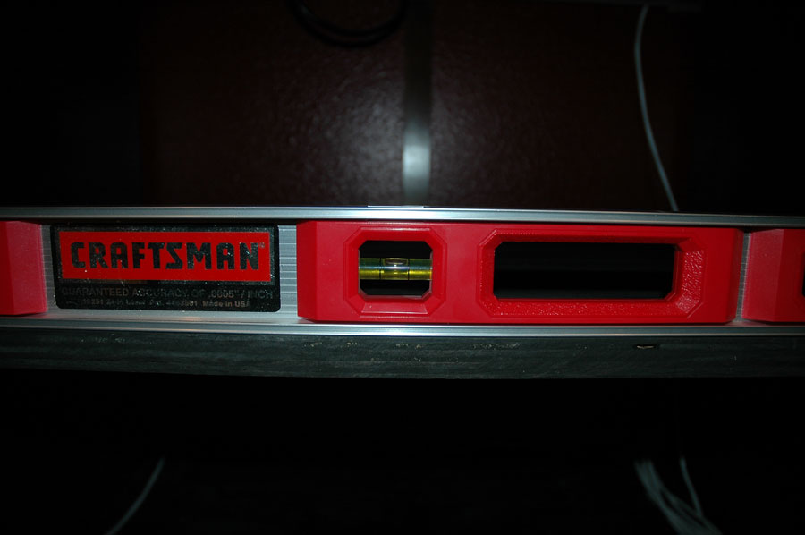

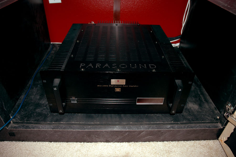

post #330 of 451

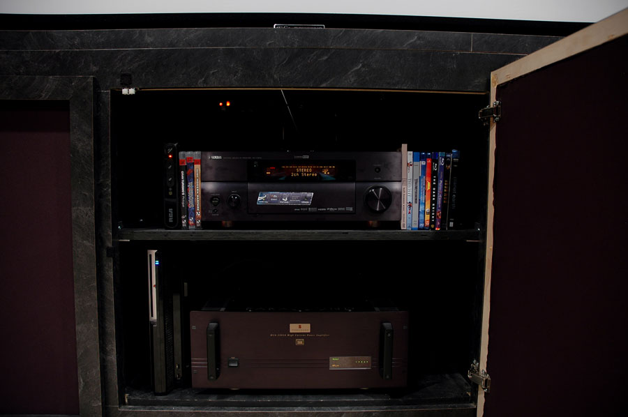

I took more time on it than I originally expected but really like the end result.
The amp states that it needs 6 inches above it for proper ventilation so I mounted my shelf to allow for the 6". I predrilled the hole with a tiny bit to help get the screws started. Once the first screw was in place, I placed my level on it and then screwed the back screw in place.
I know this doesn't impress most of you but it does me. I'm totally not a handyman don't have a lot of tools. For me, this required some thought. I could measure it and drill but I figured that wouldn't work out so well. I decided to place the shelf on both shelves and raise/lower the uninstalled Aluminum Angle at the right height and mark the holes. Removed the shelf and screwed the second rail in place. I was actually very surprised that the shelf was perfectly level.
Amp is in place with speaker cables and RCA cables attached.
Shelf is in place. Again to my surprise, it was a snug fit. Usually I have to recut something.
Even though I was excited to get it hooked up, I spent a lot of time routing and organizing all of my cables using zip ties. I made sure to keep all power cables away from signal cables. Note: After everything was all hooked up, the hum in my sub was gone. I did not think of this when I originally installed everything.
PS3 is now in place as well as my rabbit ears and digital to analog converter (don't laugh, we only watch 1 - 2 shows a year). And the final product.
I'll post my thoughts on the amp probably tomorrow. []
