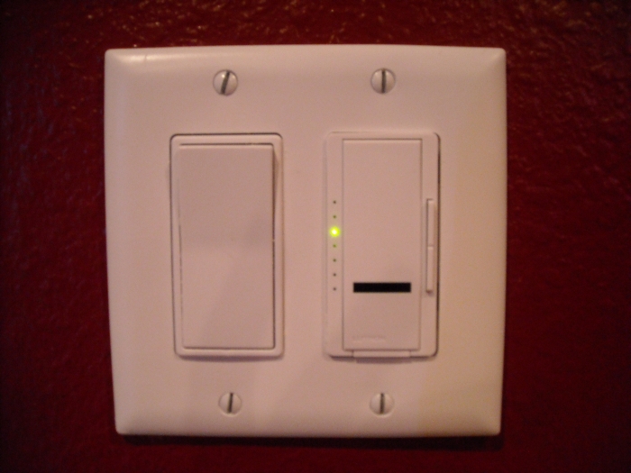

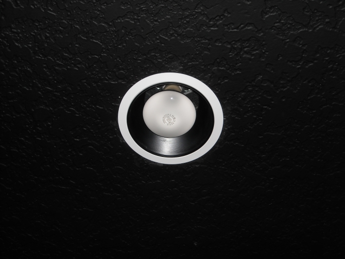

"And God said, let there be light". Well, I wish I could say that we were able to get the can lights installed that quickly but it took me and a friend 5 hours to hang all six lights. This was my first experience installing cans and cutting drywall, it was cool but I had no idea how much drywall dust it would produce. Good thing I covered the equipment prior to starting. We were able to install them without having to go into the attic which was nice. We were able to use the existing power from the center of the ceiling where the ceiling fan/light junction box was installed and daisy chained the cans from it (I think that's the correct terminology for it).
I chose a black baffle with a white trim since the vents in the ceiling are white, baseboards and wall sockets are white. Lowes had an all black one but they were $30 each as opposed to $10 each.
After installing the first three, we noticed one light was about 3 inches off so we had to fix it by moving the hole over and patching the drywall by screwing a cutout piece into a piece of board in the celing, adding texture and repainting the ceiling around it. In the shot below, I still have to paint a few more coats where we goofed (middle can on the right) and install the baffle and trim in the can housing (again, probably not the correct terms but you get the idea).
I picked up a Lutron Maestro IR. It really adds a great touch to the help create the theater room atmosphere. I didn't do much research on it before hand but am very pleased with it. I'm not sure if it will allow me to set more than one preset. I know that I can set the desired brightness, and set a preset for that so that at the touch of a button, it will go from Full on, and slowly dim down to the preset dimmed position. Later when I add sconces, I might replace it with a more capable one that will allow for different scenes with multiple lights on different circuits but for now, I love it. I can finally see what I am doing in there.
