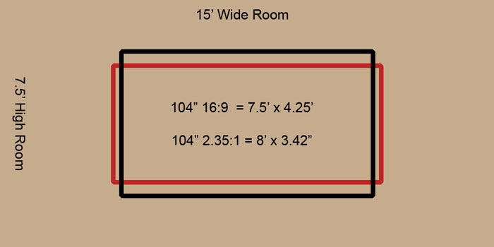

I drew up a mock up using your room dimensions and drawing it to scale to give you a visual of how each would compare. As suggested, if you feel that you are loosing too much real estate with the 2.35, move up to a larger screen (maybe a 110" or 120"). If I had an extra 2' in my room, I would have went with a 110" screen but I would not have been able to toe in my main speakers if I did that and that I could not justify. With you having 15' wide room as opposed to my 13' wide room, I would definitely do the 110" or 120" screen.
The image below is drawn to scale.
The brown color represents your wall
Red box is the 2.35 screen
Black box is the 16:9 screen.
It really depends on what you are looking for and what is most important to you. I personally love the scope screen. Hope that helps.
post #3460 of 4774
Well done youthman!
I love my 2.35:1 screen and it is 115" wide in my 15' wide room...
post #3461 of 4774
