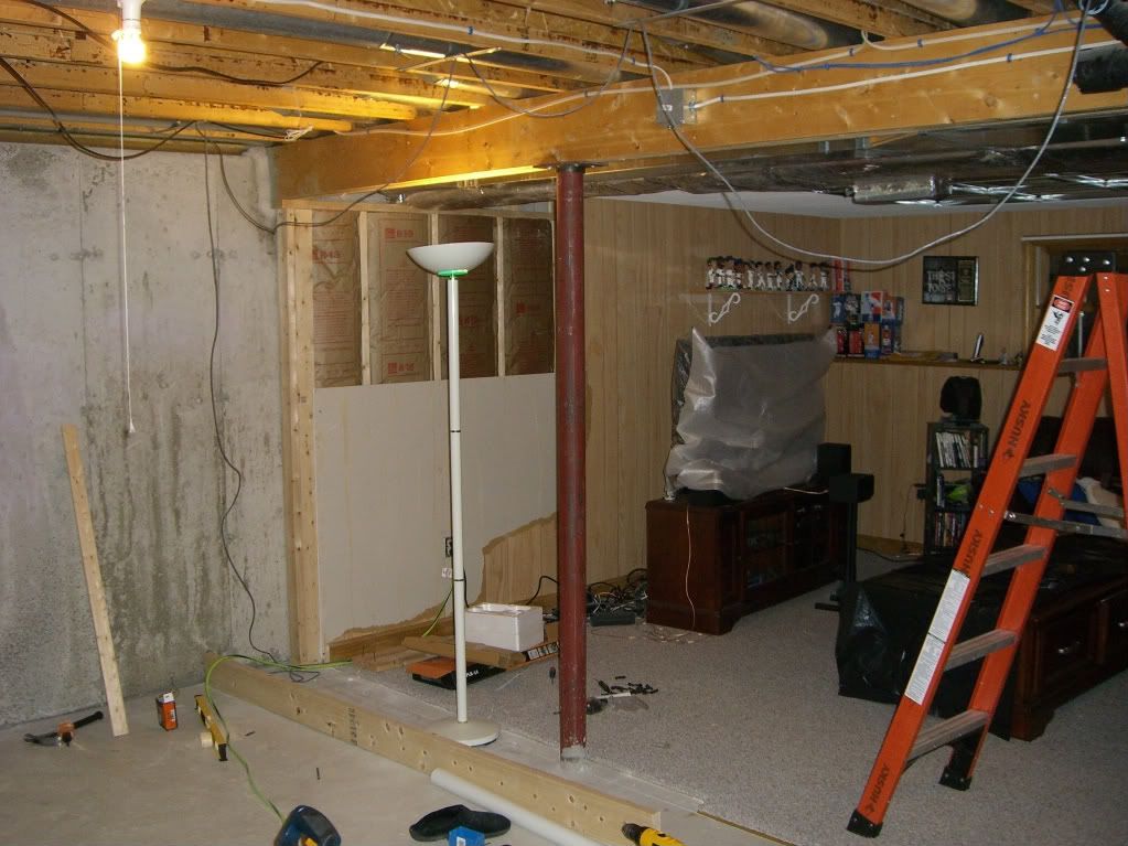

Hi everyone,
Long time reader, and thought I'd post about my new project, and solicit some advise too!
We purchased our home a few months ago, and the basement was "kinda" done, meaning the previous owner had done 1/4 of it (not sure why he broke up a 25 x 18 space, but he did), but it was done poorly (you can see it in the picture below): he only used 1/4" sheet rock, and then used this fake wood paneling over it b/c he didn't want to mud, tape, and sad.
The room was fine for the first few months, but it was small (16 x 12) and had a weird layout b/c of the water heater's location, and didn't really make use of the leather sectional or modest A/V equipment I have (Denon AVR-487 as part of the HTIB, Panasonic 50" PZ77U, Motorola HD DVR, 360, and PS3).
So I tore down the wall that broke up the space, and started framing it out. I had to do it in steps, since the A/V stuff is still there, and I needed a place to game, since I didn't want to pack up my 360 for 8 months while working on the project.
I also need to make the room kid friendly since we have a 4 month old, so my time is limited to a few nights a week and one day a weekend, and I want to divide the space into a play area for her and a TV area for me.
As you can see in the picture below, I've framed one wall, I'm working on the second, and trying to do as much as possible before before I have to move everything out of the room to do the other half.
It should be nice when finished, with the HVAC ducting overhead (as well as the support columns) breaking up the large 25 x 18 space.
The walls on the left and right are / will be framed using 2x4s, but the wall with the TV on it is framed using 2x6s so I have room to run for PVC pipes for the component and HDMI cables (as seen in the picture), and maybe for in wall speakers. You can see where the TV will be mounted to the wall (the mount is just screwed in now as a place holder to make sure my pipes and wires line up).
Under the TV will be the TV(less) stand, where the A/V stuff sits behind glass doors (you can see it in first picture with the TV covered in plastic sitting on it).

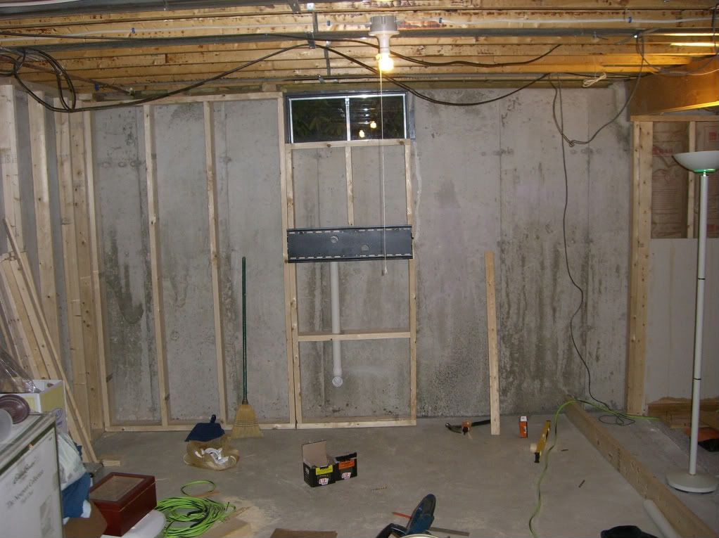

post #2 of 61
More progress today:
I pulled down another section of the existing wall and replaced it with the new 2x6 framing. The previous owner who built this place made a couple of weird mistakes - he used 1" long wood screws to secure the 2x4 frame he had nailed - the only problem is that a 2x4 is 1.5" thick!
Next up I'm going to redo the outlets for the tv, and beneath it so I can have a nook in the wall, allowing wires and power strips to be covertly hidden. It should be pretty sweet!
Then I can start my header / soffit, and then spent a night using the ram head the framing into the concrete once I'm happy with the layout.

My buddy came over today and we made a run to HD.
PTed 2x4s and 2x6s, 32 sheets of 3/4" polystyrene, and some adhesive.
I also spent one night getting this ready:
I needed to pull down the wall and framing to make the room a nice 25 x 18 square space. The water heater will be moving to the other side of the furnace - plumber comes on Monday to move it. Gonna install a pan under the water heater while he's at it, and add a shut off for the hot as well, in case I need it.
