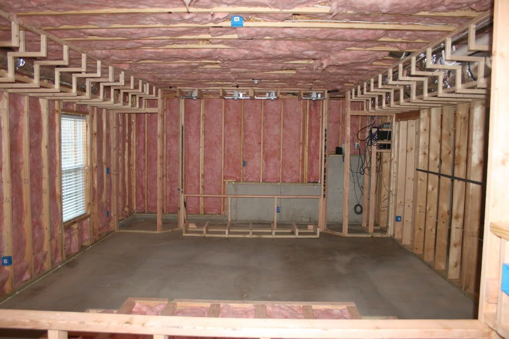

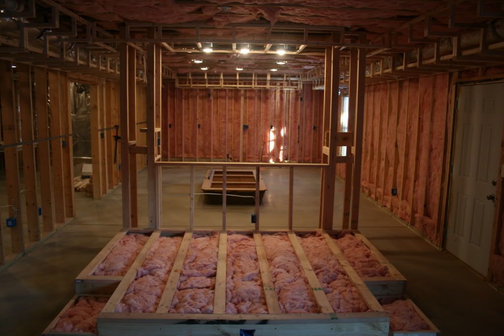

quick update for those who have been following this build. I was able to purchase some more wood on Friday night and continue the theater build. I chose to work on the riser and the bar / columns behind it, so that I could really see the room take shape.
One thing to note, I built the riser upside down, then lifted it and twisted it amd set it back down, so it would be the right side up... and during that time... my lovely, sexy wife helped and ended up breaking her nail soooo bad that it started bleeding. She took one look at it, licked the tip of her thumb and said, do you have anything else you want to lift??? BAD ASS WIFE....
Here are some pictures... sorry for the typos, I am ripped from my Christmas party!!!
View of riser / bar and column(s) from the stage...
Reverse view:

What are the two columns behind the riser for? I imagine the two spaces to the side of the riser will remain open for access to the bar area?
post #36 of 131
The two "aisles" to either side of the riser will remain open so people can easily come and go from the seating area to the pool table... etc. behind the riser I am going to built a little bar top that will have about 3-4 bar stools. The columns serve two purposes.
1. I like the way they look, they are going to really frame the bar area and break up the two main spaces in the basement
2. They are going to allow me to easily run the electrical wiring to the bar and the riser without having to dig a trench in the concrete. I am going to have electrical outlets, as well and AV connections in the column so that you can sit down with a laptop or something and plug right into the system.
hopefully it turns out the way I want it to

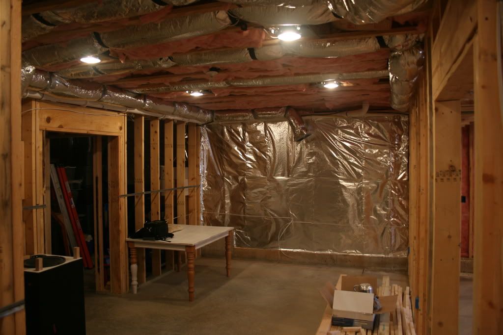

First off... happy new year to everyone, hope you stay have fun and stay safe. Now on to the basement stuff
After Christmas break I decided that I just wasn't ready or comfortable tackling the electrical on my own. I really wanted to say that I did it all myself, but I also didn't want to burn the house down in the middle of the night. So with that in mind I started calling for electrical quotes. I was pretty shocked at how much they were coming back with. Most of them averaged around $5-6000. Then I accidentally called a commercial electric company... and then hooked me up with a licensed electrician in their company that also does residential on the side... SCORE. He came out that day and talked with me about what I wanted to do... and I explained that I wasn't comfortable doing it by myself but I wanted to do as much as I could. He said he would pull the permit, then work WITH me on the electric and just charge me the $50 / hour wage he normally charges. I couldn't have asked for a better setup. After a couple trips to Home Depot, and about $650 in labor... the basement is fully roughed in. All the circuits are in the box and wired... even my new HVAC is wired in. For the most part he handled the home runs, and setting up all the switches... and I ran all the linked outlets and looped the lights together. After a day and half, I am beat and my hands hurt like hell. This guy was really great to work with. After we were finished today and I wrote him the check... he took me out and treated me to lunch, just a fun guy to be around and work with.
I also called around to get a quote for the plumbing to stub in the sink and fridge and found a guy who would do it for it $200 (that includes material). He is the same guy that did the original plumbing on the house... so that happens Saturday. Things are moving forward pretty quickly.
And one last thing, I also pasted the heating and cooling rough in, which isn't a big deal, since I did NONE of that myself.
And now for some pictures. I cleaned up really good, even swept the floor and cracks to make it look good. Can't wait until that is carpet!!!
Here is the now full circuit box
Lights in the game room
View of the screen wall (stage lights aren't turned on in the picture, but they work )
Lights above the bar behind the riser (none of the lights have the real bulbs, just cheap temp bulbs to make sure everything is working)
View of the kitchen wall
Finally looking down the hall to the office
NOT PICTURED
Office light and wiring
Future bathroom roughed in wiring (currently storage room but wired as a bathroom)
Let me know what you think!
