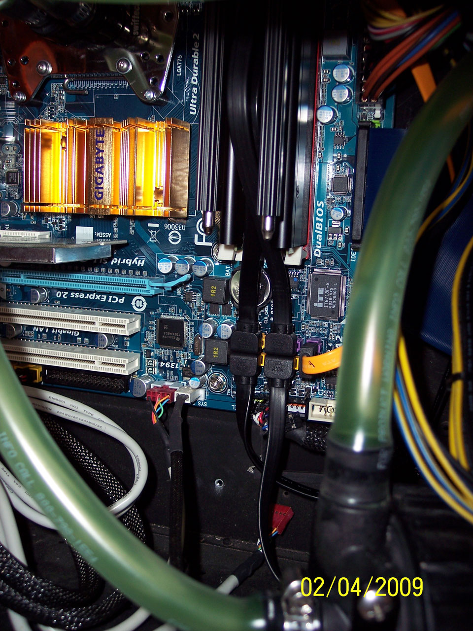

Originally Posted by haste View Post
gtx 260 install shots.
those right to left angle sata cables did the trick...no modification to the heatsink shroud required...
Amazing! Where did you get those right angle connectors? The ones I keep finding still stick out too much.
post #877 of 2834
http://www.performance-pcs.com/catal...ducts_id=22715

Easiest thing to do is just look at any PCI or PCIe card. You will see the bracket is not in line with the card. ATX or uATX doesn't matter, since any card works in either.
Its been a while since I built a PC, several years, but when I look at my old PC the PCI slots and the rear expansion slots on the case do line up decently, not so for the new motherboard.
My big headache has been researching how to transfer my windows XP from an AMD 2700+/nforce2 system to the new E5200/geforce 9400 system, but I'm going to do that this week and I'll report back if I just overreacted about the slots.
Other than that, system posted fine, I ran linux, tried overclocking, the CPU just a tad, temp never hit above 40 C, and the case temp was stable at about 30 C, maybe just winter temperatures, but also due to an ATX case.
