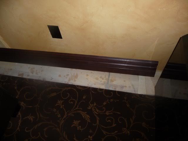

1. I'm going to inlay some hardwood or tile on each side of the carpet. It saved me $800 on carpet by not having to buy extra carpet to match the pattern. I can then hang the base molding.

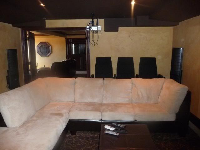

post #76 of 91
Here's a quick recap of the theater.
finished measurements
14'4" wide
17'6" deep
7'8" tall
DD 5/8's with GG
Exterior mahogany doors
Martin Logan speakers
Velodyne sub
Sunfire receiver
Panasonic AE900
Laminate screen
Controlled by a Jobsite IR system
3 zones of Zwave controled lights(front cans(4"), rear cans(4"), sconces)
15" HD lcd used mainly to keep an eye on the kids and watch the front door during movies
Front lights dim on to 20% for 10 sec. when phone rings and rears do the same when the door bell rings.

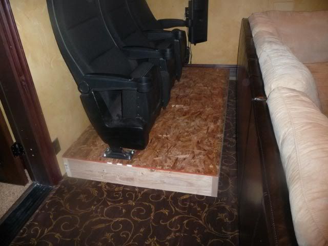

post #77 of 91
How wide is that riser and how comfy are those seats? I'm still trying to figure out what to do with my back row and I'm leaning towards a riser with those kinds of seats.
Nice HT and basement, btw. I love your stain color and wood choice.
post #78 of 91
78"x44" I think there comfortable. Better than I expected.

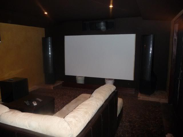

Mounted my screen and decided to add some rope light behind it. It doesn't look as cool as the picture looks. I used a night setting on the camera and it came out cool. You can't see the light shining through the laminate with your eyes but some how the camera picked it up. I still need to frame it with velvet but before I do that I want to investigate some diy masking.

I got my screen border up. I used 3.25" mdf and covered it in Madonna black velvet.
