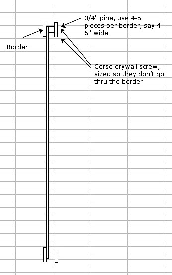

I'm at the border stage now with my DIY screen, what I've bought but not used yet is 1 x 6 PVC base board trim from home depot, I plan on ripping it in half via table saw for a real 3/4" x 2 3/4" stock for border. I'm wrapping mine in black velvet and will use ind strgth velcro. It will have 45 miter ends, I've toyed with the idea of taking a router along the inner edge for a bevel as well, I will try that on a short/scrap piece and see how wrapping that goes. I think a inner bevel edge will give that high level PQ look.
Masking, I'm doing manual as well, but can I ask why the heavy duty MDF panels?
Why not some foam core board from a craft store? Much lighter. Honestly that's my image, I've seen that stuff at work so I'm sure it's available.
I also have leftover rare earth magnets, so same as you they will be the attach method to the border (put the magnets in the border prior to velvet, all same side polarity).

I also like the idea of using a baseboard for the border. I was going to cut an edge on some kind of wood before wrapping it, but I imagine you could even find a baseboard already in the right shape and not have to cut or use a router to make it look nice. I see you're planning on velcro, I just wasn't sure if a 1'' strip of velcro would sufficiently hold a 3'' border "flush" to the screen. I'm not afraid of the borders "falling off" or anything, but I would think there might be a visible gap on the top edges where the velcro wasn't touching, particularly if you figure gravity pulls the bottom down and pulls the top away from the surface, if that makes sense...?
Thank you for both of your suggestions and please let me know how your borders and panels turn out when you get done. I won't be starting my project until early next year but eventually I hope to post pictures of the build.

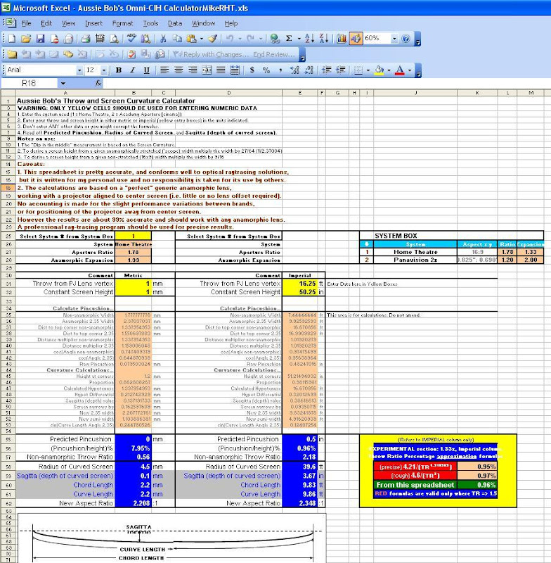

As I said before I'm new to the calculations of front projection, but is there a formula to calculate amount of pincushion distortion based on throw ratio? Then based on that it seems you calculated you would need a 3'' curve depth to correct a 1/4'' pincushion... is there a formula for that too? That would be great information for when I do try a curved screen, even if it's a few years down the road. I haven't been reading as many curved screen threads as I have flat screen threads, so I apologize if that stuff is "common knowledge" around here .
Do a search on AussieBob and his threads, he PM'd me an excel sheet that did the calc for pincushion based on many parameters.
I'm not the "owner" of that, so I won't PM you it.
post #14 of 57
Yes AussieBob's spreadsheet is definately the easiest (much easier than calculating yourself!). We all owe Bob a beer for that one!

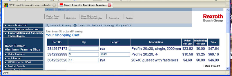

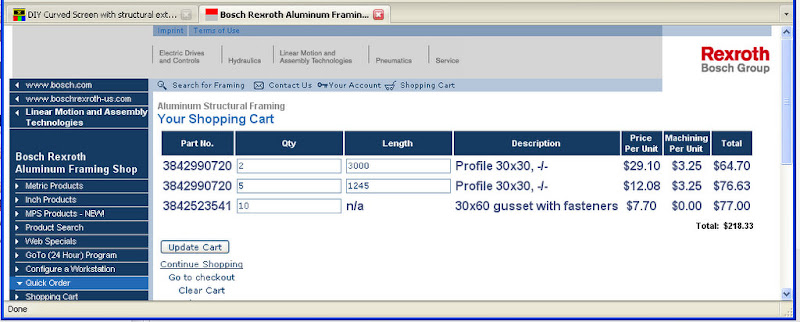

Just for reference, I used the Bosch tubing, and have online quotes for 20mmx20mm and 30mm x 30mm. (these are public figures directly from their website)
Your prices seem comparable. The Bosch stuff is used extensively in industry for fixtures/jigs, it's very rigid for it's size, and easy to attach stuff to with it's channels/grooves.

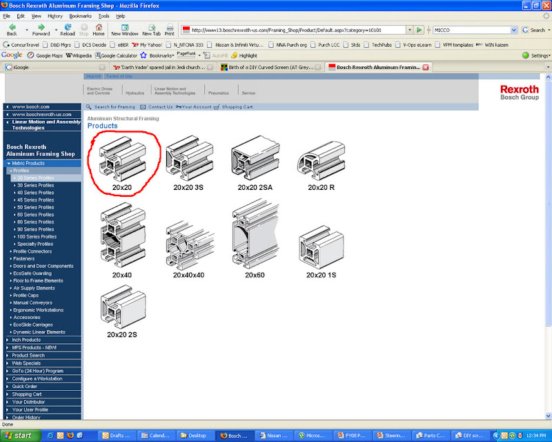

mtbdudex I've read through your thread and I did look up the aluminum that you were using, specifically the 20x20 profile. To be honest, I'm not very mechanically inclined (I'm a computer/electronics person ) and it was boggling my mind what to do with those profiles and what kind of connectors you need to fasten them. It just didn't look as simple as:
1: Insert connector into end of tube
2: Bang with mallet
3: Rinse & Repeat (Wow I even discovered the missing step 3!)
4: Profit!!!
Then beyond that I was concerned about attaching velcro to those profiles because of the channel in the middle. Effectively the adhesive on the velcro tape would have 1/3 less area to adhere to.
Now maybe a profile like the 20x20 2SA would be interesting. I didn't see those in my first glance but I can imagine the flat sides pointing away from the screenwall and "out" from screens center, with the channel sides pointing into the wall and "in". That would give me a flat surface to attach velcro to, and a flat surface around the perimeter as seen from the outside (cleaner look IMHO), but leave the channel cut sides inside where they might be used as french cleats or for other mounting methods. Sounds like it would work well, but the whole "how do I connect these together" thing was still bugging me. I've figured it out by looking at their site that the conenctors are really screw-in brackets of sorts, so it's definitely different than the method used on tubes... Are there advantages to this type of profile and connectors? It looks more secure? Just not sure if it's worth the extra labor and expense.

In Mike's thread several folks used the T-slots to secure fabrics to their T-slot frames;
"cubesys" (Itai) used wooden dowels press fitted in to the tracks to hold his AT fabric (posts 12, 13, 16 & 20).

Originally Posted by HDGTX View Post
Magius,
"Nasty N8" used rubber hose (posts; 24 & 31).
"GetGray" used Bosch channel covers to secure his BOC fabric.
Bosch also sells the T-slot tubing with some of the faces smooth as well, you could then velcro your surface
to one of those, while using the T-slot sides for fastening or hanging. Think the smooth side pieces are more expensive.

Magius;
Just giving you different options, I'm sure as others have found the tubing you plan on using would work.
As John pointed out a couple of easy ways to attach the screen, plus if you are really set on velcro then you can get the profile with one side smooth.
The corner braces really contributed to the out-plane stiffness of the frame, and they went together so easy. I'm not so sure how the other sq tubing get's it's out-plane stiffness.
Sub assemble the corner gussets:
drill holes in the top and bottom member for Allen wrench tightening of end screws in the 5 vertical members.
Attach corner gussets, once or twice I was not sure it locked correctly, so I used a finish nail to "hold" it while initially tightening it, that worked and ensured 100% correct alignment:
Anyway, what's important is you feel comfortable/confident in your project.
The Bosch tubing also worked for me because I was able to mount the wood blocks to it and the extruded x-section gave a perfect center to drill a hole and shoot screws consistently @ exact center of tub, no drill "walking" on squirrely alum surf (or pre-hit with a center punch).
Good luck, I'll follow your project soon to be fellow 2.35:1 'er!

How about this as alternative for mounting your border, create a sandwich.
Attach the border via screw from backside, basically what I did.
Should work, and you could even make two of the top backside pine pieces into french cleats for hanging yoru screen at same time.
You'd need some hand clamps to hold the assy in place while you screw it.
(quick sketch via excel and drawing tools there)
