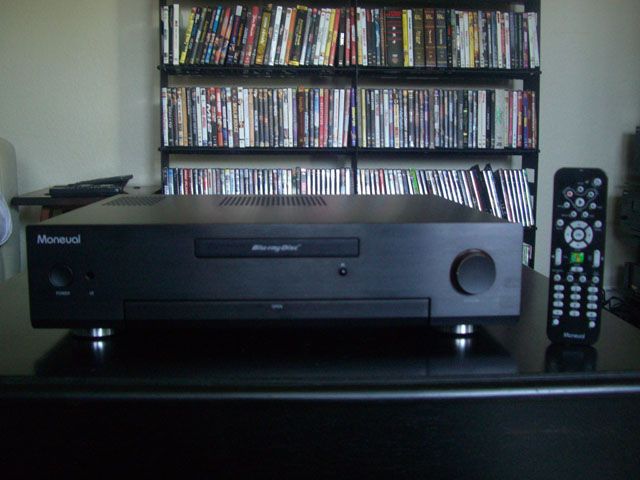

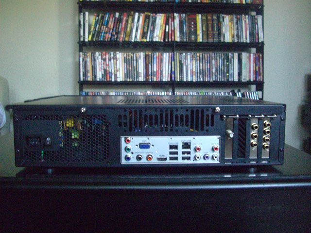

Firstly, thanks to those who have given me advice during my build.
I built a HTPC based on the MSI Diva 7.1 board. Mainly for the onboard component video for my RPTV. I opted for the 7.1 board, because I will most probably be using an A/V receiver now and in the future. I used an AMD 5050e CPU and an AverMedia Duet Digital Tuner. The standard LG Bluray/HDDVD combo drive and a 1TB WD Green drive. The HDD was DOA (bummer) so I used a WD 160GB I had handy.
Got my components for NewEgg and the case and 40mm fans from FrozenCpu.
Here are a few pics of my setup.
Google Album of my pics.
http://picasaweb.google.com/mchrists...eat=directlink
I had some issues getting a few things going, but all is working right now. I still need to setup Bluray/HDDVD playback, but my HD OTA, DVD Library and other movies are doing fine.
Thanks goes out to the guys over at the "MSI 7411 sneak peak" thread (esp. Don)
Thanks again to everyone.
Michael

Very nice. It looks great in black too. What sort of temperatures are you seeing?

Just occurred to me I hadn't posted a picture of what mine looks like with the TV tuner installed. The pic below still has the stock Intel HSF which I have since replaced with a Scythe Shuriken.
It really is pretty packed.
I think there is a real danger of the Xonar HDAV Slim audio card I'm planning to add not being able to fit without hitting the CAM module that sticks out of the FloppyDTV tuner.

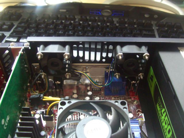

Here are the case fans I added.
Yes I know the screws don't match, no mounting hardware came with them, so i havd to improvise. I originally had them pulling air out, but I turned them around to push air in.
They are running at 4500 rpm (50% or so) and are barely audible. At full speed they are jet engines and actually push a lot of air (18cfm).
I am using speedfan to control the speeds to see how things go. I don't let them get about 60% as they become anoying. I may switch over to the bios PWM control, don't know yet. We will see.

The Shuriken works great. There were no clearance problems with it, neither horizontally nor vertically. It never goes above 1,000 rpm in my system even when I play Blu-rays. Recommended!
I have two Adda 40mm fans pushing air out the back - I think they are 10 mm thick so much smaller than the ones mchristsen are using. They are completely inaudible from my viewing distance even though they are running at 12V.
The fact I have an active cooler on my GPU definitely helps airflow. My case is just lukewarm to the touch even when running high loads on the processor. Now I have an E5200 which runs very cool and uses little power, and I also have just one 2.5" hard drive. The TV tuner does generate some heat though.
Basically all I can hear is the PSU fan - which isn't particularly quiet in the cheapo PSU I am using.
I have 40mm x 28mm fans and at 100% they are loud, but push a tremdous amount of air. So i run them between 48% - 55%. They are inaudable while viewing at my 10' viewing distance. The stock AMD fan for the 5050e runs at 2500rpm (80%) most of the time. Even at 100% / 2900rpm, you can't hear it. I had them pushing cool air int he case, but turned them around today to pull air out. I might have had a screw loose, because they are quieter than before.
The Corsair PSU is slient and has a larger clearence gapto the ODD than other PSUs I've seen (due to it being shorter). Also the stock CPU fan does not cause a problem.
I don't truely trust the temperature and fan speed reporting from the Board/CPU. E.g., the 5050e reports a running temp of 19C. Considering the Heatsink is warmer than ambient (touch), I am not sure this is so. Also the SYS1 and PWR1 fan headers report two different speeds of the 40mm fans, set at the same PWM level (even in bios).
All minor things! For those new builders out there, do research your heatsinks, PSUs, memory height and ODD.
