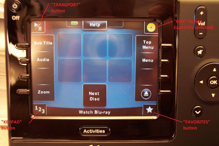

post #1049 of 2021
sethm1,
When your in an activity that uses a numeric keypad, i.e. watch cable, there will be a soft button on the bottom left of the screen that will display 123. When you press that button it will bring you into the numeric keypad. Likewise, you go back to the cable DVR screen by hitting the upper left button which displays a play symbol.
post #1050 of 2021
^^ Exactly as oman describes. The four corners of the screen have the buttons for the four different subscreens. For each activity, you can make one of the four subscreens the default one that displays automatically.
For our setup, any "Watch DVD"-type activity (Blu-ray, HD DVD) has the transport subscreen be the default. For "Watch HDTV" activity, I have the favorite channel icons as the default subscreen.
And for really crazy customization, those eight (4x2) sidebar buttons can be programmed differently for each subscreen of an Activity, if desired.
The pic below (from a few months ago) shows a typical layout. Ignore the main section of the screen - this was when I was just starting the programming. I will upload my current screen layouts sometime this weekend so you can see the transport screen, numeric keypad screen, etc.
Hope this helps!
