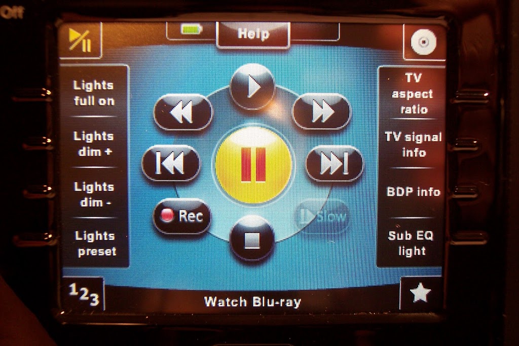

I use the Lutron Maestro IR dimmer with the Harmony's RF extender - works just fine. The dimmer switch is about 15' or so behind the couch.
I'll eventually add a second dimmer to control the lights in the adjacent room. Luckily the two dimmer switches are next to each other, so the current RF extender should work just fine.
For most activities, the four left-side buttons are programmed to work the lights:
Full on
Dim +
Dim -
Preset
Perfect for our needs!

Originally Posted by mak99 View Post
...I will upload my current screen layouts sometime this weekend so you can see the transport screen, numeric keypad screen, etc.
Full on
Dim +
Dim -
Preset

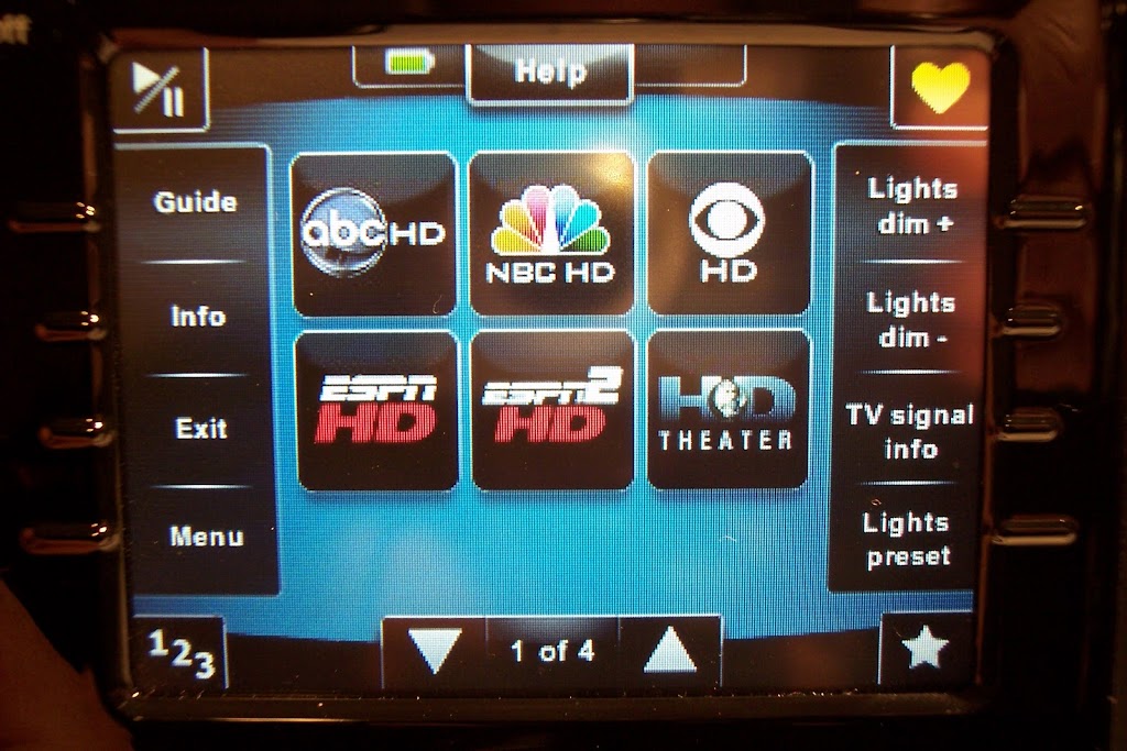

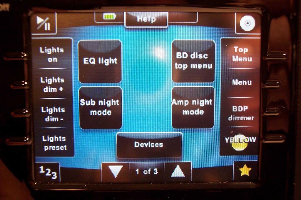

Below are the examples from the above discussion - the first one is the default Transport controls subscreen for "Watch Blu-ray" activity. You can see the four lighting control commands on the left side, which are consistent for all four subscreens:
^^ The "Record" button is active as I've programmed it to toggle the light for the Velodyne SMS-1 sub equalizer. Obviously the Oppo BDP cannot record...
The next pic is my Favorites subscreen under the same Activity, which I'll add the sub EQ volume up/down to the blank area in the middle (currently on page 2 of this subscreen):
^^ I just noticed my inconsistent labeling for the "Lights (full) on" buttons! Oops...

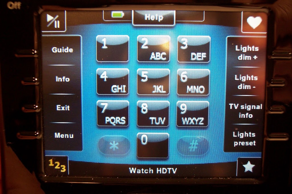

This next pic is the numeric keypad for watching HDTV:
...along with my default subscreen of "Favorites":
^^ You'll note that the lighting control under the Watch HDTV activity is now on the right side. I put the STB menu controls on the left sidebar, since that's what is used most under this Activity.
