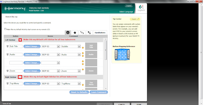

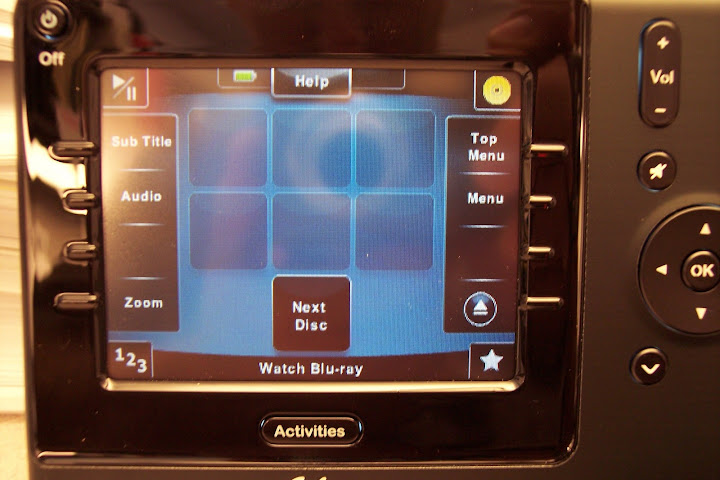

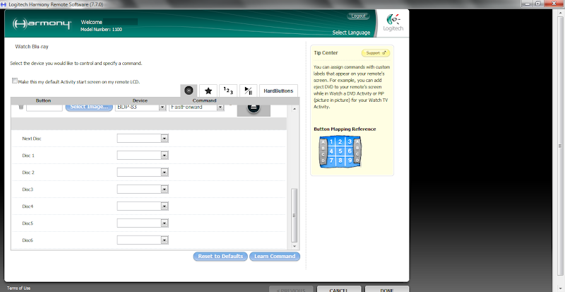

First, thanks to everyone for posting great tips and troubleshooting tips for this remote. I recently purchased an 1100 to replace my current One, but still within my return period in case I find any fatal flaws...
Question on "Watch DVD"-type activities: I have set up two for both my HD DVD (Toshiba XA2) and Blu-ray (Oppo 83) players. Under the "circle" subscreen during the programming, the main (center) display area has default options for "Next Disc, Disc 1, Disc 2,...Disc 6". I don't see any way to change these to anything else. See the pic below for my screenshot:
These choices seem pretty worthless since both of these players are NOT multi-disc players. Note that the pic above is specifically from the "Watch Blu-ray" activity; the "Watch HD DVD" activity is the same. After updating the remote, the seven buttons do show up, but are greyed out since they had not been assigned by me.
To troubleshoot, I assigned the "Next Disc" button as the BDP angle button. After another quick update, that button was the only one of the seven that was now active, but the button label still read "Next Disc". See the below pic for the change:
Again, mostly worthless for trying to assign these buttons as anything useful.
So - am I missing something here regarding the default multi-disc commands for a single-disc player???
I am running the latest software (7.7.0), and have updated the firmware to 7.6. My computer is running Win7 Pro. I just ran thru the firmware update again this morning, and got the "Firmware Update Successful" message on the 1100's display.
Don't get me wrong about the above gripe - I think the 1100 is a nice remote overall, though it'll take getting used to not having hard transport buttons like the One. And since I already own the RF extender that I bought some time ago with an 890 Pro (both still NIB), the 1100 would allow me to remotely locate my AV gear in an adjacent storage room, whenever that project might happen...
HEY, LOGITECH!!
Here's a nifty idea: When programming the four subscreen layouts, it seems like most people (like myself) want to have the left and right sidebars be the same for all four subscreens for a particular Activity. How about adding a toggle button for making this an option so we don't have to edit all four sets of sidebars to be the same? See pic below as an example:
Just my two cents...

mak99,
I don't think you're missing anything...my BR player is also a single disc, but I never even bothered to touch the disc subscreen. I made the default subscreen for the activity the 'transport' screen (with play/pause, etc...)...
I'm with you on the sidebars...within each of my activities has the same side bar commands on every subscreen...it was annoying, but it was only once that you have to go through the (more than necessary) setup

W/A - thanks for the reply. Like you, I have the transport subscreen as the default for my Watch BD/HD DVD activities. It would just have been nice if this other subscreen was a bit more customizable.
And if you still have some influence over at Logitech, feel free to pass along my suggestion on the default subscreen checkboxes!
