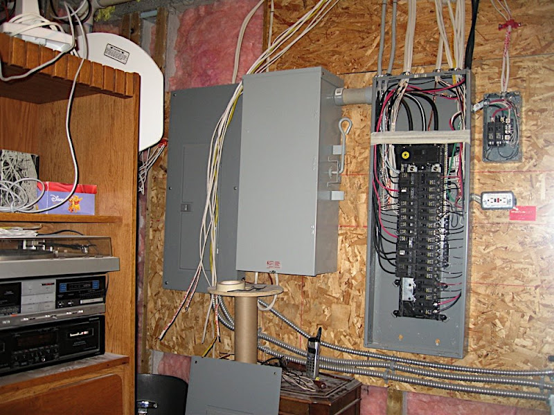

Just had an electrician out to install a 100amp sub-panel. My main breaker had no slots left. The new one will be just for the HT.

I hope your Electrician is qualified?? He should have pulled a ground wire in the conduit to the panel because
1. He is using raintight couplings insted of set screw type couplings to join the emt.
2. He goes into a PVC Lb before entering into the panel.
He should make sure everything is grounded and bonded to be at the same potential. Using PVC and EMT does not constitute proper bonding.
Essentially your new panel isn't at the same potential as the feeder panel, and any plugs that he runs from the new panel won't actually be grounded.
Just something I noticed.
He is an electrician by trade. As far as the different pieces of conduit, he said he saved me some money by using parts he had laying around. I dunno, hope that kinda answers your questions. I only know very basic electrical.

Yes, as long as he has a ground wire between the main panel and the sub panel, everything will be at the same potential. In your pics I was only able to see the red, black and neutral wire, in the conduit.
post #20 of 258
Told you I don't know squat! I didn't even notice. Now I'll have to investigate tomorrow.

Good job on the plumbing. Did you find out about the ground for the panel, dragodrago is correct about that ground. From the pic as far as I could tell the black is definately not the ground. The ground would need to be wired to the area where the white wire is or on the opposite side. Good luck.
post #24 of 258
Haven't had a chance yet. Hopefully today.

Jailguy;
+1 on the concern of no ground in yours , I ran 14 new circuits when I did my whole basement,tapping into existing panel and added a sub panel.
See my pict? Green is ground.
If you don't want to learn basic electrical 101, you need a competent electrician for your safety.
What size wire did he run for 100amp service?
Minimum size wire for a residential feeder is #4 Copper wire, or # 2 Aluminum wire, for hts and neutral. That wire does not look thick enough, hard to tell.
200A panel on LH is my Geothermal/hot H20 seperate panel, panel on RH 200A home, with a transfer sw for back-up generator.
btw, your theatre plans look nice, have fun building it.
post #26 of 258
He used 3 gauge wire.
post #27 of 258
