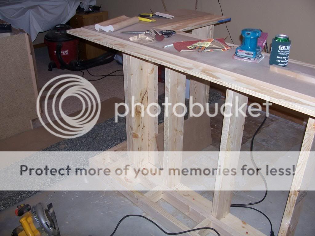

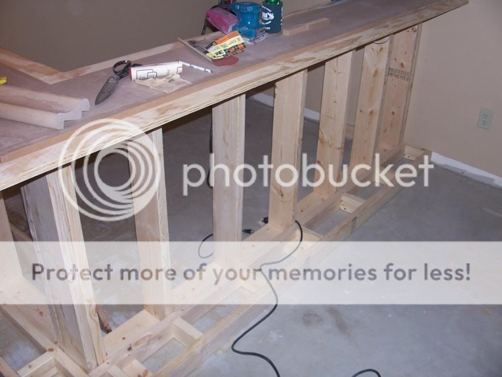

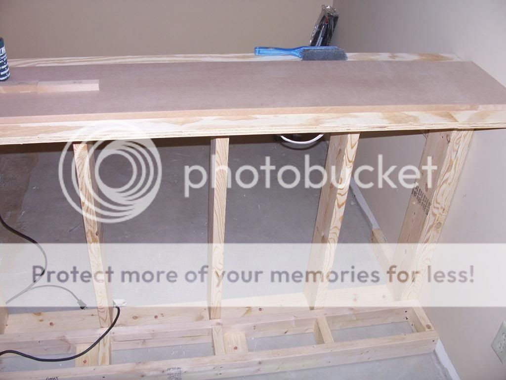

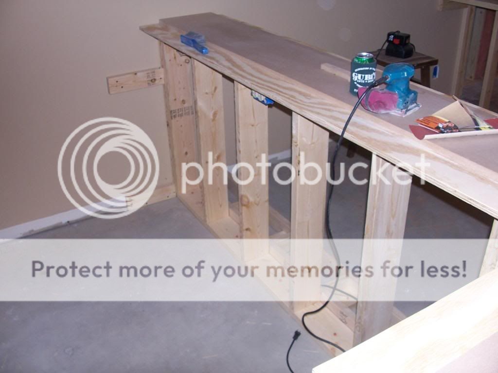

More progress-Half wall bar from front(theater side of the room)
Now on to the bar.....As you can tell I tend to forget to take pics but thats because I am working.....lol I went with 2x6 framing over 2x4 for the "strurdiness factor" And it helped
The top layer(MDF) is just laying there for visual purposes. The first layer is 3/4" sanded ply with 3/4" MDF on top
Once I framed out the footrest/step it really added strength to the structure. I then cut come 2x4 scrap to attatch to it then to the concrete....This baby aint goin nowhere
Behind the main bar
Behind the bar looking toward the half wall bar

Steve, looking good brother.... Question, Where is your electical coming from to go behind the bar ? Don't see anything coming through the wall or through your studs of the bar? just curious.
post #65 of 1361
Not in this pic but in pics to come. I actually took a pre existing outlet that was in the wall almost where the bar is and ran it through the bar framing to 2 spots behind the bar. That wall the bar is on actually sits about 16" away from the foundation wall so I got to crawl behind there in all the insulation and cobwebs and un wire and fish the wire through there. FUN FUN
EDIT:
Actually 2nd pic from the bottom you can see the one outlet sideways near the bar top. I then piggy backed off that one for one down lower for the fridge
post #66 of 1361
EDIT:
I saw the box but couldn't figure out where the wire was coming from. You must have it high to the top of the bar and through the wall.
