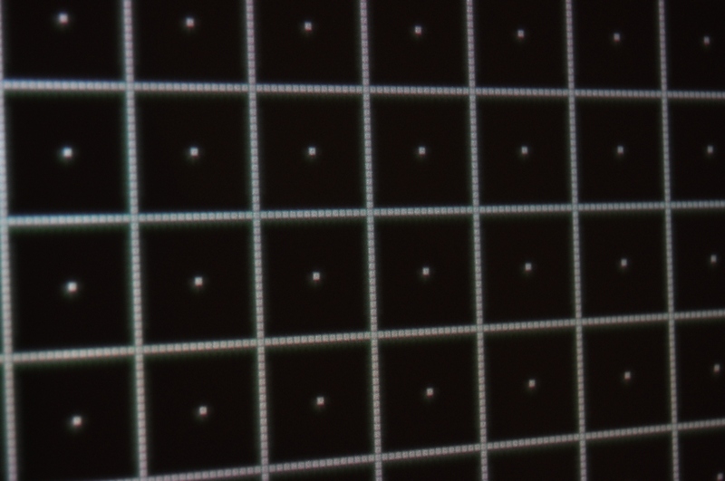

FWIW, my opinion is there is no excuse for it not being possible to clearly see the pixel structure when properly focused on any 1080 single chip DLP.

Here's a shot of my X10. Much tighter pixel grid, but more CA. Interesting. The X10 definitely appears sharper on the desktop though.
http://www.yellowzonker.net/2012-05-02_19-44-22_282.jpg
Once again, taken by my phone, so it is even better defined in person.

This is about as good as I can get mine. The pixels are fairly visible, but I still get that odd light spill. I can see a little bit of it in Zombie's image, but obviously mine is considerably worse.
post #2284 of 2383
Yep, mine is exactly the same. Both with W6000 own grid and with AVS grid it looks pretty much the same.
I haven`t noticed lens shift position or zoom ratios to have any effect on it.

Yea, I don't think that's just a focus issue. You can see the pixels fairly well defined on mine, even more so than in my image. If you look closely, you can see it in Zombie's image also, just not as much.
I was hoping someone else might jump in and give some explanation as to what causes that effect???
Also, the chroma isn't as bad to the naked eye as you see in those images. My phone's camera seems to over emphasize it. It wasn't nearly as apparent on my X10 as the image I posted above. But zoom level definitely affects the amount of chroma I see on the W6k.
My pure guess is it's the lens assembly tolerances. Most lens are far from simple and the mounting of each lens has to be spot on to keep the image focussed. Lots going on...
The optical elements of a typical, single-DMD-based projector include the lamp assembly, a color wheel, a mixing rod, relay illumination systems design, and a projection lens (see Fig. 1). The mixing rod performs several functions. First, it transforms the spatial distribution of the source into a more uniform spatial distribution for even illumination of the final screen image. Second, it transforms the round shape of the source output distribution into a rectangle with essentially no loss, thereby matching the aspect ratio of the DMD being used. Finally, tapered rods can be used to increase the apparent size of the source while simultaneously reducing its angular extent, matching the illumination cone angle with the projection-lens acceptance angle. Mixing rods can either be constructed from a solid transparent dialectic, which utilizes total internal reflection, or as hollow tunnels with mirrored sides.

I went over to the W7000 forum and Zombie's photos shows exactly the kind of sharpness I would expect. My AVS HD title screen looks much softer than Zombie's. I know the W7000 is technically a different model but I am pretty sure the 2D is very similar to the W6000.
Here are photos from my W6000 on the projector cross hatch (right hand side, not center of screen) with the best focus I could get. The blurriness on the sides of my photo is due to my Canon 50D DSLR @ f2.8 and camera focus on the center vertical line. I was trying to get clear, discrete pixels like in Zombie's but could not. And the weave is because the screen is Seymour Centerstage XD material.
W6000 cross hatch
W6000 playing AVS HD disk.
Just an update on my sharpness issue. I upgraded to a BenQ W7000 and the unit seems good. MUCH SHARPER! The projector cross hatch pattern is "thicker" than the W6000 so I won't compare to that as it would not be apples to apples. I haven't examined the AVSHD disc cross hatch pattern yet but overall, blu ray looks much sharper now. There was definitely something wrong with my original W6000.
