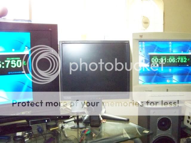

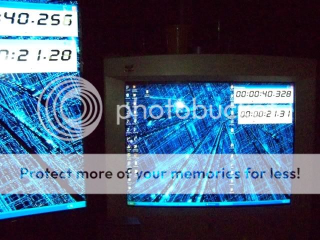

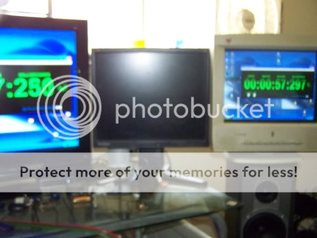

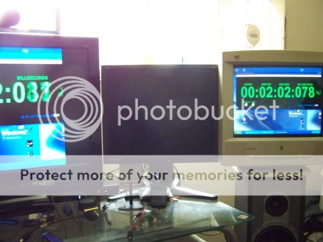

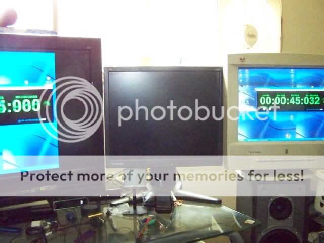

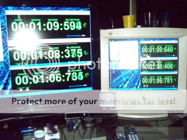

The purpose of this thread is to Test your HDTV for Input lag VS a CRT display or a fast LCD monitor that has been tested by someone or yourself google for reviews and report back the results with pictures as proof of the results
These tests can never be more accurate than 1 Frame (16ms) and will never be completely accurate as there are many variables when doing these tests including but not limited to, your camera and its settings, your video card and its drivers/settings. LCD blur getting in the way of Clear readings etc. Due to this I will be posting summarized results in this Post of each TV tested and the Measurements will be in Frame Delay with one frame equaling 16ms.
How do I test my TV for input lag?
First you need a PC with a video card that has dual outputs
hook up the TV and CRT monitor to your PC's outputs
Set your video card to output in "Clone mode" so the same image is displayed on both screens at the same time
Get a Digital camera with a high ISO setting (ISO 800 is often the best setting) If it has a shutter delay option set it to 1/60 so they CRT and LCD will both be clear to see in every picture, if this is not set the CRT will have a rolling Horizontal Dark line as you can see in many pictures I've messed up for you below
if your testing with both displays being LCD you can rasie the shutter speed as high as your camera will allow to get clearer and more consitant results
last step is to go to the webpage in the link below in Rule #1 and scroll down till you find the Input lag timer and once you got everything setup the way you want it and camera ready to go, hit start and start snapping photos
post the pictures here with a summery of results if you have time to figure that out (frame delay is more important than figuring MS differences)

when using this program you always want to take the highest visible number on both displays to use to draw your input lag result and if you do this you will end up with very consistent results. its extremely accurate

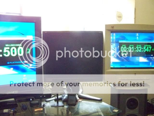

Panasonic 32" LZ800 HDMI 1080P IPS-Pro panel
1080P Standard mode
0-1 frame delay
1080P Game mode
0-1 frame delay
480i Game mode
1-2 frame delay (closer to 1 than 2 but definitely a bit more lag than 1080p)
notes: this is one the very fastest LCD TV's ever tested, would love to see what panasonic's current TV's test at, it should be around the same as these models. Tested by Mr Deap
LINK TO PHOTOS

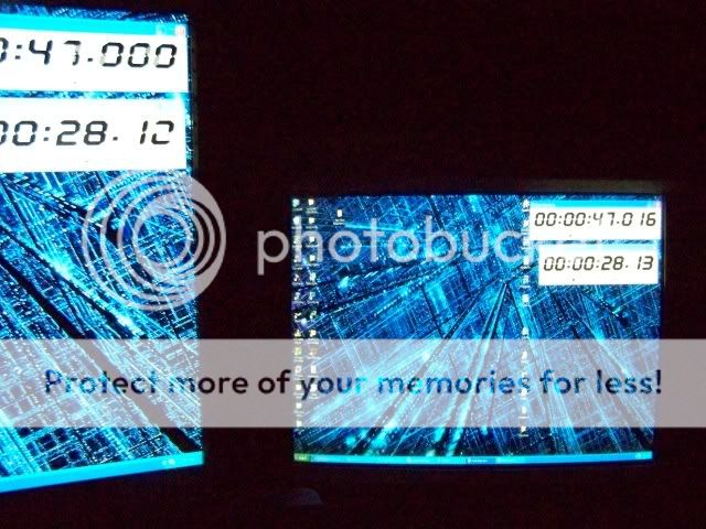

Panasonic TC-L32S1 IPS-Pro panel
1080P HDMI
0-1 frame delay in game mode or out does not matter
notes: was tested vs a CRT monitor with an average of 14ms delay of picture with many displaying 0 ms delay, one of the best gaming TV's today for sure, the smooth motion feature appears to just be a scanning backlight and does not impact input lag but appears to show some visible flicker. Tested by hidefLoans
LINK TO PHOTOS

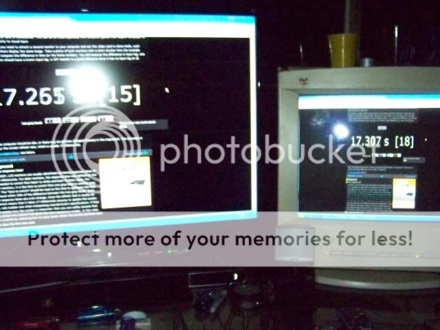

Panasonic TC-L37S1 IPS-Pro panel
1080P HDMI
0-1 frame delay just like its little brother
720p HDMI vs CRT
1 frame delay (13ms) very good result for a non native resolution
notes: this is my new main PC monitor, text is not perfect 100% of the time. these Panny TV's have a strange problem with displaying red and blue text ONLY on dark/black backgrounds, text otherwise is very good once you get the picture settings set right and running cleartype tuner in windows helps some more as well. optimal Sharpness on these Panasonic's is 0-10 at most, the sharpness setting adds edge enhancement at anything over 0. Tested by Myself
LINK TO PHOTOS

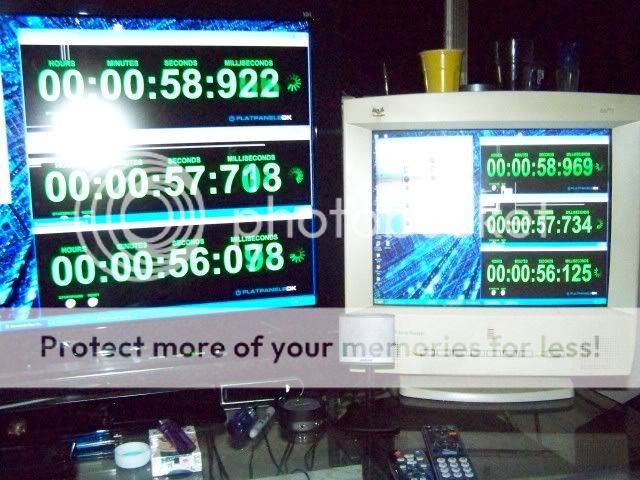

Panasonic 32" TC-L32X1 (720p) IPS-Pro panel
720p HDMI vs LCD monitor tested to have 2ms lag
0 input lag
notes: this is a very well done test using a good camera and can show how consistent your results can get once you have a good camera setup correctly for these tests. very good job Saiyanjin2. If you take a look at the you tube video in his post and you pause it you can see that the rotating frame ticker to the right of the counter is actually AHEAD of the TN pc monitor indicating that the panasonic is slightly faster than the TN in pixel response time! Tested by Saiyanjin2
LINK TO PHOTOS
Here's a youtube video of his tests

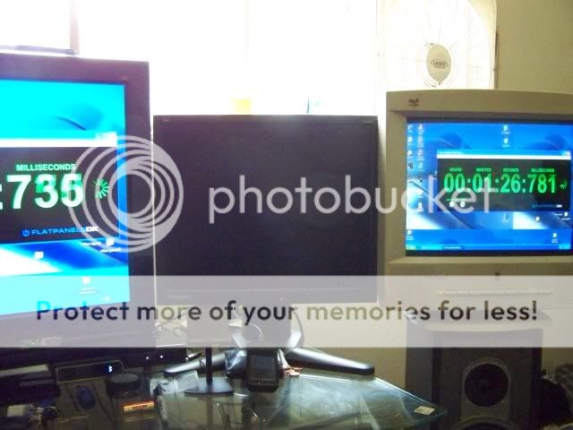

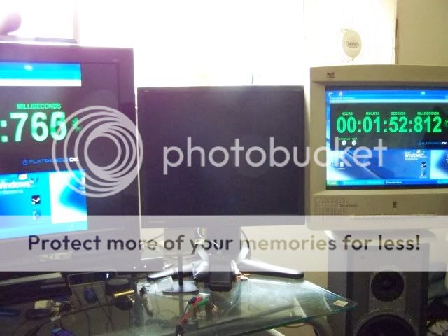

Sony 32XBR6 (jan 09 build 205r FW) vs viewsonic 17" CRT monitor
1080p HDMI input on all tests
Photo mode (game mode is disabled in this mode)
Video mode W/ Game mode ON
Video mode W/ Game mode OFF

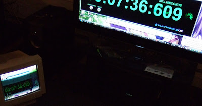

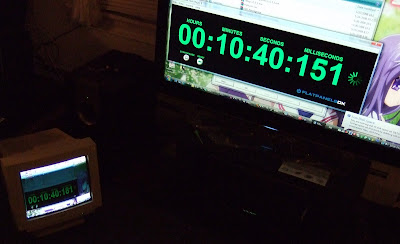

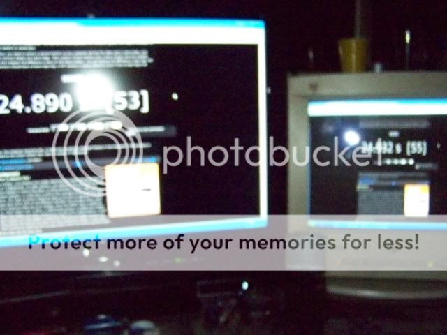

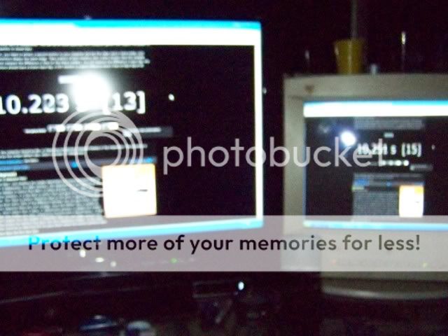

Here's my tests on a lowly Samsung 46A550. My CRT is old and can't do 1080p, so I ran these tests at 1280x720 (720p). My video card was set to clone, TV was connected through HDMI while the monitor was VGA. Both had the same resolution and refresh rate (60Hz).
I'd like to emphasize that these tests are at 720p, so the TV has to do scaling! I'd imagine the results at 1080p would be better.
Summary:
Normal mode: ~2 frames (30ms)
Game mode: ~1.5 frames (25ms)
PC mode: ~2 frames (30ms)
Input lag in normal mode is about 30ms, give or take maybe 5 ms. Here's a picture:
When I activated game mode, the input lag dropped a little less than 10ms. I'd get some pictures showing 20ms of lag, and some showing 30, so let's split it down the middle and say 25ms with game mode.
The numbers are 629 and 609, I didn't realize it was so small when I resized it .
Naming the input PC made a tiny difference, but I couldn't capture it.
It's 181 (on the CRT) and 151.

Guys can you please post a summary of what your pictures show so that my brain doesn't have to do the math. This means you Frito
So something like:
Sony 32XBR6
Photo Mode (game mode disabled) : 30ms lag
post #9 of 4031
So something like:
Sony 32XBR6
I did its in the first post.

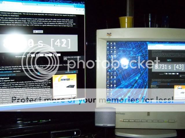

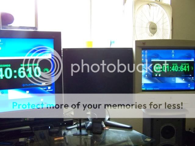

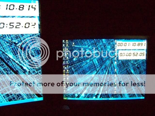

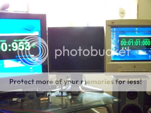

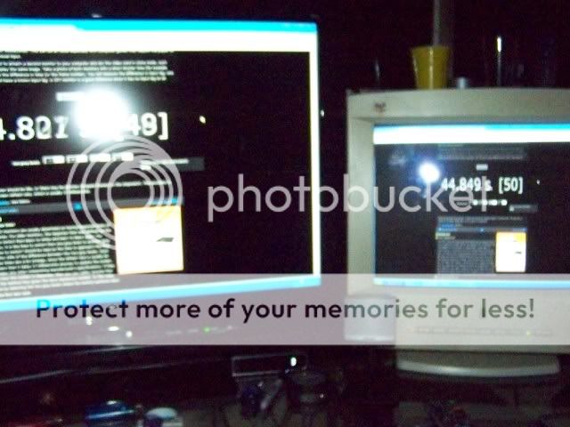

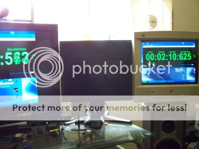

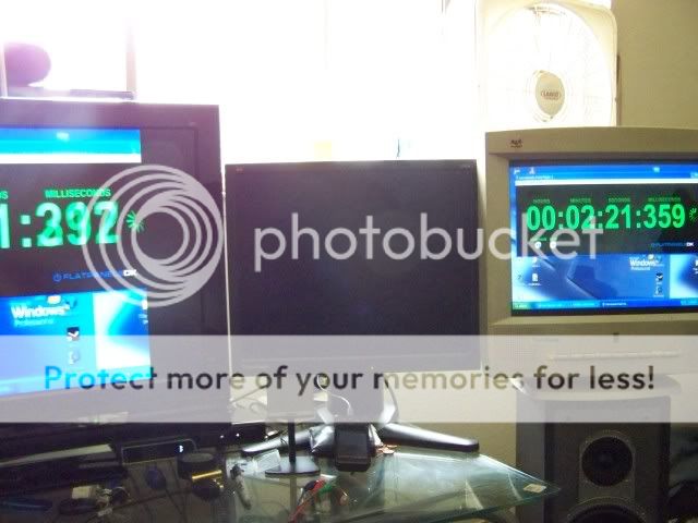

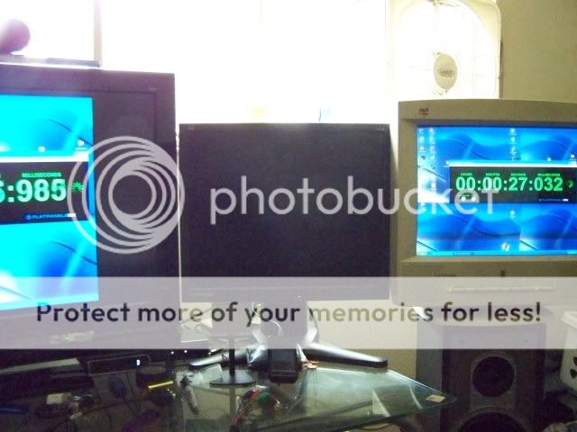

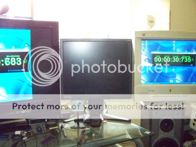

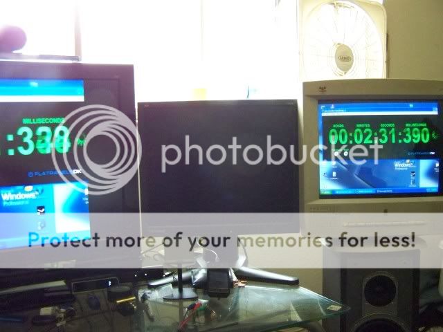

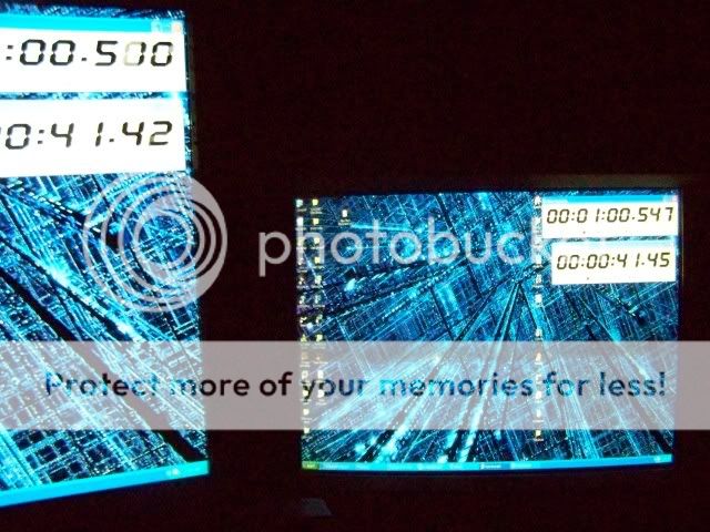

2nd round of tests on my 32xbr6
VGA @ 1280x1024 (couldn't get my video card to output anything higher on clone mode output with both displays being VGA, oddly I can get it to when tv is connected via HDMI though )
720P via Component in game mode
480i via Svideo in game mode
One thing i have found that is odd is i constantly keep coming up with 47ms lag on many inputs more than one time!!
another thing to note is that alot of shots its very hard to determine what the numbers read on my TV screen, I can often go with a higher number and get a better speed number or go with the lower number and get a higher lag number
a good example is my shots in VGA the first 2 photos could be read as either a 47ms lag or 32 ms lag and then the other 3 are 32,31,32 respectively
I will post my averages in the top post of the thread, and i will be using the HIGHEST lag numbers i could read to figure in the averages

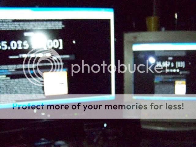

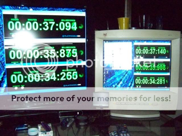

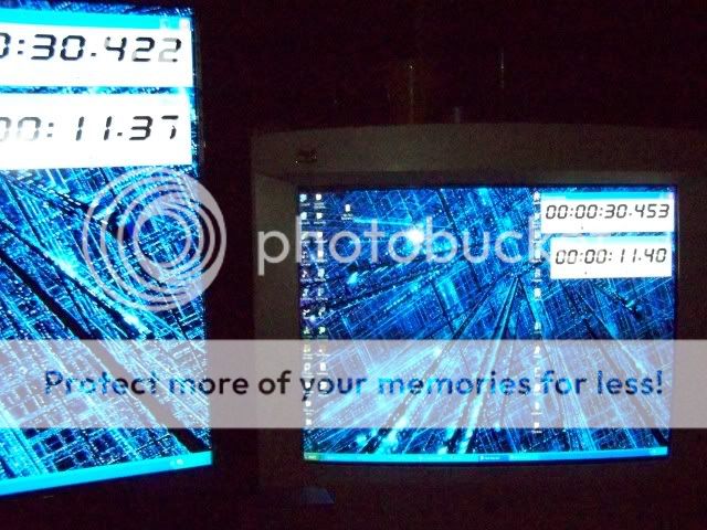

haha you guys ready for this, I just came up with a thought why not run multiple timers on my PC and see if they all jive results wise in each picture?
here are my figures running 3 timers at the same time for each picture
47
47
36lol
46
31 lol
26 rofl!
47
47
27 rofl
47
16 omgwtf!!
47
46
31 lol
47
the average of these figures is 39.2ms
compared to my previous average at this same mode in last test of just 5 readings that was 47ms!
and heres the pics
Clearly this method is flawed, though it does give you an idea of the input lag of a display a person can easily, by taking enough pictures, easily sway the figures of their sets lag by hand picking only images showing the best results, course i think we all knew that already
I think a better timer program that counts time in a linear fashion would be more accurate one that would count like this
001
002
003
004
005
etc.
I think that would provide more accurate and reliable readings.
next though i think i will see if i can find a timer app that maybe works more consistently than this one apparently does!
any ideas?
oh and that cursed 47 !!! i keep seeing it in my tests esp at HD resolutions without game mode on anyways up too late and getting silly here trying to figure out better ways to do this
47
47
36lol
46
31 lol
26 rofl!
47
47
27 rofl
47
16 omgwtf!!
47
46
31 lol
47

The problem with running multiple timers at once is that they're all vying for CPU attention. Think of it this way, all the timers ask the computer to update them every millisecond -- the CPU probably can't, considering it's got 3 timers to pay attention to, plus whatever stuff is running in the background, so maybe it skips one...
I guess what people should do when running these timers is increase the priority level to attempt to make the timers more consistent, though there's only so much you can do .
I wonder if we need to start listing computer specs with these tests as well .
Actually, here's an idea for a timer -- why not make a 60 fps video that just has a timer? Sort of like the videos at http://www.mediacollege.com/downloads/video/timecode/ but at 60 fps instead of 30... and you'd just have to make sure the media player isn't dropping any frames.

here is the first program from http://www.stopwatch-timer.com/
I ran 2 instances of it one set at 1000 sub second mode (milliseconds) and one at 0-60 per frame mode.
and here is the other web based timer program, this one is sort of neat because you can change the number and background colors to get easier to read numbers consistently
my dumb flash was gettin in the way some of the time on these and it was really late last night so i might re-do my test with this timer idk
but anyways both programs vary just like the app we have been using for awhile, give me a few min to figure out the results and ill edit this post with them
ok, here they are, the 2nd set I really need to re-do that timer seems to be the most consistant but i got some real blurry pics + the flash messing it all up so I will re-do them later but here are the results
Stopwatch App
MS F
31 3
74 3
16 1
47 3
16 3
http://www.lagom.nl/lcd-test/respons...ponse_time_gif
MS F
28 2
53 3
42 2 blurry - had to do some guessing
42 3 blurry - had to do some guessing
22 2
1-2 last photo flash obscured the millisecond reading and frame reading showed both numbers on tv lol

Setup:
Samsung 46A550 on DVI->HDMI, 15" CRT on VGA. Resolution set to 1080p.
Shutter speed set to 1/500th of a second.
For the following, Game mode refers to not naming the input, but using the "Game" entertainment mode. Normal mode is again not naming the input, and PC mode is the input named as "PC".
Game mode:
(Lagom timer) 3 / 2 / 2 frames
(stopwatch) 37ms / 31ms (couldn't read one image)
Normal mode:
(Lagom) 3 / 2 / 3 frames
(stopwatch) 37 / 47 / 47ms
PC mode:
(Lagom) 3 / 2 / 2
(stopwatch) oops forgot to run it
I don't want to clutter the thread up with pictures (I think it makes it hard to read), plus I'm too lazy to make links, so they're all viewable in this album.
I guess the bottom line is that the 550 has 2-3 frames of lag, which is in the ballpark of my previous tests...
I'm a bit confused about the stopwatch.com timer -- setting the refresh rate to 60 didn't seem to make it sync on refresh... I ended up just using 100Hz. Though that would seem to suggest that it's only accurate to 10ms... so confusing. I'm about to try making a 60 fps timecode video, maybe...
