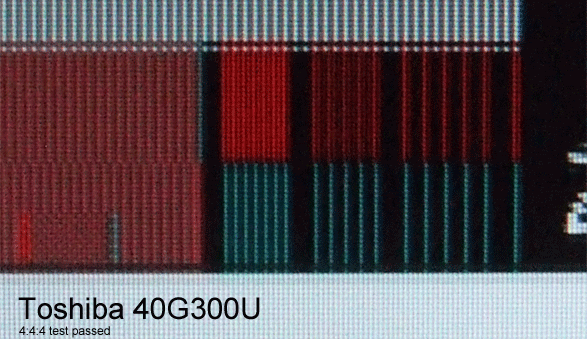

Toshiba 40G300U
Firmly in the grasping-at-straws phase, we turn to a Toshiba. 1080p60 was not synced so we got 1080i60. Game mode off: 104.1ms. Game mode on: 86.6ms. I should point out that when game mode was enabled, the TV stopped deinterlacing completely, giving instead a very flickery image. The point of this observation is to suggest that 86.6ms may be what you'd get with 1080p60, assuming the TV can accept that refresh rate.
These input lag results speak for themselves. The upside is that regardless of what mode one used, or what the pixel offset was, the image looked like this:
I think of this image as being what the Panasonic 42" TVs would look like if they passed 4:4:4 color. Maybe this is what Panasonic's 2009 models look like.

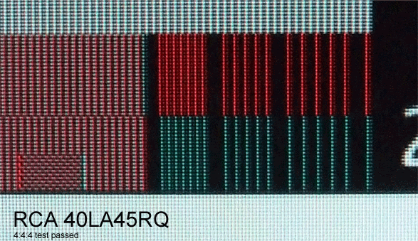

RCA 40LA45RQ
At the end of my rope, I tried out a 60Hz RCA (they had no 120Hz available). No game mode and very few actual menu options. Input lag was a respectable 28.7ms.
After a whole day with displays that refused to show me the video I was sending them, I was more than a little pleased to see:
No subsampling, very little pixel smear, and a decent input lag result. Make no mistake, I was laughing.
At the end of a quite long day, I'm find I'm shaking my head over how ludicrous it is that if you want to find a TV that gives back what you give to it, you have to find something old or cheap. Look at those images. How hard can it possibly be to just serve up a faithful rendition of the input?
