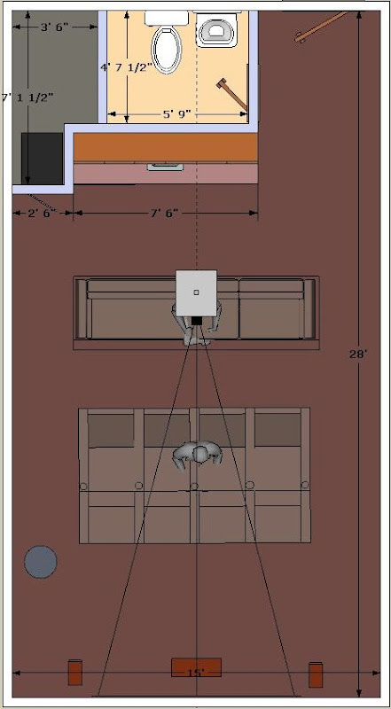

I'm looking at your proposed floor plan:
And I'm wondering about the way you have the snack bar consuming 3 feet of your room length. What is right outside the theater door and backing up to the bathroom fixture wall?
The reason I ask is if you like the idea of a third row sit at bar it would help to have that extra length. As is you could do short wall behind the second row seating and put an 8-10 inch top cap or drink ledge on for a "Standing Room Only" section in your space for the big games!

If you flip the bath and the equipment room you can do an equipment rack / projection room which is pretty sweet from a noise floor perspective. Watch the throw ratios though, as it might be a bit on the long end.
Could also open up an easy install for communicating doors/airlock if you are really trying to boost the sound isolation. Often a tough sell though. Might be easier if it is a "lobby/projection room". Maybe really shrink the bathroom by getting on of those toilet sink combos:
Just thinking out loud. Nice big space.

BIGmouthinDC & dc_pilgrim: thanks for your feedback on the floor plan, those are some interesting ideas. I'm definitely not beholden to the layout of the snack and equipment areas as shown in my drawing. I'm particularly intrigued by the idea of maybe allowing for a third row of "bar seating" back there. BIGmouthinDC, in answer to your question: the bathoom/sink are indeed pre-plumbed, but the drawing is a little out of date; the plumbing is actually not along the back wall, but at the approx. location of the planned "opposite" bathroom wall (i.e. same area as the "back wall" of planned snack area). Of course, the plumbing could probably be moved if necessary. I'll take some photos of that end of the room and post them here.

OK, here's a couple updated SketchUp shots reflecting the "actual" location of the pre-plumbing:
