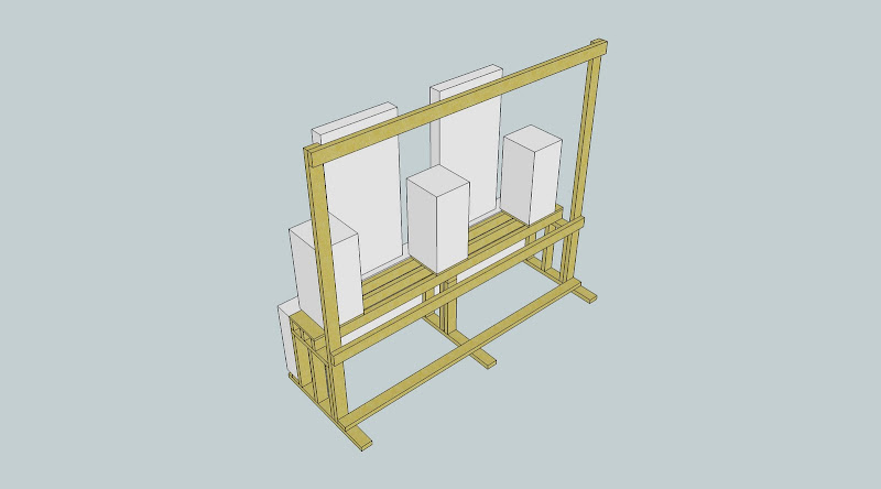

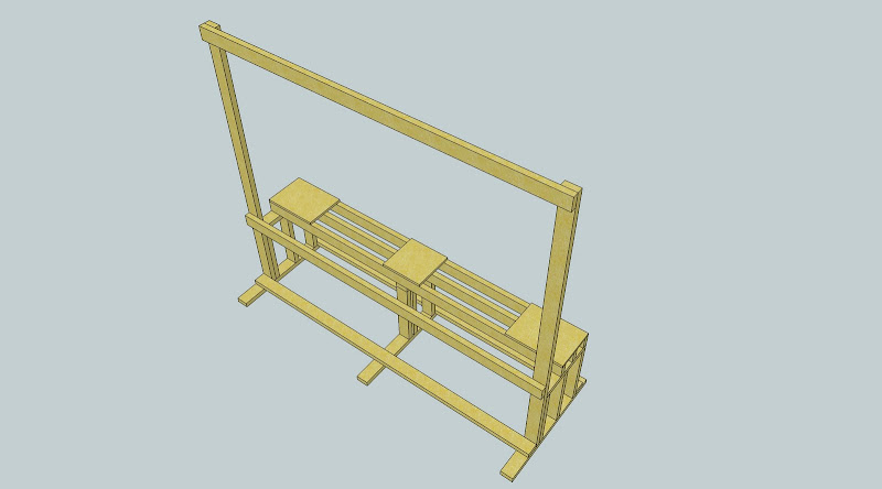

post #77 of 91
I have a day off so I am going to try to build a stand for my speakers and new AT screen.
Here are the plans:
And here is a mock up with speakers and acoustic panels:

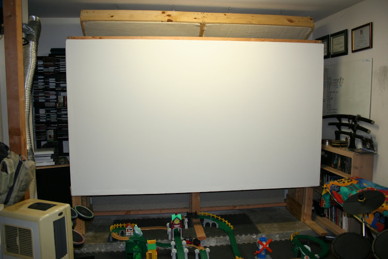

post #79 of 91
New front stage.
Here it is with the screen installed.
post #80 of 91
I agree with everyones comments, you have done a great job. How did you attach the screen material to the framing? How far are sitting from the AT screen? Any problem seeing the weave?
post #81 of 91
The screen is attached to the frame with industrial strength Velcro. Getting it tight was difficult. I would probably go with screen tight or grommets and o rings if I were to do it again.
I sit about 9 feet from the screen. If I am looking for the texture I can find it when there is a very uniform light color on the screen, but even then it is not at all distracting.

post #83 of 91
New picture of the screen. I ditched the Velcro and reattached it onto my 80/20 frame with grommets and o-rings. It turned out great. It is much tighter than before.

post #85 of 91
I added speaker grill cloth as black backing for my screen. It took care of the reflections I was getting off of the metal grills of the Triple 8s. I could not be happier with the sound and video quality at this point.
