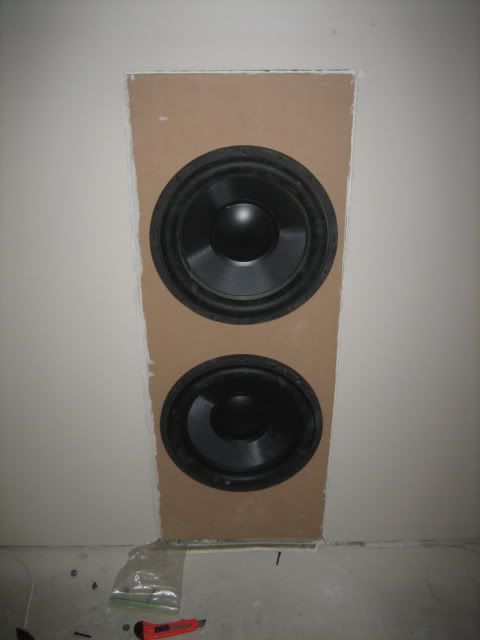

I was a little tired of the lack of progress in the actual theater room, as most of the work has been elsewhere in the basement. So I mounted the subwoofer and front speakers!
Here are the Pics, as requested
The dual SDX-15 subwoofers!

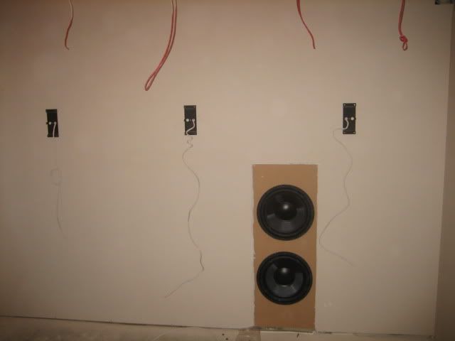

Mounting brackets for the paradigm esprit's
The paradigm esprit speakers
I chose the esprit because I wanted to use the paradigm studio dipolar surround speakers and wanted a front speaker that could be easily hidden behind my screen without requiring the false wall be too far out into the room.
The bracket system to hold the speaker to the wall seems quite clever and sturdy. you can have -5,0,7,or 14 degrees of tow-in, and there is a hole designed to keep the speaker cable hidden behind. They only sell them as pairs, or as a center that has a horizontal tweeter. I wanted all of my speakers up front to be exactly the same so I rotated the tweeter/midrange holder 90 degrees, to allow me to vertically mount it like the others. Now to find a way to get some power to them!

That is looking S W E E T!!!!!!! Now on to "see" what they sound like.

Those should sound awesome Greg. Nothing beats a matched set! Are they thin enough to just hang the screen over, or do you still have to do a false wall?
CD
post #47 of 243
I'll still have to do a false wall, though it will only be about 7 or 8 inches deep. Really, I could probably get by with just some thick panels. The other option would be to simply have the screen out 8 inches, hiding the speakers and having black cloth against the wall. I have 36 inches from the true wall where the ceiling, side walls, and back wall will be black fabric. This 'black hole' will be where the screen mounts, so instead of curving the black panels (which sounds hard), my screen will sort of float in this area.
Now you have me thinking CD, why don't I just do panels up front to cover the OC703 that will be going there, say 2 inches deep, or maybe make it with 2x4 to allow for the screen supports. Then just hang the screen 6 inches out from there. Well, I have at least 10 days to think about it. The rest of theater woodwork and acoustic panels go in on the 13th.
