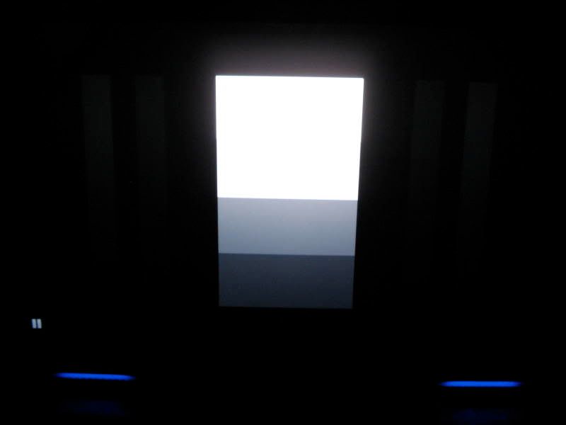

This is my third DLP and I've never had any problem like this before. It's like somebody has a flashlight behind the black bars and is shining it through. It moves, depending on how bright the picture is below the bar. For instance, if a guy is standing in the picture with dark hair and he's standing in front of a white background, the bar will be almost gray (halfway up the bar), then be black above the guy's head, then go back to gray. But it's not a solid gray, it's uneven. I'll try and snap a pic.
post #5 of 12
Here are a couple of photos. It was hard to actually capture it, but you can see it.
You may have to tilt your monitor to see it, but you can see how in the black bars on either side of the tower the bars are gray, and black above the darker tower. Like I said before, it moves constantly depending on what's happening in the picture. It's VERY distracting and VERY annoying. I have a service tech coming out next week to check it out. I just got it two days ago, but it's the only one left anywhere near me, so I don't have many options. I'm hoping it's something "simple" like a light engine. I know that's a major part, but it's simple in terms of they order a new one and come out and install it.

Just to follow up . . . I had a Geek Squad tech come out () and, upon showing him my problem, was given a brief description of how exactly DLP works and its drawbacks . . . which I already know. He failed to comprehend that this is my third DLP, and neither of the previous models exhibited any problems even nearly similar to this one. I popped in my Dark Knight disc, since the issue is very evident during the WB logo sequence, to show him exactly what I was talking about, and was then told that "I don't know why they didn't make the Blu-ray spec to be all 16:9." At this point, it was pretty obvious what I was dealing with. The guy went outside and called Mitsubishi (allegedly) and was "told" that this was "within the manufacturer's specifications." Since he came in and basically professed what an "expert" he was on DLP technology, I have my doubts that he even talked to someone at Mitsubishi, but that's just a feeling. Anyway, here's another picture I took that demonstrates the issue much better than the previous two. My next step is calling Mitsubishi tomorrow and getting an independent service agent to come out and check it out.
No, that "haze" above the white block is not because of the camera. That's what it looks like.
