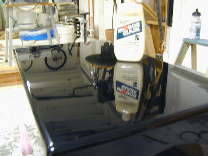

the password is high build primer.
this guy did a fantastic black piano finish over mdf.
http://www.htguide.com/forum/showthr...0&page=1&pp=35
