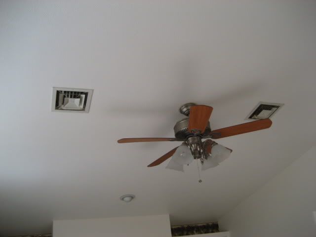

I am going to start building a theatre in the house that I am purchasing, due to close on it next month. I am looking for some ideas. This will be my first theatre build. I will be doing most if not all of the work with my brother in law. I will have a budget of $10-12k to complete everything needed (projector, screen, paint, seats, riser, scounces, sound/wall treatment etc). I have speakers and AVR already, so that will not need to be budgeted.
With that said, here are some pictures.
Some questions that will need to be decided. Do I rip out the fireplace? If I do, that will give me another 2' to work with. I am not sure if I should build a stage. I am really unclear when it comes to sound treatment. I will double drywall, but after that, not sure if I need panels, etc. What about the door and window leading to the back yard, do I wall that up? If so, that would be an expensive project, taking a pretty big chuck of my budget.
A good thing about this room is that the house has 2 AC units. This room and another room measuring about 100 sqft are the only rooms sharing this unit.
What would you guys do with this room?
Thanks in advance

I also wanted to talk about projector placement. I have no idea how/where I would mount the thing. The walls start to slope from the very beginning. I said in my drawing that it vaults to 9 feet, but it may be 10' or even 11' up there. How will the triangle shaped ceiling affect the sound? Also, there is no flat surface to mount from. Is mounting at an angle a big issue?
