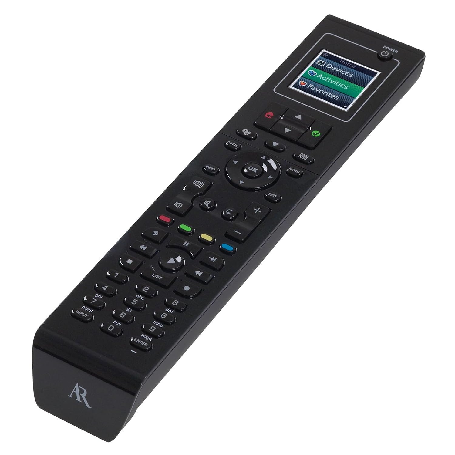

I just picked up a used ARRX12G Xsight Plus. It's a 12 device version of the touch, but is much smaller. It has only 3 functions per screen which you cursor up or down to use. It's non-rechargeable like the color and has backlit keys triggered by a tilt sensor. All the keys are dome keys with a nice soft click. It's also learning and uses the same website for config as the other models. It's hard to tell from the pic, but the lower half is glossy, the upper half is brushed and the back is rubbery for good grip.
One thing I noticed immediately is that unlike harmony, you can manage multiple remotes with a single login. It detects which remote config to use when you plug it in. Also unlike harmony, you can rename and rearrange all activities and devices. All the functionality is essentially the same as the Touch, except favorites which is limited to a single list of 24 and no icons.
It's a powerful little remote for the current street price of $22-$33. Mine's a $13 refurb but it's in pretty bad shape, so I wouldn't recommend an ebay "refurb" to anyone else.
Here's a pic:
