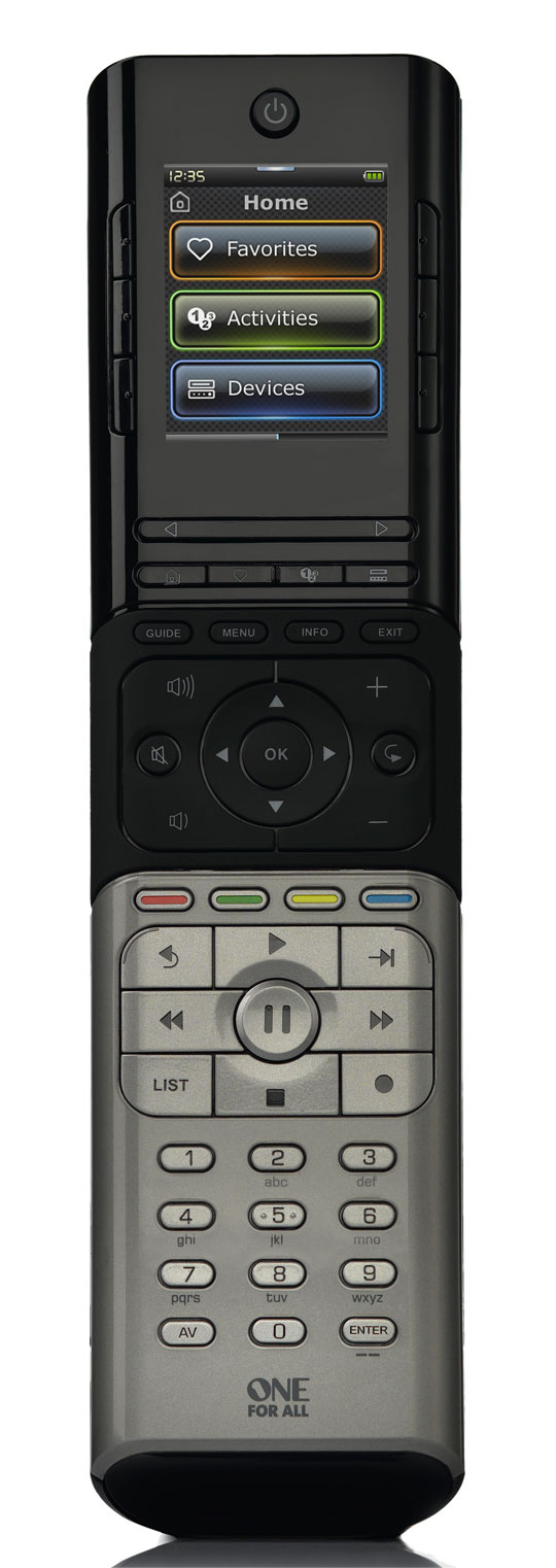

post #102 of 672
Here's a good pic showing LIST:
The xsight database usually has all the discretes you need. If not, the only way to add them is to learn them from another remote. Discretes can usually be easily programmed into a cheap one-for-all ($10-$20) using advanced codes and used to teach the xsight. I do this with my harmony all the time.

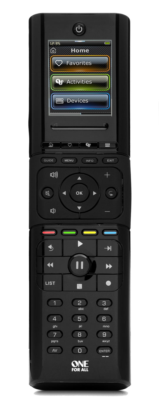

post #104 of 672
Awesome. thanks for the quick feedback you guys.
Here is the large picture of the non-touch version:
http://www.discoworld.dk/shop/images...ht_color_b.jpg
Having the color buttons and the LIST button will make life much easier when the wife is piloting.
