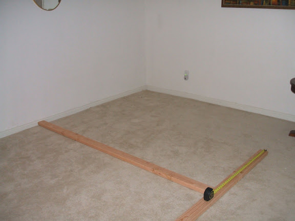

Here's what the area looked like before.

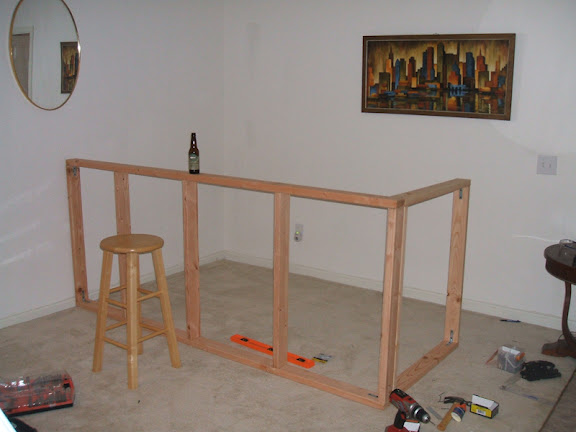

I wasn't sure exactly where I was going to put the bar until I started laying out the 2x4.
And so the framing begins.
As you will notice the space gets messier as I progress.
The support for the counter.
The base of the bar top. Notice I added more studs in the frame. Learning the hard way.

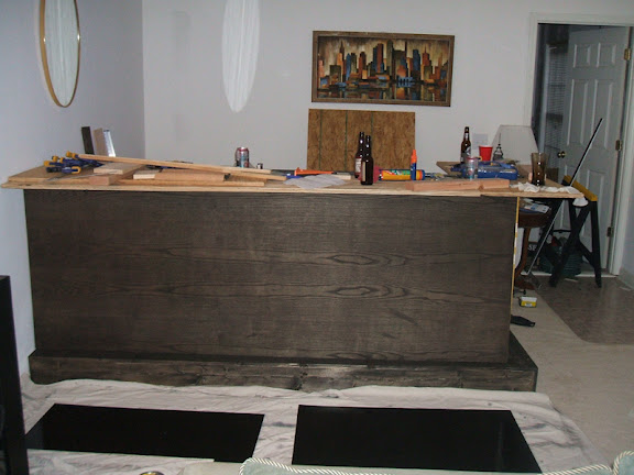

Skinning the bar front.

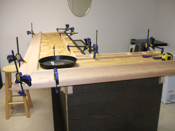

Testing out the bar railing.
Here's the bar top as I originally planned.
I had the bar top stained and ready to be permanently fixed. Then I decided I didn't like the plywood I got. I think I sanded it down too far and it had places where you could see the "wood" under the oak. So I scrapped that idea and decided to install oak flooring on the top.
