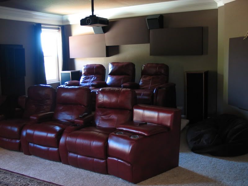

RMK what material did you use for your acustical panels in the back? They look nice. Did you make them yourself?
post #292 of 8265
Thanks, they are GIK Acoustics 244 Bass Traps. They are reasonable in price and the construction is OK. They have lots of color,fabric, trim options these days.
