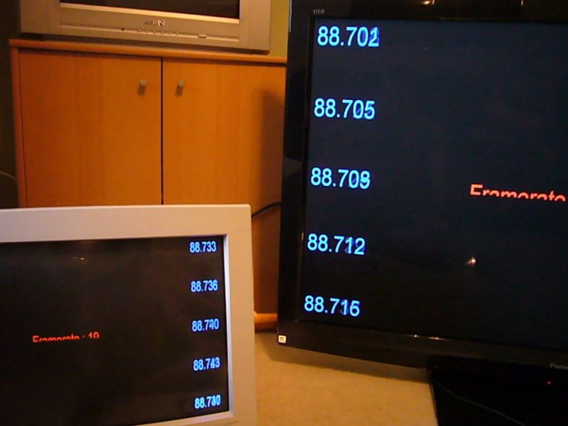

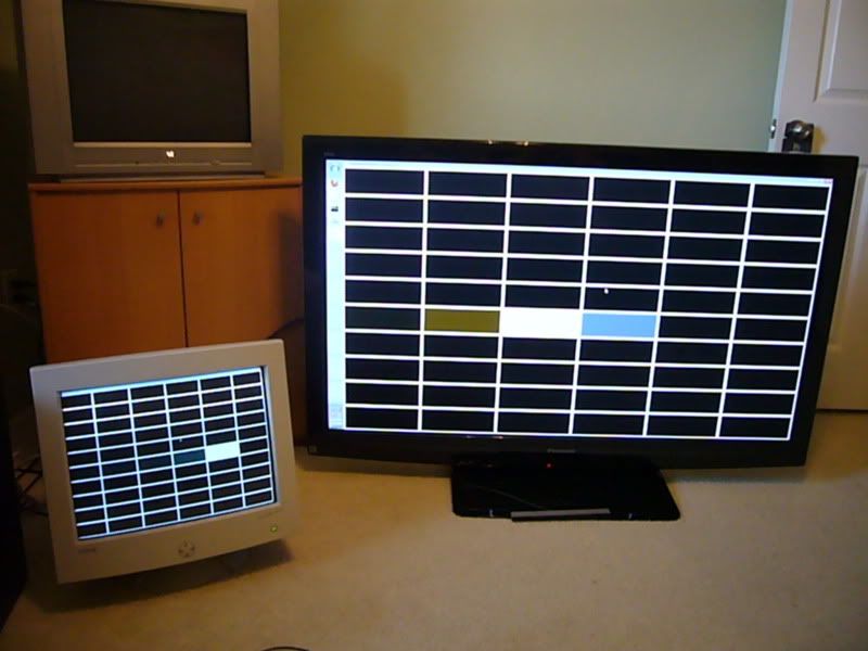

The other night I tested my 54G25 off a PC using SMTT and RefreshRateMultiTool.
tl;dr: At 1080p most tests showed 31ms or 2 frames, with a few results of 16ms or 1 frame. RB2 tests on Wii gave me 23ms audio lag and between 16 and 32ms video lag.
I cloned my PC to a CRT monitor and the plasma: my video card is a Radeon HD 5770 with the signal cloned; DVI->VGA to the CRT and HDMI to the Panny, both set to 1920x1080 output. Take these with a small grain of salt, as I'm not convinced the cloning's perfectly in sync. I would have preferred to do the 60fps test but my camera only does video at 30fps.
One thing to note is that the blue phosphors react much faster than the red and greens, which is why I did blue numbers on black for SMTT and why you'll see blue, white and yellow frames on RRMT.
Ignore the flashlight, that was my ghetto way of decreasing the shutter speed on my camera :P
Oh and FWIW I did the RB2 test with RB2 Wii (480p) a few times:
Audio Lag = 23ms
Video Lag = Between 16 and 32 ms, which fits with the results below:

Orta - Note that my set is a G25, not a G20. You might also want to include sizes in the OP so we can track if there are any variances based on size.
Phasemaster - The tests themselves definitely have something to do with it, but I'm definitely not qualified to say if lag is variable within a set. I don't think lag is a static figure like say pixel response time or refresh rate.
My RB2 tests were manual calibrations - alone they're only good for a very general idea bordering on subjective "it feels" anecdotes (it felt lageless to me BTW ). The stopwatches are better but still not quite perfect. Even the shoryuken.com 60fps test, accepted as the most accurate method among fighting game players, produces at least two results (e.g. 1-2 frames).

I'm not familiar with that test you're using shad, is the white square advancing 1 block per frame? The multi-colored phosphor tailing on the PDP also seems to be making it even harder to read, do you ignore the blue/yellow trails and just count to the solid whites? Were you not able to get a stopwatch timer to show up?
post #71 of 654
Yeah, the program turns one block white for every frame of the display. It sequences left to right then goes down a row. So it flashes 60 blocks per second in sequence when displays are set to 60hz. So 16.67ms per block.
So on hdmi pictures it seems to be 2-3 so ~50ms? And almost always 2 blocks behind on vga so 33ms
This is faster than what I measured before with the stopwatch, I was getting 80 or so on hdmi and 40 on vga.
And I am skeptical that the difference in the VGA and the HDMI is that little. I notice a large change in mouse responsiveness between the two inputs.
What is that timer software that shows multiple clocks up and down the screen?
post #72 of 654
The multi-stopwatch is Small Monitor Test Tool, or SMTT. I got it from frito, pm me and I'll send you a copy.
Orta - The "blocks" test I linked to in my G25 post is RefreshRate MultiTool, or RRMT. It runs at 60fps and draws one full block per frame, so you count the difference between the CRT and HDTV.
In the case of plasmas the blue phosphors react quicker and the red/green decay slower, so we see in some photos a sequence of blue-white-yellow, where the input's been received and the phosphors are starting to react but the images in the previous frames haven't yet decayed. I counted the difference starting with the blue frames if they were there.
shaddix, your tv has about 3-4 frames of lag in both modes. 0 frames of lag would be if both blocks were white (or blue/white) at the same time. Most of the time the difference two black blocks between where the plasma is and where the CRT is, meaning 3 frames.
