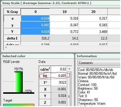

I got a new 65S1. With 4 hours of usage, the black level was measured at 0.005 ftL with an i1LT. That's right in line with what D-nice said about 58 and 65" panels. I will not run the break-in slides this time. Will check the number time to time. My 400 hrs old 54S1 has been at 0.014 ftL since about 200 hrs old when I got the meter. I'm guessing it started at sub 0.010 level too. I do find it interesting that the severe black/IR problem seems relatively infrequent among s1 owners.
I own an S1, and I THINK I have have the issue. I don't have any measuring equipment, so I can't rule out the possibility that this is in my head. I'm not going to lie that maybe this is in my head. It seems like I'm the only one with an S1 who has this problem. It seems to be much more prevalent with the G10 models, and maybe the V10. The G10 models seem to have the most problems overall.
