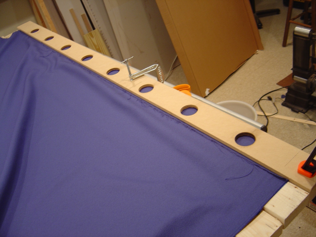

It curtains for me! With my recent acquisition of 25 yards of GoM and a few days of time it is now time to make curtains.

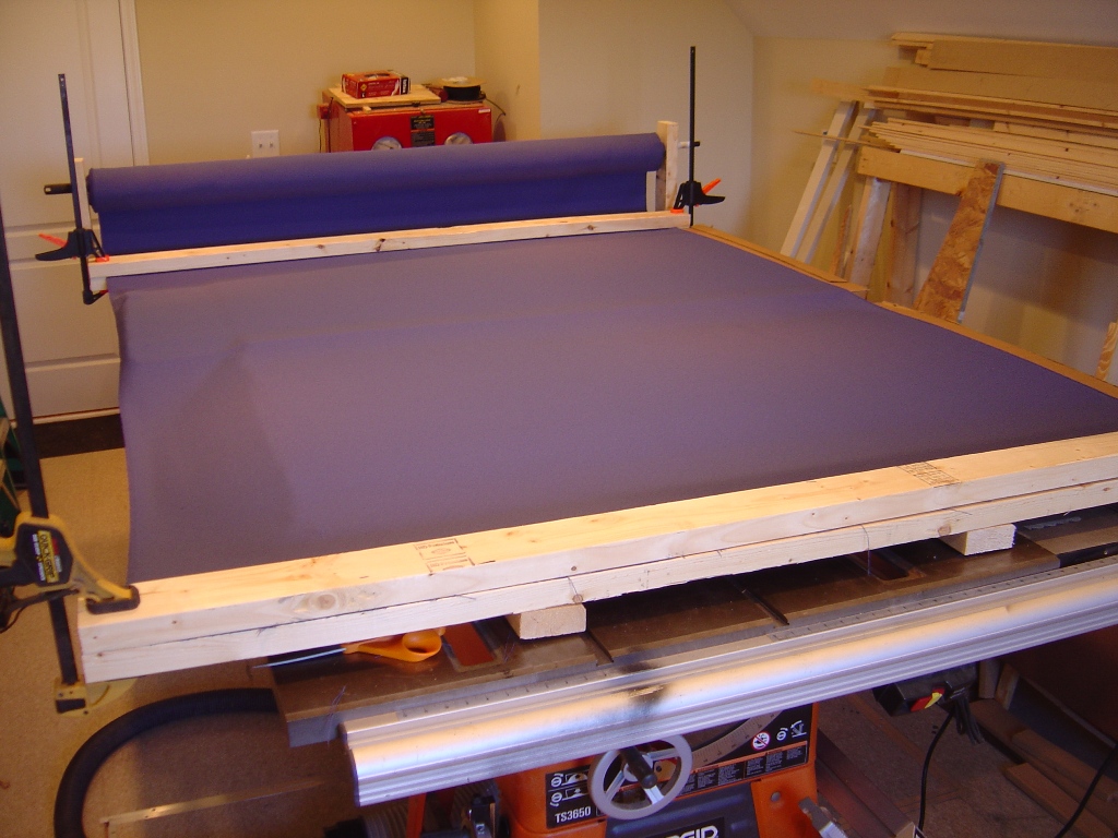

25 yards of fabric is unwieldy at best so I made a cutting fixture to hold the roll.
The fabric is unrolled over the wood cross bars. There are marks so I don't have to measure each piece.
Here is a curtain pulled out and locked into place to be cut.

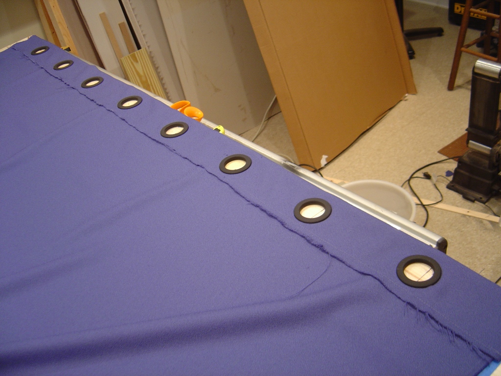

We folded over the top 4 inches and sewed it in place. I made a hole fixture to mark the holes for the grommets.
Here are the holes cut. This is actually the most difficult part since both layers have to be cut perfectly for the grommets to work.
And here are the grommets snapped in.

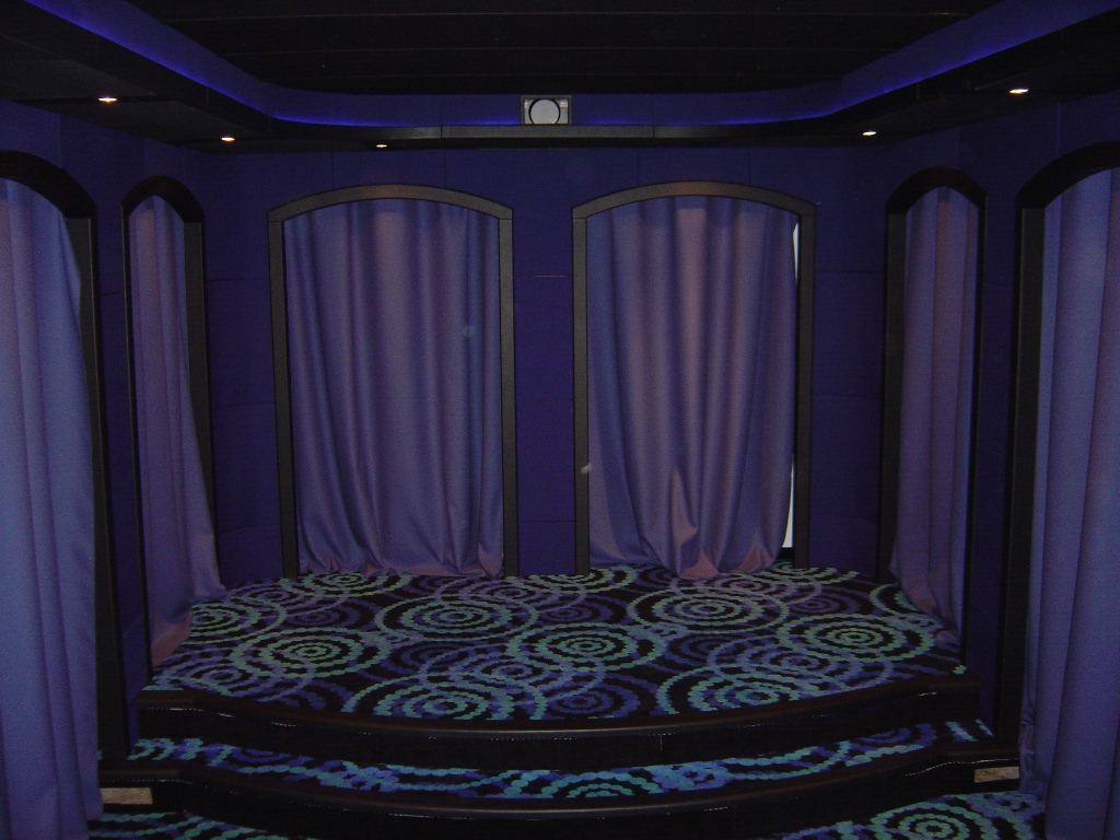

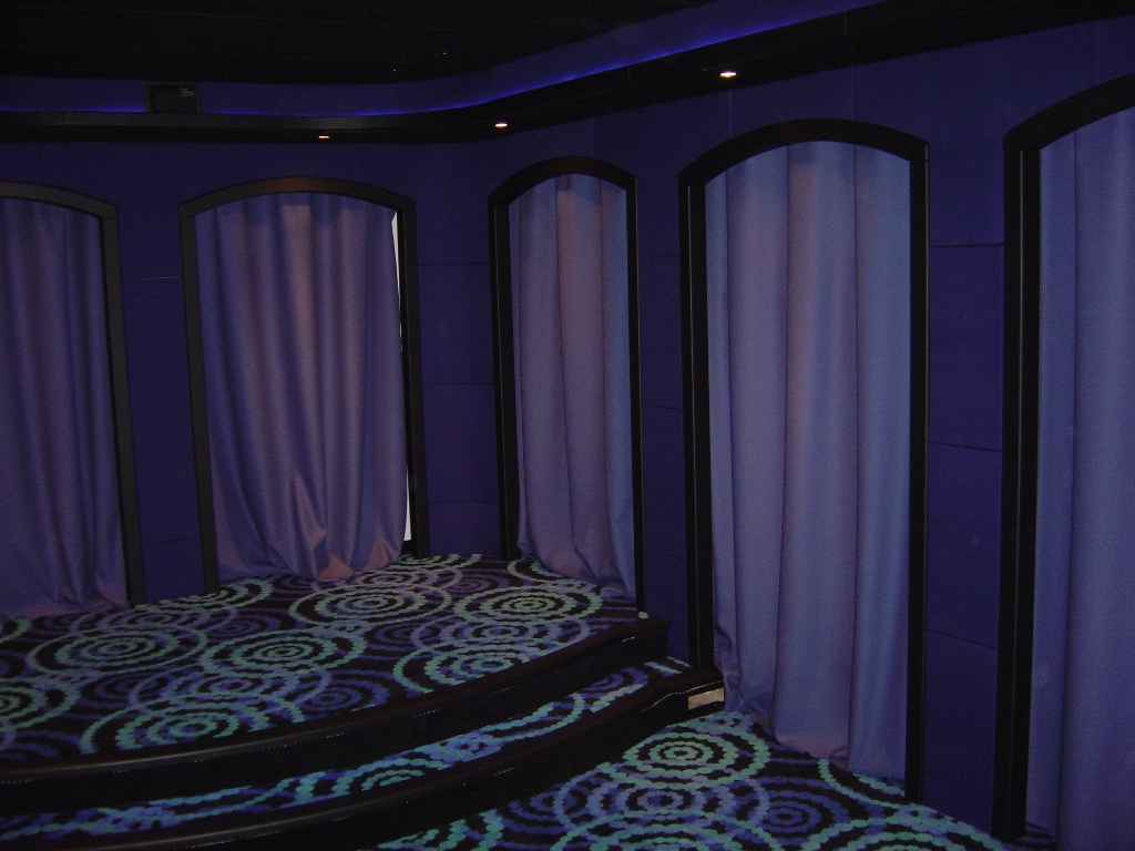

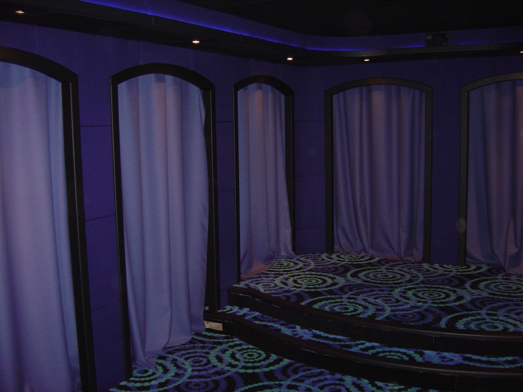

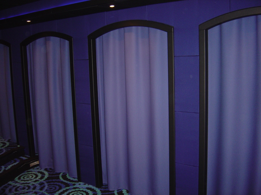

Here are the curtains hung on their rods. They still need to be hemmed.
The curtain on the left has been hemmed, the one on the right has not been hemmed yet.

Do you have any details how you built the fabric cutting rack? I have 40 yards of GOM I need to cut in the next few weeks, but have been trying to decide how I am going to go about doing it.
post #375 of 612
It's nothing more that a few 2x4s screw together and cardboard in the middle. I'll take some more pics of it before I take it apart.

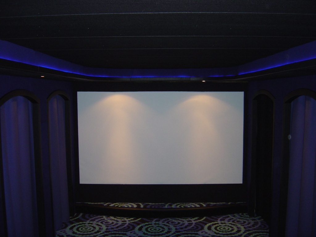

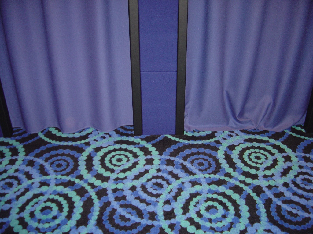

Well, after the long Christmas break I have gotten a few things done!
We finally hemmed the all the curtains.
I had to make a notch on the edge of the curtain that is beside the step so it would not bunch up.
I'm quiet pleased with the outcome. I still need to make the mechanized track for the curtain that will be mounted over the entry door though.
