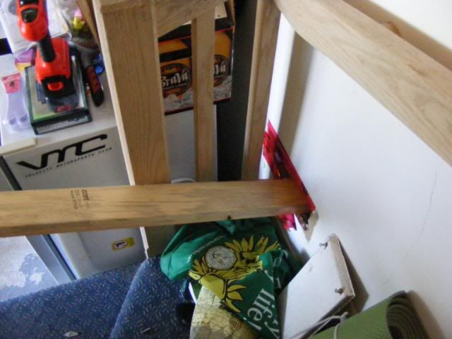

FYI that AutoClamp thing works pretty good for clamping headers in place when doing framing by yourself. Would not pay full price for it (what else is new) but for $10 it was a steal.

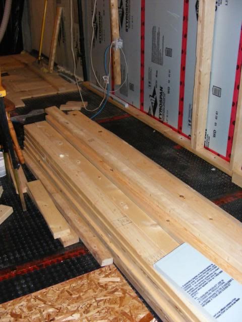

Ok, a little more progress! I am nearly out of supplies, down to about 5 2x4's (and about 45 little 6 in 2x4's my son has made in to "highways" for his toy trucks).
Framed most of the exterior of the HT area, I need to finalize my plan for the bathroom and around the furnace.
Next step is to get more 1.5" Rigid Foam sheet and insulate the rest of the basement. At the same time I will get in more 2x's and OSB for the floor.
Ran into an issue with drainage, I had a spill from the dehumidifer and it pooled on top of the Platon floor where the drain underneath is! I drilled some small holes to allow it to drain through but it begs the question, what happens if I get a bathroom or laundry over flow?? Should I drill or cut out the drain area? It seems kind of counter active.

A drain has a trap. The trap needs to stay full of water or you will get sewer gases. A covered drain is not a good idea.
post #44 of 177
mjg100 -I had heard of the nail and wire method before, I just never seemed to think it would work as well. I also liked the idea of being able to remove the tapcons if needed.
The floor is dimpled and allows air movement and water to drain into it. Any suggestions on how to make my setup better?
I also installed a anti- back up plug before putting down the platon flooring.

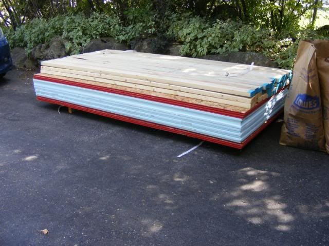

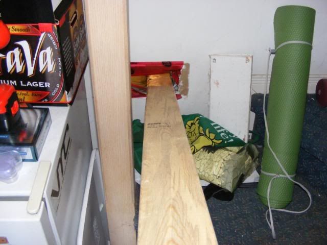

Soooooo tired and hurt, this showed up this morning.............
and me and pops and Jr. made quick work of the 2x's by utilizing the ol' hole in the wall.
It took 8 mins to move 40 2x's from the drive way into the basement (including a 2 year olds "help")

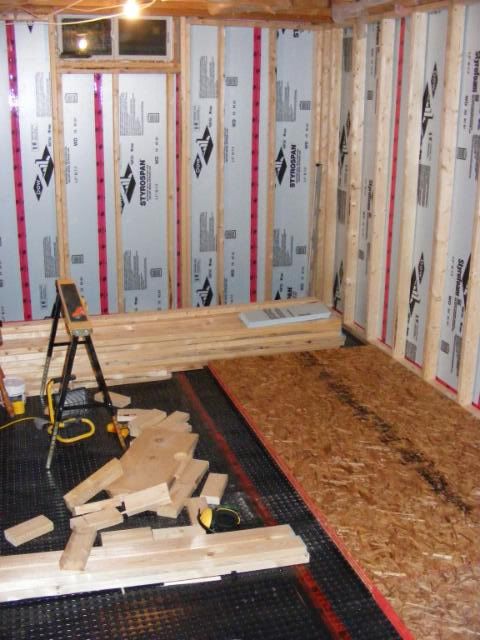

Got everything moved down to the basement, my back is thanking me for cheaping out and getting 5/8" OSB not 3/4". Those puppies weigh a ton!
Got some foam up on the wall and a little bit of framing done. Replaced a faulty vent that would not close.

What's the combined thickness of your subfloor (Platon + OSB)? I'm going to be doing exactly the same thing, but wanted to figure out how much height I am going to lose in the process...
B
post #48 of 177
Platon is 1/4" so total is 7/8". I have been putting 2x4's flat on the platon to judge the final clearances and heights (1.5" + 0.25" = platon +OSB+ flooring + drywall on the ceiling).

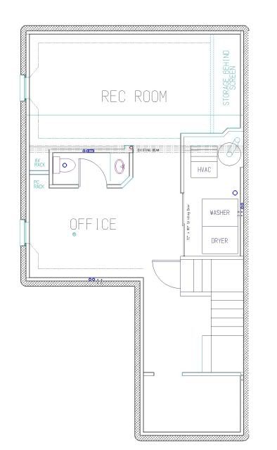

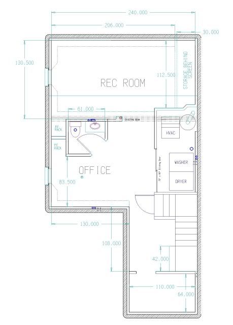

New layout concepts
I like this narrow bathroom one but I need to figure out the dimensions, I may need to go with a pocket door. Anyone have a bathroom like this one they can measure for me?
